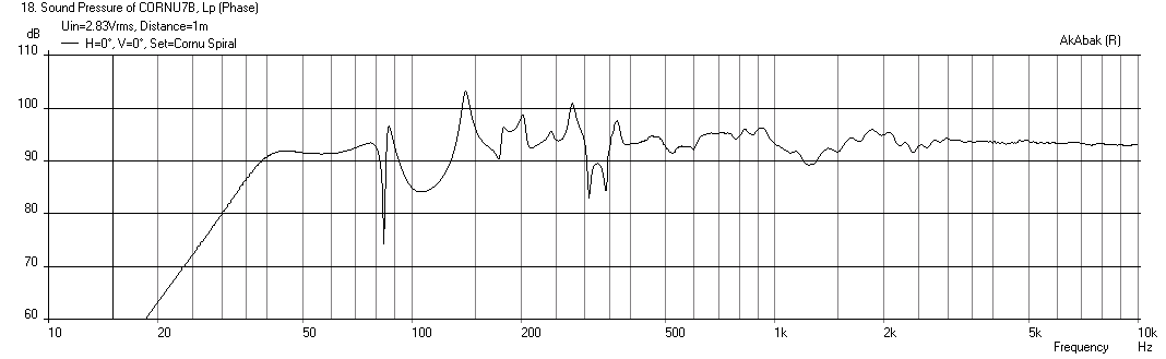

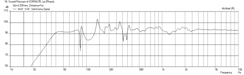

That is a nice driver. Let me run a sim but I think Cal is on the right track and it may be a 4 ft Cornu to make this work. A sheet of sure ply 4x8 will have enough for two faces or 1 monster Cornu. It will take a lot of FC to make the channels.
Cal was pretty close, a 44 in x 6 in deep Cornu will work well with the FF165WK. You get solid 37 Hz extension (-3dB) and about 91 dB sensitivity.
430037d1406340123-ever-think-building-cornu-spiral-horn-now-you-can-cornu-7a-ff165wk-freq-1m.png
Go for it!

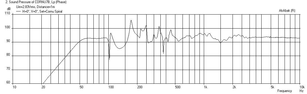

A 36 in x 5 in deep Cornu will work with FF165WK and get 47 Hz (-3dB). That will sound pretty good for most music.

As for the sim i'd say it doesn't look that bass heavy, doesn't it?
my alternatives would be:
the alpair 10.3 which looks more bassy to me then the 165WK
the FE166EN which looks really nice in the sim, but i'm afraid it'll lack bass like the FE103EN and has a small xmax...
any advice? :confused: or perhaps there's some other driver i missed which would work really well in a 36inch cornu?
