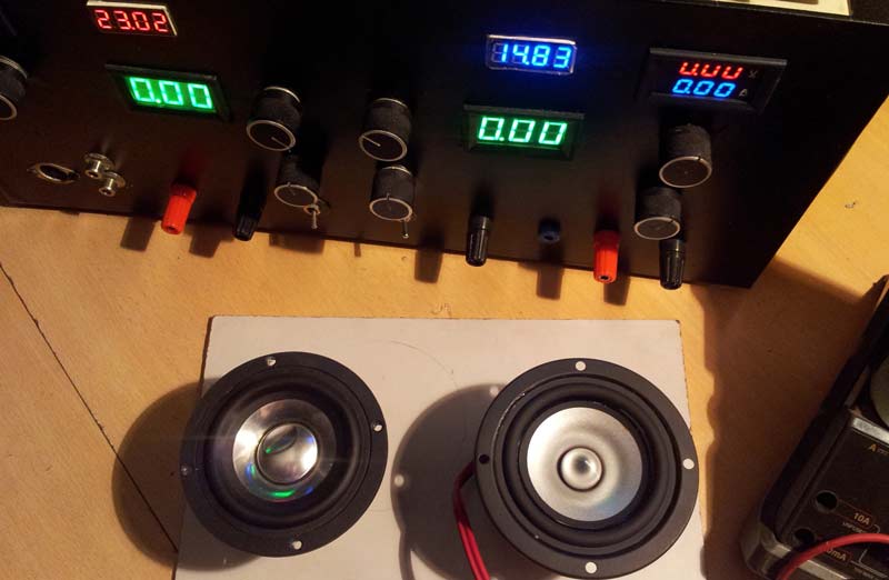

I already have some pairs of Fountek 88 3” and Tang Band 871S. They both sound nice, but…which one would be better for the Cornu?
I’m thinking about scaling the PDF to a 19” box with 2.6” channel deep. Is that ok?
Thanks.

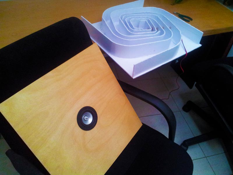

Mini cornu
Almost done. All that remains is to attach the face to the spiral. The face is 4 mm plywood and the spirals are foam core.
Driver is Tang Band 871S, an old model that was popular a few years ago and I still have a few of them unused.
I'm still deciding on the glue to fix the face to the core baffle, because only the face is wood and the rest is foam core. Would white carpenter's glue enought? Or perhaps silicone sealant would be better? Which one would give better sealing for the spiral channels? Not a clue on this choice.This is my first foam core project! Any suggestions? Thanks.
