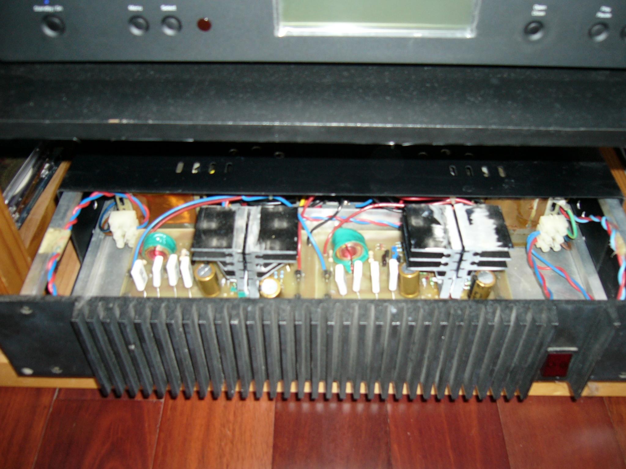

I managed to acquire an original mint condition series 5000 (eti477) power amp. in remarkable condition. Was being used regularly and performing very well.
A quick look over before connecting speakers and noticed DC voltage on the speaker terminals. About 80mV on each (in the negative)
I ran my meter over the powered up circuit and all voltages measured pretty well spot on with the voltages noted on the schematic.
There were two different sorts of BC550 (different manufacturers) on each board, so I replaced all 3 on each board with new ones that I had and matched them to withing 2 hfe of each other ( hfe = 430 )
This brought the offset voltage down to about 50mV on each channel.
Ok but not great.
Warming Q1 up wit
h my finger sees the voltage drop down.
Warming Q2 up sees the voltage rise.
These two transistors are too far apart to thermally bond them for stability.
Is it possible that the BF's could be causing this ?
Any advice from the gurus here ?

Opportunity to introduce some mods. Look at the asc of my version of eti477.
Add large heatsinks to VAS transistors. PCB under these probably is already brittle, possibly disintegrating. Adding a 18V zener will reduce their temperature. BFs are not the best here but in those times there was not much choice. Alternatives to 2sa/2sc I used are ksa1142/ksc2682. These are more robust than BFs.
Use non-inductive source resistors with mosfets, increase gate resistors and use there Dale/Vishay RN65s. These have low inductance. Laterals love to oscillate. Replace ceramics with silver micas, especially these mosfet 470pFs. Replace electrolytic caps, these probably are already almost cooked.
Add 2k trimpot between LTP emitter resistors. Enough space on the pcb. That will allow you bring offset to below 1mV.
You may separate PS to output mosfets and VAS with diodes or 10 ohm/2-5W resistors. In zoebel use 100nF/400-630V polypropylene and non-inductive 10ohm resistor.
