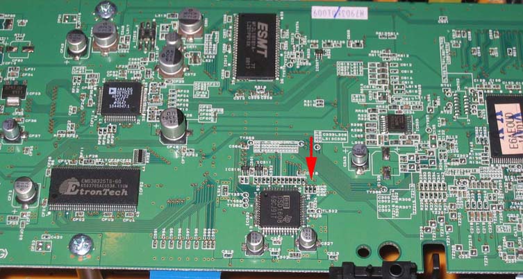

Denon DVD-1930CI is similar to the 1920
khundude said:
Does anyone know what difference is with the Denon DVD-1920, 1930, and 1940 are and if the boards are different?
Greetings,
The Denon dvd-1930CI matches the photos of the 1920 posted by Russ in almost every way. On this photo of the digital board, the region Russ modified is indicated by the arrow.

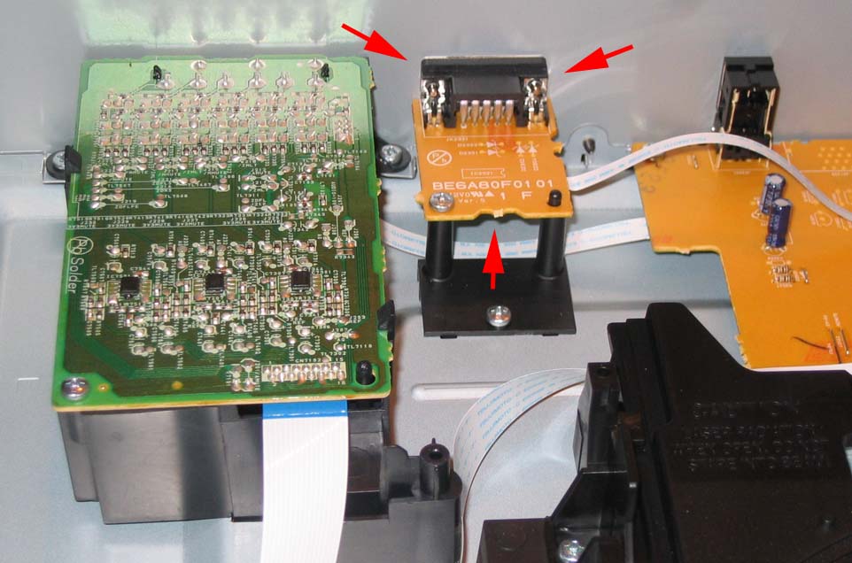

Joined 2007
The one obvious difference is that the 1930 has an RS232 port while the 1920does not. It's connections originate in the region of the HDMI plug but I haven't investigated further. The manual describes no function for this port - it only mentions something lame about 'future compatability'. I bet they weren't planning for it to be hijacked by DIYers! :D
BTW, those vias with the DSD are both small diameter and closely spaced. :xeye:
Frank in Mpls.
