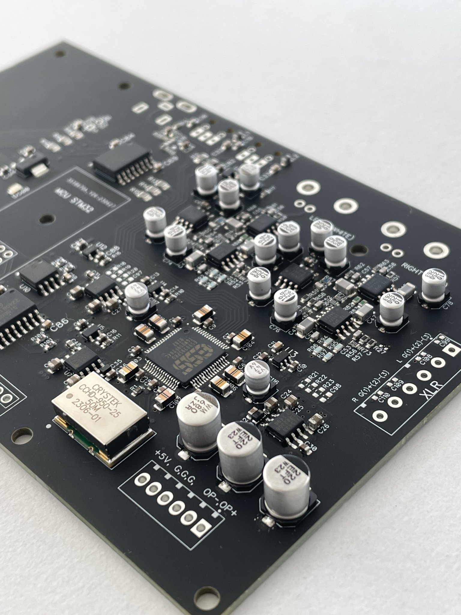

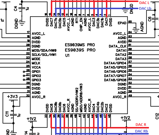

Hello all,
Has anyone tried and have succes with the 9039pro?

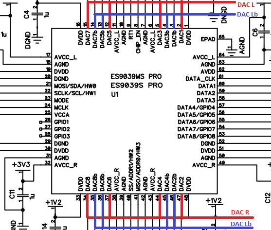

here is my try..no succes and dead silence at the output. It is a stereo dac, so output 1.3.5 and 7 are tied togheter as one channel, the other as the second channel.
Use a STM32 and I2C and it looks ok. MCU find dac chip and identify it as a 9039pro. Also lock/no lock works as expected.

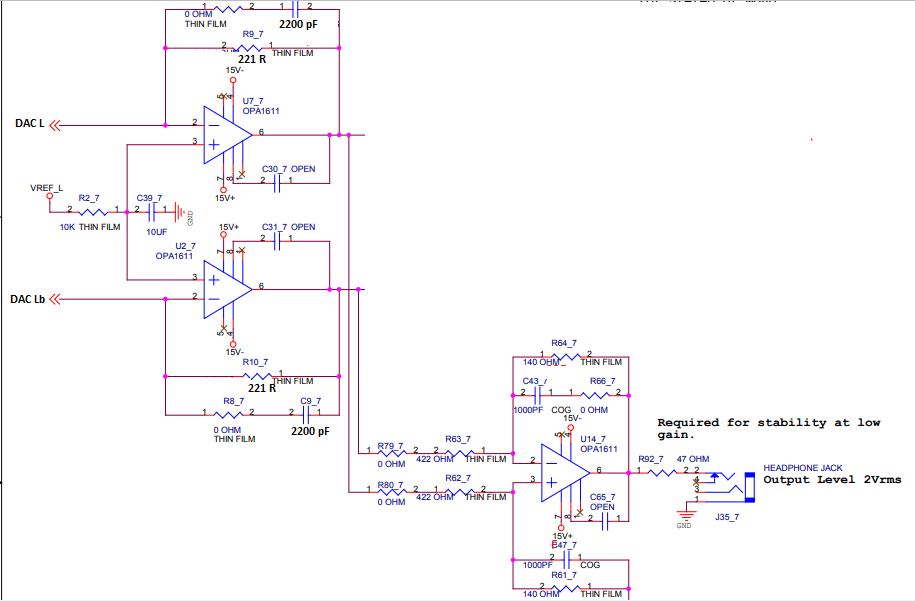

Output stage build as datasheet with tweaked values as discussed here before.
First OPA 1612 gets 9.5v at outputs(pin 1 and 7). Couldn’t find the problem.
since it was a ”test card” i made it possible to remove servo and rebuild it as a ”standard” outputstage as the 9038pro.
That stage i have in a own build 9038 so it more familiar for me.
Use 1.65v diveded from avcc on pin 3 and 5.
but still no sound from output and also on this stage i have around 9.5v output from opa1612.
Can it be wrong settings in the registers?
Anyone have a 9039 running in stereo?
PS. I know the bridges on the dac chip. They were fixed after picture :)
BR// Daniel

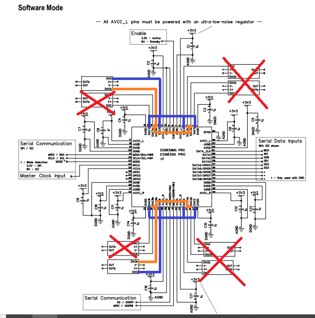

For the STEREO you need to set reg#0 to b00101110.
You'll not achieve the datasheet's specs if outputs are simply shorted. I believe 9039 noiseshapers are asynchronous, and syncing a few of them drops loop gain. 9038 is Ok to short, at least 9038Q2M shorting adds 3db to the DR as it supposes to be. OPA1612 has not enough output current to handle summed 9039pro current.

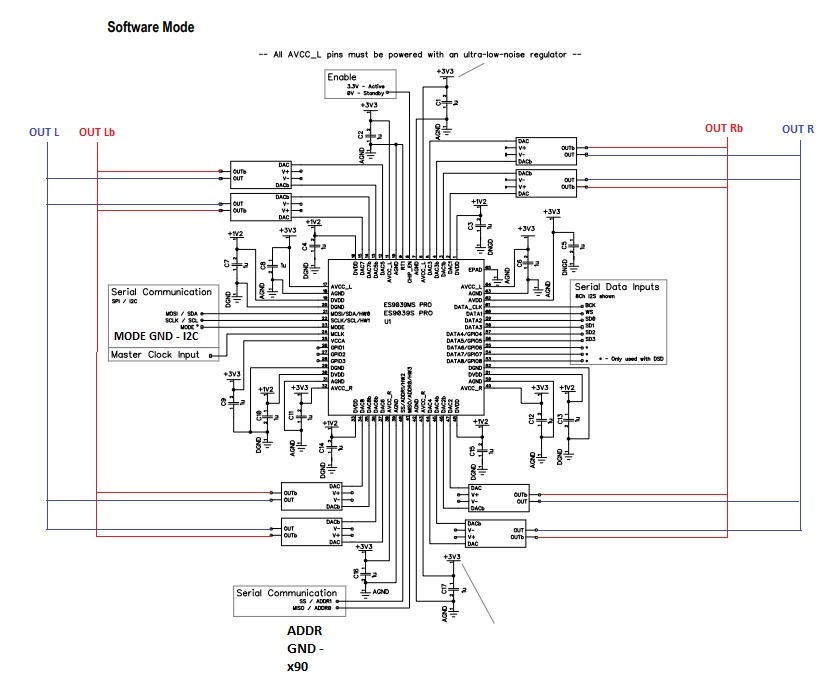

I tie output togheter like this.
I use ADM7154 for AVCC L, AVCC R and clock (50Mhz CCHD-950). Multi TPS7A20 to other 3.3V connections.
And a SPX3819M5-L-12TR for DVDD at 1.2V.
All volatge around dac messure ok and chip is found by MCU,
I did try the same outputstage as in my 3038pro, With some tweaked value.
It works perfect in the 9038pro in stereo mode .
You think it can't handle the 9039pro in stereo setup? With 4 output tied togheter?
