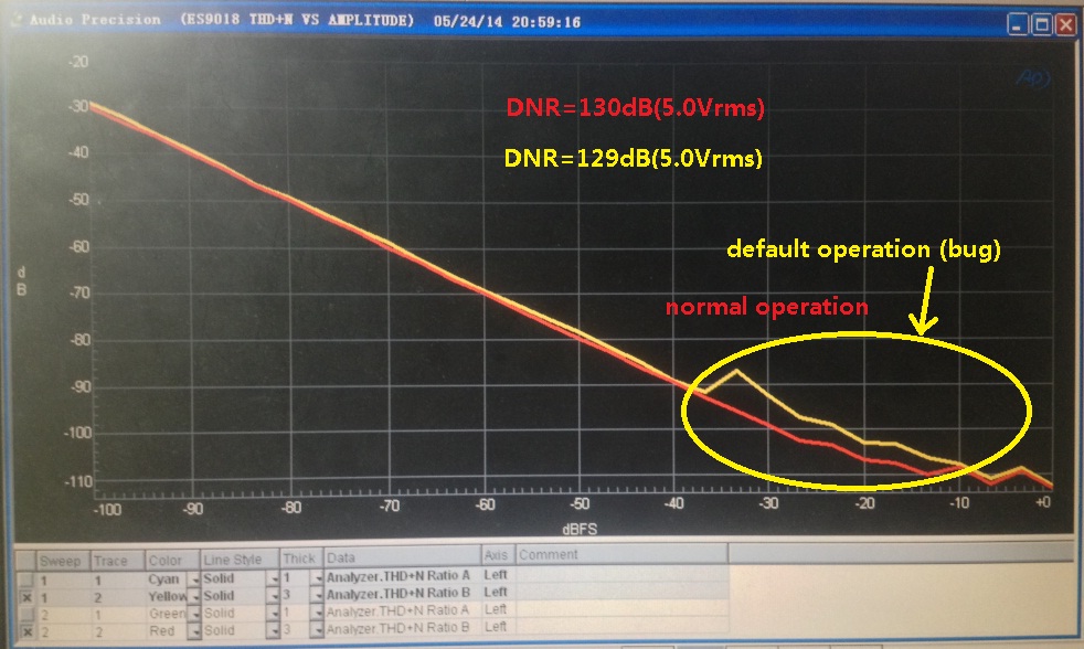

Hi Dustin,
It seems that you've not been log on diyaudio for a long time. I post my question here in case you come here again later or ...
It it no double that ES9018 has the noise bumping issue in every chip. No matter which I/V you use, discrete or OPAMP or tue (if you can done a tube output stage which can deliver ~1.5uV rms noise in audio band).
But in fact, the chip can work normally in some way. (I am not sure about the root cause and corresponding solution) Please find the measurement below:
the yellow curve is the default working condition, in this way ES9018 diliver ~129dB DNR in my bench. But most important thing is that the THD+N is a little poor in the range -10dBFS to -36dBFS. When I dig it deeper, I found that the THD is not the issue, but the noise floor.
the red curve is the normal operation which I expect from ES9018. It delivers 130dB DNR and excellent THD+N in the full output range. Further check on this working condition, the whole system provide amazing linearity up to +/-1 ~2 dB error in -140dBFS to 150dBFS range.
I think all the user want to get the second operation condition from ES9018. Will you share your comment on this question?
Thank you in advance.
BR
Paul Lu

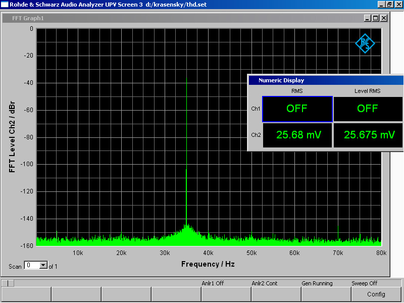

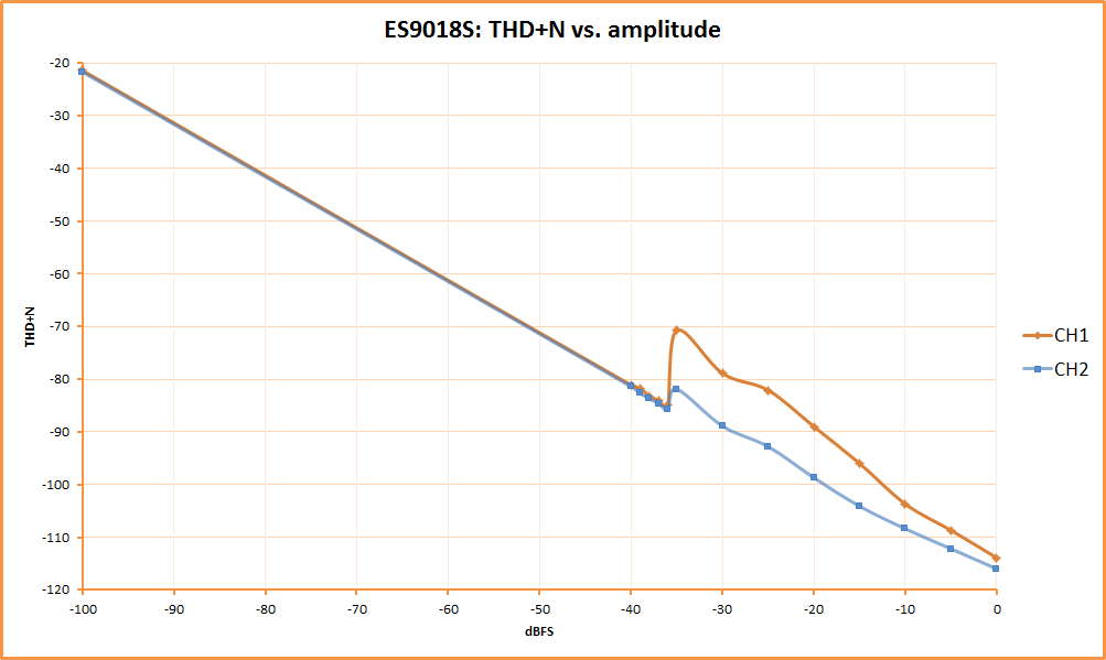

Hi Paul,
I was dealing with the same problem, thinking that it is my design's issue, until I've been told about your post.
I've reached over -124dB THD and ~1.6uVrms audio band noise, which yields about 121dB DNR (my module is 8 channel with 1.6V output voltage). But interestingly, I found out that every channel has different full-scale THD+N, varying from -113 to -116.5dB. I spent tens of hours trying to solve it!
After reading your post, I sat again to R&S UPV and measured THD+N vs. amplitude and got the same result as you. There really is a bug manifesting itself between -35 and -36dBFS by steep noise rise, while THD level is not affected. However, I think it is a output, not input stage bug, because it acts differently on each channel.
Channels 2 and 6 are performing best, while 1, 7 and 8 are the worst. All measurements has been made with I2S input in asynchronous mode and the bug is present with both cheap Fox and high-quality PLEtronics MCLK oscillator.
Unfortunatelly, I can't (or at least don't know how to) make a plot of noise vs. DC level (in dBFS). Could you try to do it on your AP? I think there may be only single (or few) problematic DC level/s corresponding to certain input data levels, which could be filtered out by DSP to solve this problem.
I've sent a message to ESS tech support more than week ago... still no reply.

I have thought it too.
If the DAC runs differently upper/lower -36dB, it must be the cause.
but ES9018 have 64 elements, can produce ±0 to ±32 ,total 65 level ,and digital BPZ is ±0 level.
(2.112mA of offset current indicate it)
thus lower the -36dB, the DAC runs between ±0.5 level.
At that time the DAC runs like -1,0,1:2bitDAC , not 0,1:1bitDAC.
±2 level will rarely appear before -30dB.
Nevertheless the 2nd and upper DAC element/driving circuit is the cause of the noise...?

I don't have access to audio analyzer right now, but if I remember well, I measured noise with few DC offset values over -36dBFS amplitude and didn't find significant noise increase. Therefore I think this whole bug happens on one or few values.
However, now I calculated THD+N amplitude from my measured data (please see attached .xlsx) and found out that on channel 1 there is rapid increase from 1.43uV at -36dBFS to 8.35uV at -35dBFS and then decrease again with rising amplitude! I don't get it... does anybody do?

Seems like similar feature as TI DAC chips have in PCM mode, but there it is due to the combined parallel PCM & SDM and non-linearities caused by the PCM side bits kicking in. In this case, yes it is clearly 6-bit parallel output popping up, since 6-bits in binary drops out at -36 dB. Below that point is is practically multi-element 1-bit output (a bit like my DSC1 DAC is always).
Element matching is supposed to solve these issues on true multi-bit SDM (which is due to element inaccuracies), but many DACs use too simple DEM algorithm (I guess Sabre and dCS having pretty much same algo) and thus it is not completely cleaned out. In any case even when DEM is successful the inaccuracy makes SNR suffer (as it becomes white noise). I have some ideas of further tricks how to avoid SNR loss on DEM, but it is fairly complex so I doubt if such has been implemented in these low clock speed implementations. It could be done on a PC though.
In these cases, Sabre and TI are using multiple elements to boost output level at expense on distortion and linearity, probably because they cannot host high enough modulator order (MCLK ratio limiting) to have better linearity throughout. So they run out of DEM space when output becomes truly multi-bit. Using DSD with Sabre may help a little because it changes the error distribution, but since it becomes always remodulated to multi-bit SDM it cannot completely solve the issue.
Low order modulators exhibit such noise modulation/idle tone behavior, especially when not adequately dithered.
In these cases, Sabre and TI are using multiple elements to boost output level at expense on distortion and linearity, probably because they cannot host high enough modulator order (MCLK ratio limiting) to have better linearity throughout. .....................................................

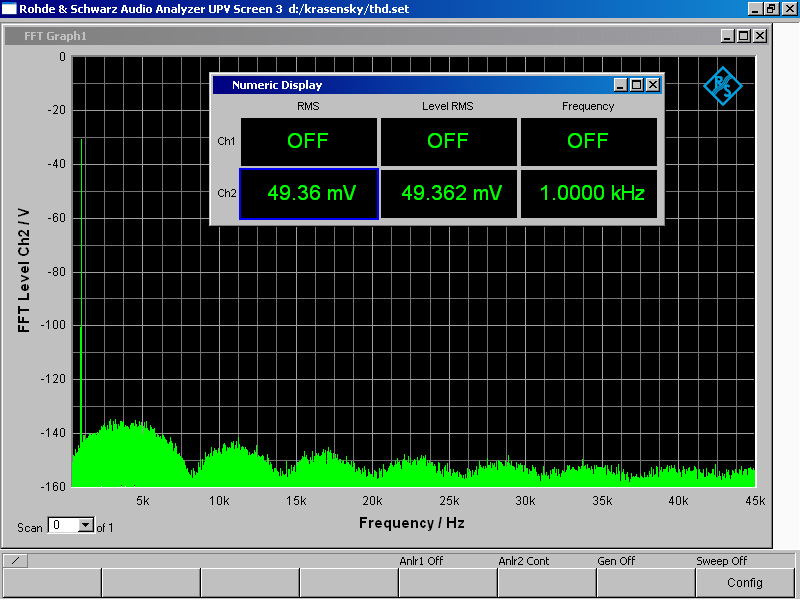

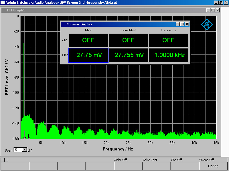

Sabre whitepaper says in the part about HyperStream modulator:
So I assume the problem is not caused by modulator itself, unless ESS is lying there. Sygnalist, you are probably right about DEM.
My question is:
Why is the size of noise bump different on each channel? There is a 14dB bump on channel 1, but only 3.5dB on channel 2! Channel 6 is similar to 2 and others are between.
They all use the same modulator, same algorithms, same hardware. Is it possible that on-chip DAC elements are differently mismatched and DEM's effort to correct these mismatches causes different noise bumps?
If the problem was caused by modulator limit cycles, I think it's intensity would be the same on all channels.
Please find attached measurements of CH1 on -25,-30,-35 and -40dBFS. I really hope someone could tell us what exactly is going on there.

What is register 15? I just found "RESERVED, Must be set to 8b00000000 for normal operation."wow it looks comb filtered noise. I am curious what happens in other quantizer setting with register 15.
If you meant the full scale on channel 1, yes, there still can be seen that noise is shaped somehow, but it is not that clearly visible. And all other channels have noise the bump too, but smaller. On attached pictures is a comparison of CH1 and much cleaner CH2 very slightly below the bump. It's on 35kHz and on the same level relative to FS.Signalyst said:There is always some bump?
Heh, so it seems we should ask ESS for a laser trimmed or more accuratelly made chip or buy hundreds of it and make a selection.
Still, I don't get why the noise falls down again when amplitude is rising from 35dB up. There should be even less space for element scrambling...
