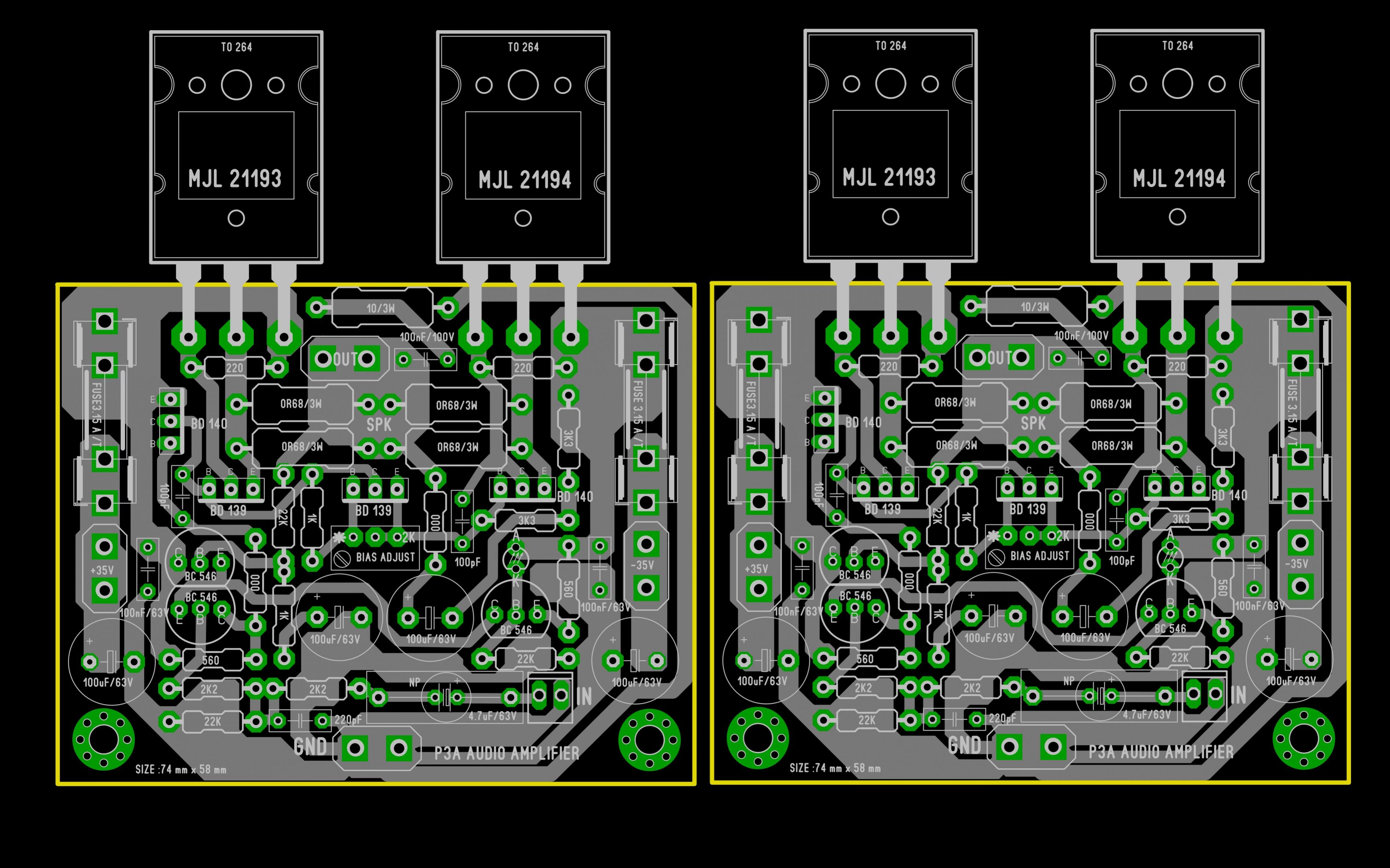

I have one layout only for P3A project ....
Regards,Alex

Genuine ESP PCBs are fine for this amp. Even biased to 1.5A (for ESP Project 3B Class-A version) they're fine. I have built two stereo P3 amps and both have been running without a glitch for 5 years+ already. Only issue is that if the PCBs are dissected for installation on opposite sides of a chassis, then a hack should be done to correct some bypass caps and if biased high (like for P3B) then a 10R ground lift ought to be installed at the signal input of each half PCB to address circulating chassis current issues (that I encountered anyway).
If I were building another stereo amp there would be no question - a single (non-dissected) stereo P3A PCB from Rod Elliott in standard A/B bias on a single heatsink.
BTW, Q6 and Q9 ought to be glued to each other. Original PCBs enable that!

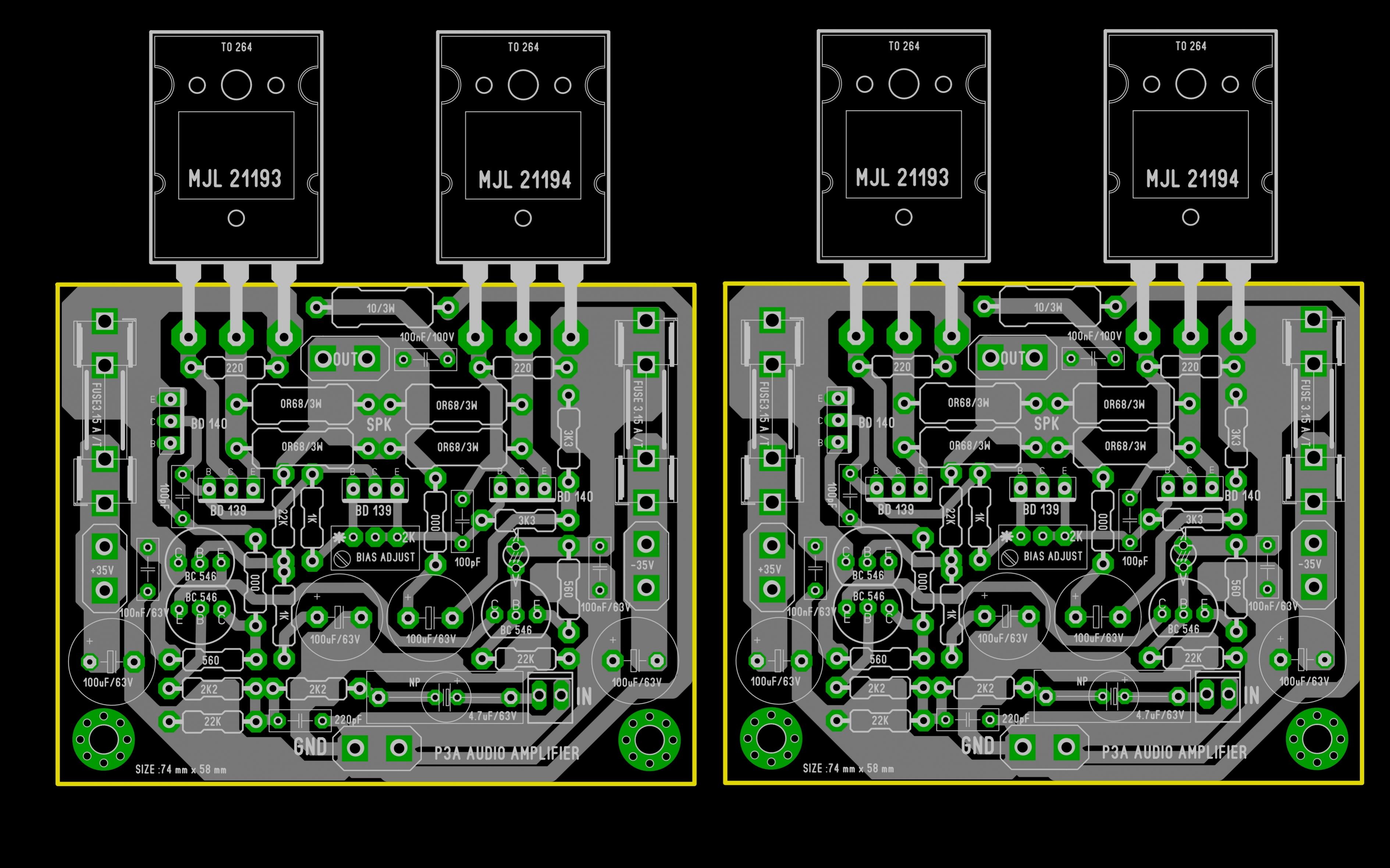

hi all,
i have made a layout for ESP P3 (not P3A), trying to minimize the size with mostly through hole components. the smd cap is optional as per the ESP website.
pl remove this post if this is not allowed.:D
prasi
My considerations for this design of P3 are as follows
1. R6, R5 T2 closely connected.
2. Feedback from center of o/p.
3. Decoupling close to o/p pins ( not nearly there).
4. Star grounding
The design does not require any heat sink for small signal transistors as per esp pages.
Bias servo works as designed in practice very well. This is again from esp pages...
So really appreciate some comments.
Not too sure regarding placement of zobel..is it correct?

1. there are no PCB's available for "P3". I agree "P3A" is current amp for which PCB's are available and there is no re-engineering required .
2. since P3 is a simple amp, the layout for P3 was meant as a learning exercise and for discussion. If this is not allowed, I wont post anything more here regarding ESP projects. This, I stated even in my first post of layout..
