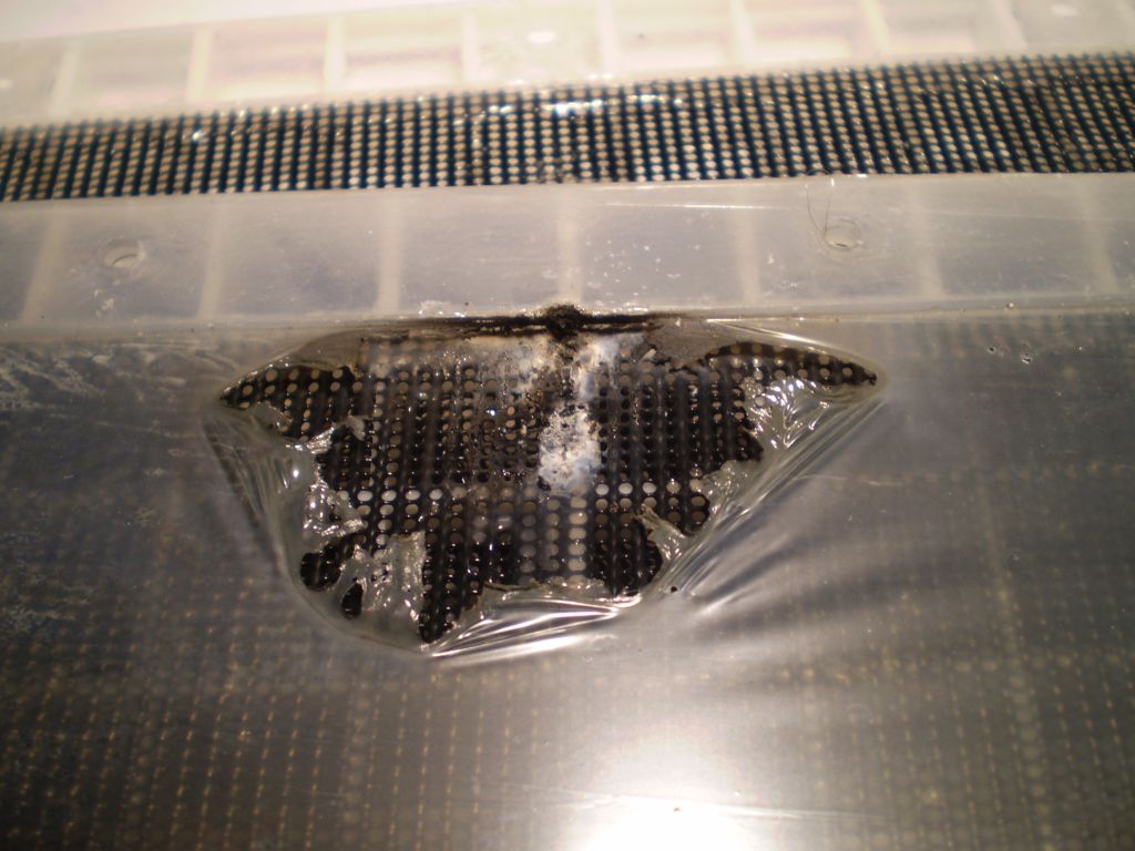

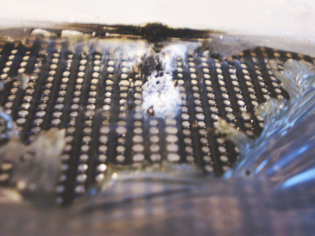

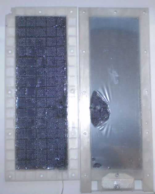

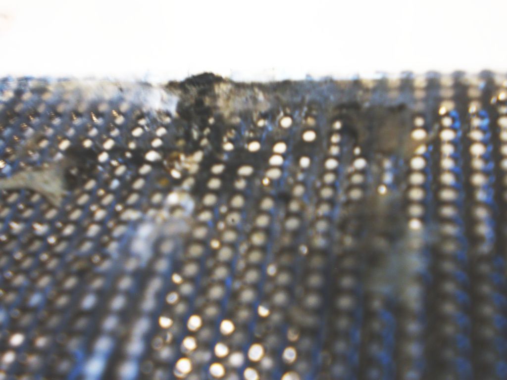

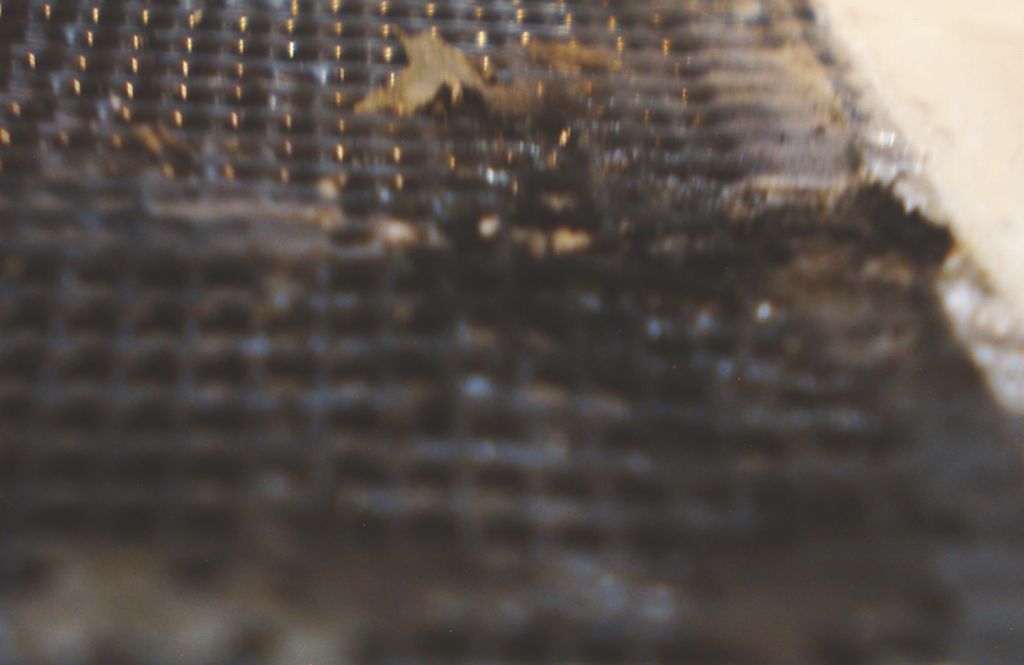

I have been working on getting my little panels running again.
In doing so I have temporarily fixed a transformer issue that I have been having.
Until, I get the materials,Like two large cores and some wire to do a ground up build and some rewinds and such.
Doing this was essential to get some SPL and frequency measurements of the panels as per driving voltages.
Those I got.
But the panel being tested had a bad spot that needed to be tended to.
On my last test for the day to see how high it would go, it gave out, and I burned it badly shorting the panel.
I think I can repair it to work again and I still have the other one as well.
But it needs to be worked on a little more too, So that it doesn't end up like its brother.
But,In the time I will spend repairing it I can build a new panel designed to take the next step of increased voltages much faster and easier.
I know that these panels can take it but it is pushing there limit of design.
This is not the same panel that failed before but is of the same pair.
It is a bummer as this was in its original form since I made it in 2003 except for some added coats of clear acrylic.
The other one was the one I had used to push to the limits to the point of clipping the diagphram to the stators.
So,after I had gotten all of my baseline measurements I wanted to fix the bad spot and continue on to the extreme limits but the bad spot gave out and I was not quick enough to turn down the power. :(
The wire mesh worked great for what I had designed them to do.
But the sharp edges of the cut wire and the uneven coating thickness of the very thin powder coated wires have issues that need to be worked out.
Such as corrosion of the aluminium underneath the coating and flexing causing micro cracks that had formed through the years.
I would say that have served me well and can still be used but it is time for a new build anyhow.
They worked perfectly when I first made them they way the were.
I will use this method of construction again sometime soon.
I had just acquired some 10" X 49" perforated metal panels that I may or may not cut in half to do a pair of small bass panels to experiment with before going on to a larger system.
I also have a different type drive method for a Direct-Drive in mind as well than using transformers.
I will embellish those ideas when I get a working model running,So it will be a long process and awhile until I get to that point.
On my next build I will be using my TIG wire method for a little panel slightly larger than the ones that I have been working with, So that I can see how well stator segmentation works.
Now that I have a clear impression of what my little panels sound like and there characteristics with measurements to boot.
Not to mention that I still have one good working identical panel to compare to when needed.
I already have 6 peices of 10" X 36" TIG wire stators made as well that need to be finnished,I just need to make 2 more, or maybe another 10 for a nice sized bass system for 20" X 72" per side.
I was using a 5.5Kv bias and a 1:256 step up ratio.
This panel had withheld up to a maximum 10.5Kv of bias without arcing.
But my supply produces 13.8Kv and so there was a sign of leakage somewhere and now I know where. he,he
I had ran as much as 50V to 60V peak into these before and I was no where's that when it failed!
It just goes to show you that all it takes is one bad weak spot to completely ruin an otherwise perfectly good panel.
Here are some pictures of my now ailing panel. :(
Gotta Love R&D !!!!
jer :)

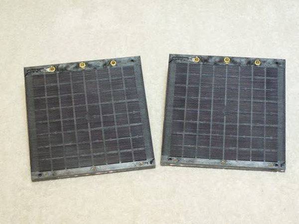

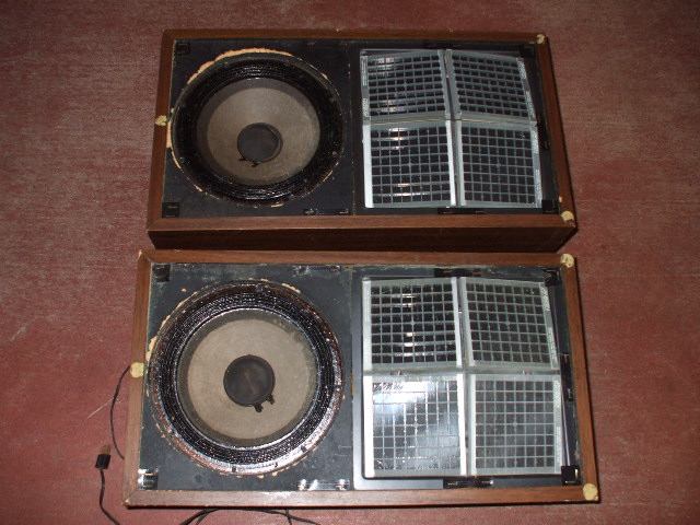

I got these Z-410.....post pic so people well no what thay look like
I have 6 of the black one all so....Sound great still...just never get around to puting them in a diy setup

Yep, those are the series 2 JansZen tweeters in addition to the gray pvc stator frame the insulated stator wire is wound around each frame and then the two are bonded together with the mylar diaphragm sandwiched between them. In the older series one JansZen panels the stator wire was cut and bonded to the inside only of each black pvc frame. This main design difference was done for the ease of manufacture. A higher speed winding machine could be used and there were less rejected parts due to misplaced or out of alignment stator wires.
