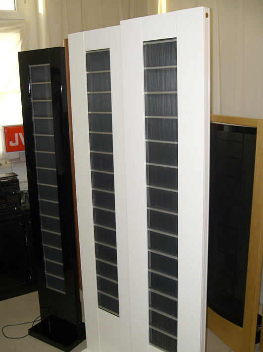

Acoustat panels
Acoustat only made two panels sizes 8"x48"-9"x48"....The 1+1s are 11"Wx 98"H
Two panels,one on top of the other in a frame........2+2 Are 2ea 19"Wx98"H

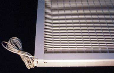

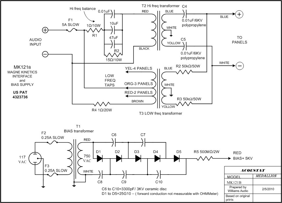

The M3s are 3 panels wide....two 9"x48" an one 8"x48" i just buy 9" panels an put to gather.. Here is a pic pr of M3........Here a 6600....like the 3s 3wx2h.....6 panels ea...in the other pic.....I have 9 panels there 30years old...thay sound great.....you can pik them up for $50ea ....3 panels wide gives low base.....Killed my DIy panels.....
Made of wire....plastic stators the pic... is one side of a panel
Bias is 5k......
Tranfourmers other my no on the winding.......long live Acoustats

I keep hearing about the Acoustat 2X2 panels- What are their dimensions? Perforated or wire stators? Spacing? Bias voltage? Xformer ratio?
Acoustats used cube louver (polystyrene) with wires. about 60% open
(~2 mm.) ((not exact)).
I believe the voltage was in the 5kVarea however after doing the IzzyWizzy mods I belive it was supposed to be in the ~5.5kVrange.
They used two transformers one for bass/mids, and one for uppermids/treble.
I believe that the hard part on the amplifier was playing the treble as the impedance is very low and (almost) entirely capacitive in nature.

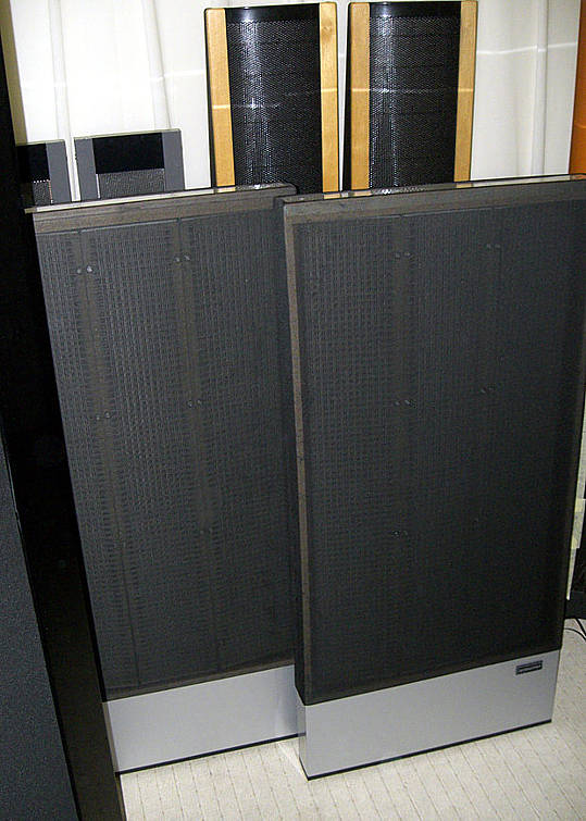

Audiostatic ES-600 and ES-900
I have a pair of Audiostatic ES-300 and a pair of ES-SW (Subwoofer) which makes a ES-600. I know that Audiostatic also sold a ES-900 series which was a ES-300 with two ES_SW on each side. A total of 6 panels 3 on each side.
Two on each side makes a ES-600.

It's a ES-300 without the full range part in the middle .
Sounds quite good if I may say so myself. I made an ESL that sounds much better than this ES-300, totally different transformer and much more bass than the Audiostatic :D
If there is enough interest I can start a group buy for the transformer that I designed myself. 1:150 and full range for driving a final 1.2 ESL. With panels that are 1.2 square meter! They are really small for the power they can handle about 130 Diameter x 5 cm high . The Final 1.4 is even bigger and has a different transformer but can also be driven by my transformer to normal listening levels (approx 90 db at 2 meter.
The costs where at that time about Euro 160,= per piece back in 2006.
I wonder what the price will be now. I'll ask them next week, just for fun.
The Panel of the ES-300 is 20 cm x 1.5 meter.
Audiofanatic :)
