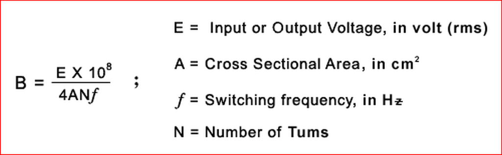

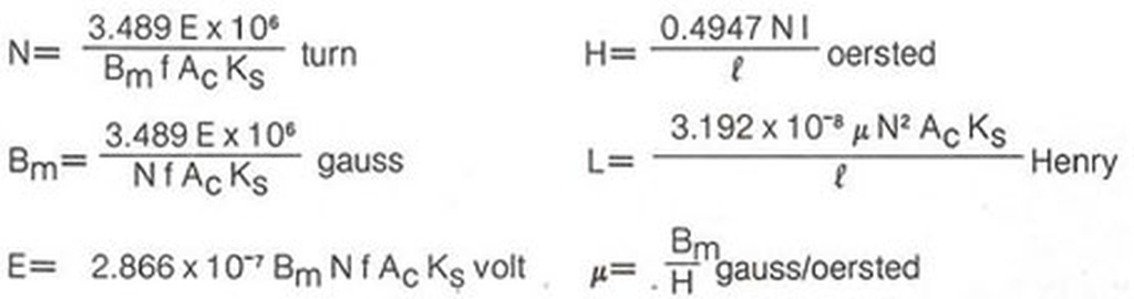

The number of turns of any one of the winding's is calculated by the factors of Frequency, Vrms and core cross sectional area so that the magnetic core flux doesn't get so great the it will saturate the core causing it not to be able to store more energy.
This also determines the VA rating at X frequency at Y voltage level, this typically reflects to core area.
Sometimes a Lbs. of iron per watt factor is used as well at ratings of 50Hz/60Hz.
The formulas are in the photos I posted.
They are straight forward and linear.
This means, since the transformers are designed for a minimum frequency of 50Hz then their marked voltage rating for a particular winding say 6V is the most voltage you can apply to this winding at a minimum of 50Hz without causing magnetic saturation of the core.
If you increase the Input frequency by X then you can also raise the input voltage be X without concern of saturating the transformers core.
This also raises the potential VA rating of the transformer as well providing that the winding's wire can handle the amount of the increase of the extra current in the windings.
Ohms law says that if you double the voltage for the same amount of ohms then the power goes up by 4 by the formula V^2/R=P.
Therefore our VA rating goes up by VA*X^2 this is the amount of power that can be transferred through the core without saturating it at "X*frequency" with "X*voltage".

This does not include any DC resistances or leakage inductance, primary winding inductance's and other loss factors but it will give you a general idea.
The primary windings inductance is a major factor as well as it will dip down into to the < 1-2 ohm range for the lowest frequency of interest also, if it is not high enough.
Also, The HV and LV winding's inductance is related using this formula,
HVinductance = LVinductance * Transformer ratio ^2 .
