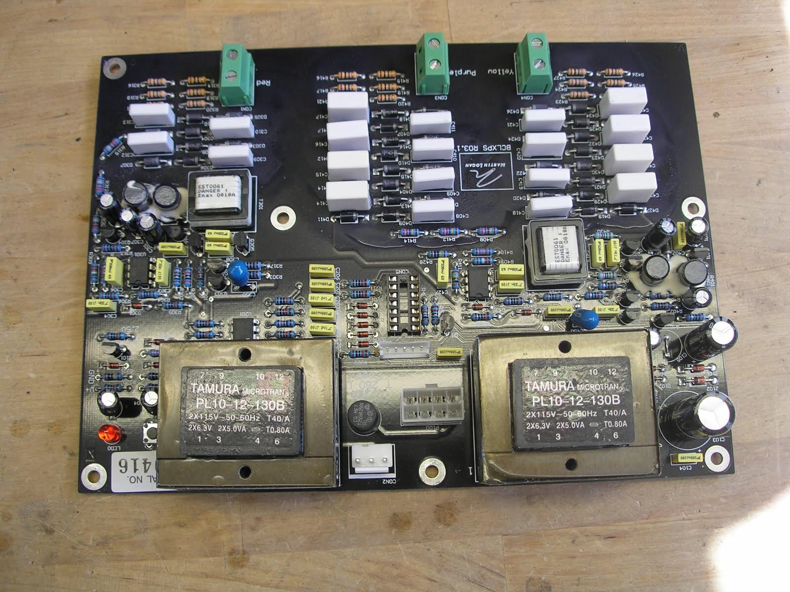

on the CLX board
Con 2 is the AC input. The AC plug is an IEC 3 pin, but there is NO AC ground connection to anything.
The 8 pin Molex socket has a choice of 2 plugs to series or parrallel the Tamura transformers primaries for 120 or 240 VAC . ( the Audio pimp on Audiogon was charging $800 to reconfigure for 240 VAC - a pimp's got to make a living somehow).
The red LED comes on as soon as the music sense circuit (IC U 201) turns on the HV supplies.
the other 2 of 8 pin chips (dual fet opamps) are the low and high frequency inverters. The misssing ic is where Martin Logan plug in a ribbon cable that runs over to the limiter board. The limiter board passes the incoming audio to the music sense portion of the main board by the same ribbon cable. The ribbon cable also provides power to the limiter board and turns on the gates the 4 heatsinked power fets for low frequency positive and negative and high frequency positive and negative leads that feed the 2 audio step up transformers

On the CLX power supply board the smaller white box cap is a 1000 pf 2 kv film cap of unmarked manufacturer and unmarked dielectric. The larger white box cap is 3300 pf 2kv. Wima FKP 1 are 2kv Film and foil polypropelene caps of the same value that fit the foot print.
On the CLX power supply board the smaller white box cap is a 1000 pf 2 kv...The larger white box cap is 3300 pf 2kv.
Ha! I was typing in that very question last night, but got interrupted and never finished.
Thanks for the very nice pic of of the HV board and anticipating my question.
The other question I had was concerning the opamps, you mentioned they were dual FET.
Can you remember the part number? The opamps used in the HV supplies of lower models is the LM358.
Oh, also do you happen to have a similar quality pic of the limiter board?

The 2 black cylinders on each side potted in white silicon are inductors.
I 'll get an underside shot of the Power supply board and both sides of the limiter board.
