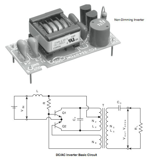

How best to wire-up and ground the EMCO f-series which are not center-tapped?
A center-tapped module would only be needed if you require two polarities of HV, such as if you were building a FINAL style "inverted" ESL where you put equal but opposite HV bias on the two stators, or a double diaphragm triple stator affair where diaphragms have equal but opposite HV bias.
For typical constant charge ESLs, simply connect the (-)Output of the EMCO f-series to your step-up transformer center tap and the (+)Output to the diaphragm thru an appropriate high value charge resistor. If you prefer a negative charge on your diaphragm, swap the (-) & (+) outputs.
The specs state that the CCFL's are AC output...They just use a couple of transistors in a multivibrator configuration to drive the transformer. I don't recall any regulation built in to it either, there may have been a zener diode but I don't remember...I had found this odd for a constant voltage output type.
CCFL inverters are a resonant version of the Royer oscillator circuit dating back to the 50s. The original Royer circuit used transformer saturation to drive the switching and output square waveform like a mulitvibrator. The CCFL inverters however are designed with a tuned circuit on the primary side and put out a nice clean sinewave with very little harmonic content radiated. The circuit for non-dimming version looks surprisingly simple, although as you can imagine the special transformer is a big part of what makes that possible. Attached circuit is for the TDK modules that you can pick up for around $10.

Interesting... Do you have a full picture of that Martin Logan HV CCFL type inverter?CCFL inverters are a resonant version of the Royer oscillator circuit dating back to the 50s. The original Royer circuit used transformer saturation to drive the switching and output square waveform like a mulitvibrator. The CCFL inverters however are designed with a tuned circuit on the primary side and put out a nice clean sinewave with very little harmonic content radiated. The circuit for non-dimming version looks surprisingly simple, although as you can imagine the special transformer is a big part of what makes that possible. Attached circuit is for the TDK modules that you can pick up for around $10.
More info here==>http://www.diyaudio.com/forums/plan...nel-efficiency-first-build-9.html#post3471237
Regarding regulation: This type of circuit has surprisingly good self regulation. For a given DC input voltage, the AC output voltage doesn't vary much at all with different loads. Also the magnitude of the output voltage varies linearly with the DC input voltage. Obviously if you feel the need to improve regulation, it is easy enough to feedback a rectified/smoothed portion of the output voltage to an LM317 used to regulate the DC input voltage. I have not found this to be necessary.

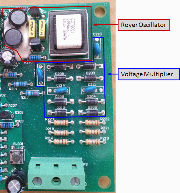

Also can someone tell me what's the purpose of this diode ground loop circuit on D12, D13, Z3, Z4, Z5, Z6, Z7, Z8 Z9, Z9, Z10, Z11, Z12, Z13, D26, D27 in this Martin Logan HV bias board schematic? Is this to filter the transformer AC transient voltage or interference from the HV DC full wave multiplier section? I noticed the amount of Z3 thru Z13 diodes and jumpers can be altered with different models.
I can post a picture next week of the full board, but what you see is all there is to the HV CFFL type supply. The rest of the board contains auto ON/OFF and MOSFET Limiter clamps to keep from arcing the panel if overdriven.Interesting... Do you have a full picture of that Martin Logan HV CCFL type inverter?
Martin Logan uses a string of zener diodes(Z3 - Z12) inside of a bridge rectifier(D12,13, D26,27) to regulate the output of the bias supply transformer which is fed to the HV multiplier. So, varying AC wall voltage does not affect the HV bias voltage.

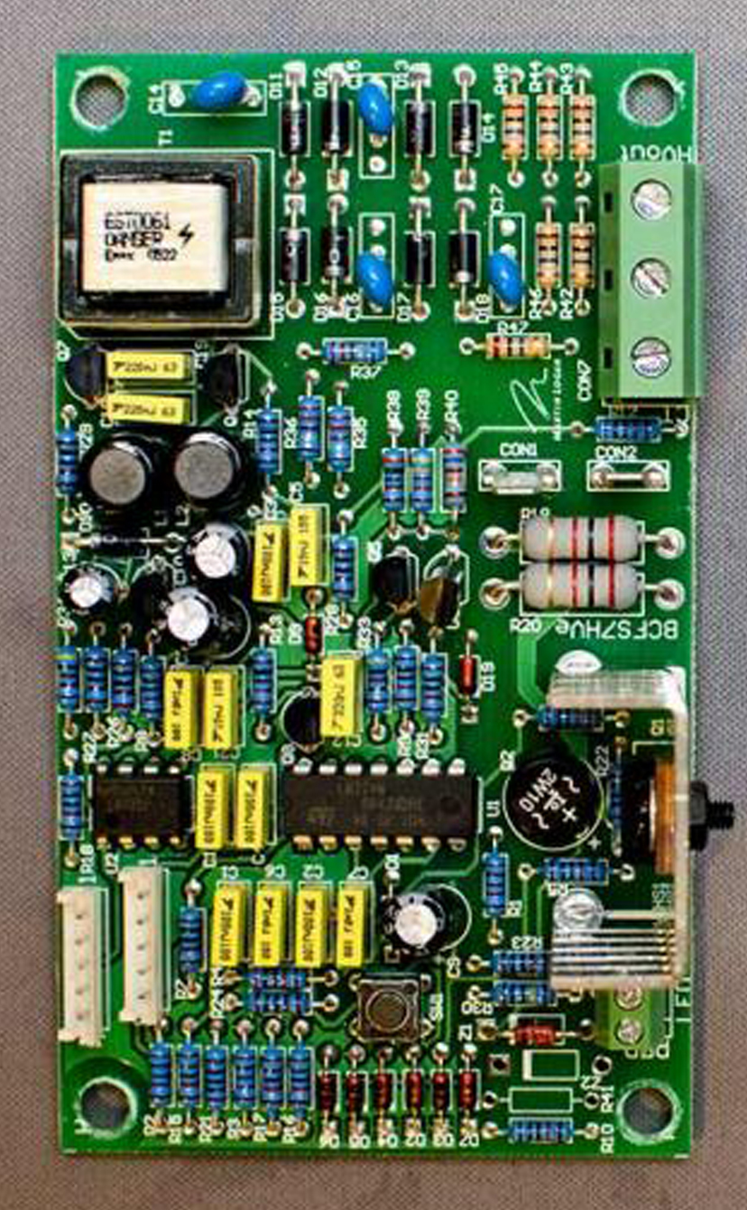

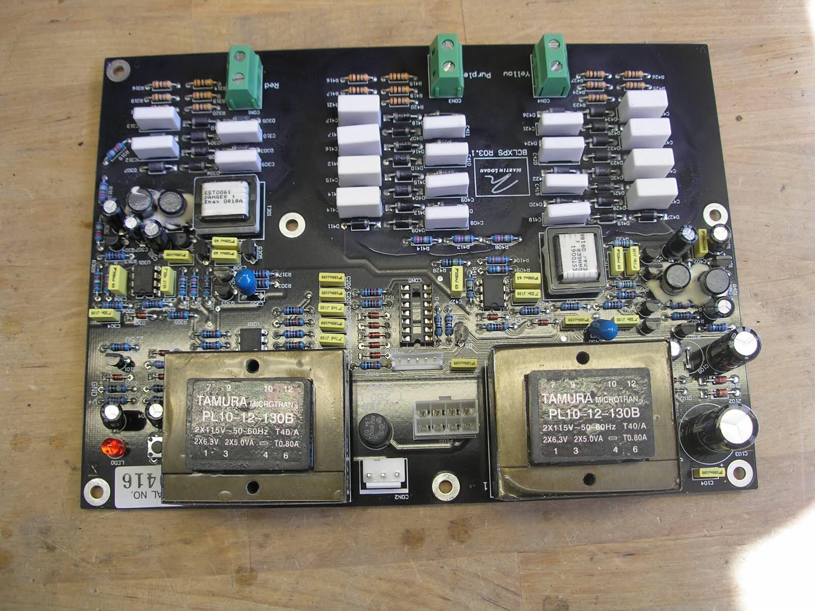

I just happened to locate a picture of the newer version power supply on another forum for the Summit-X.
Thanks for pic of the Summit-X power supply board.

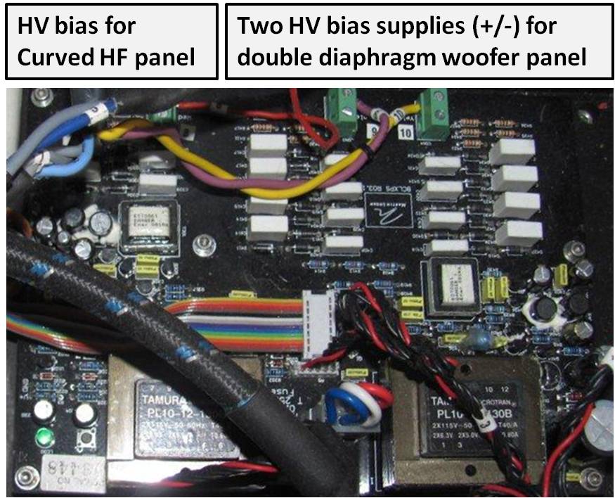

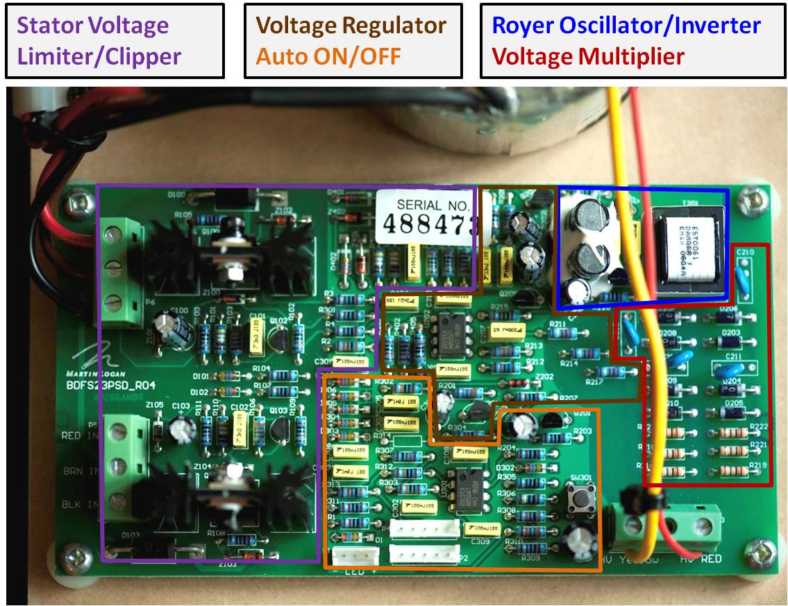

Here are two other ML power supply boards that use the Royer style oscillator/inverter.
I marked the functional zones on the Spire board since I am familiar with it.
Two interesting things I noticed on the CLX board:
1) Separate inverters were used; one for the lower bias voltage of the curved HF panel,
and another for the higher bias voltage of the double diaphragm woofer.
2) In the two voltage multipliers for the woofer panel(+HV for one diaphragm, -HV for the other) it appears they used larger capacitors for 4 out of 8 caps in the multiplier chain.
I've seen HV supplies where the first capacitor in the multiplier chain was increased in size to substantially reduce ripple at minimal cost, but increasing size of half the caps is new to me...not sure what the reasoning is. Considering the cost of the CLX, if ripple reduction was the goal why didn't they just use the larger value for all 8 caps? Thoughts anybody?

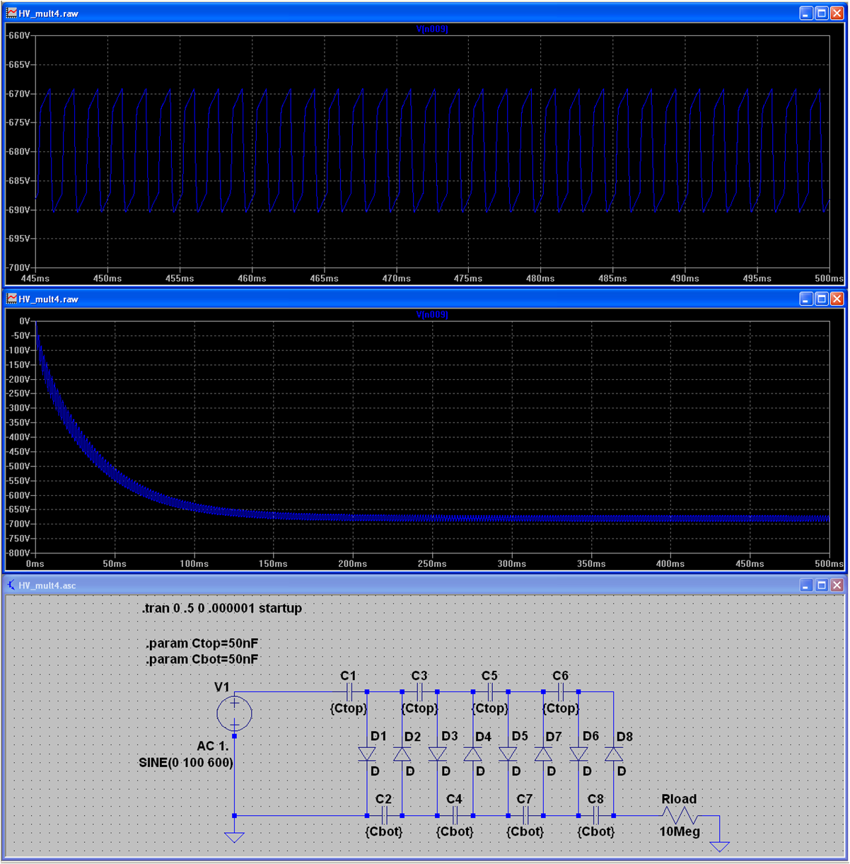

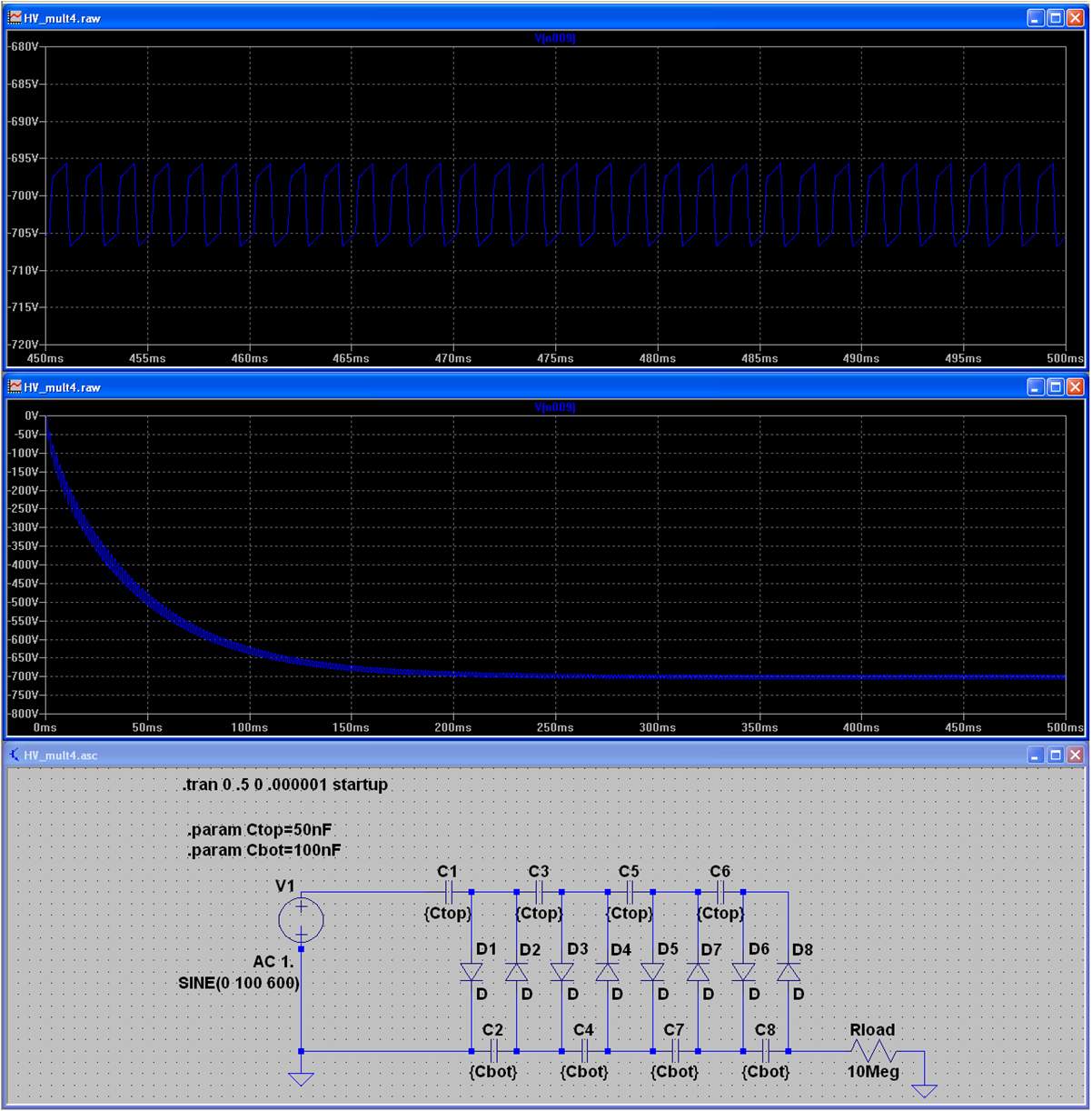

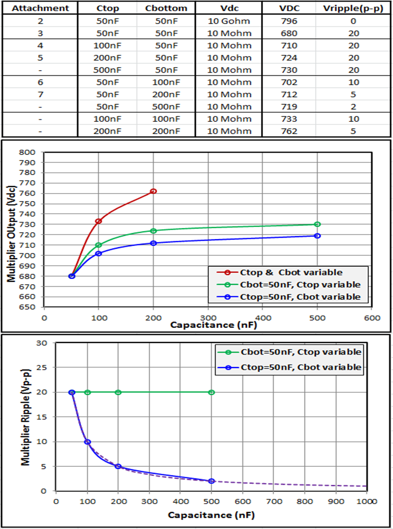

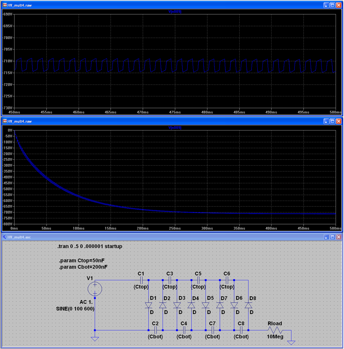

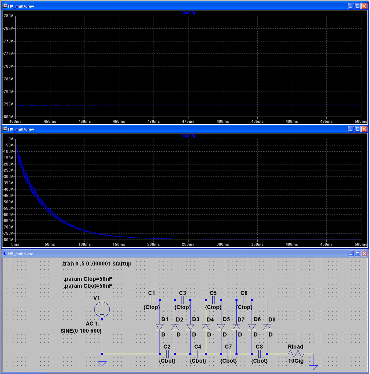

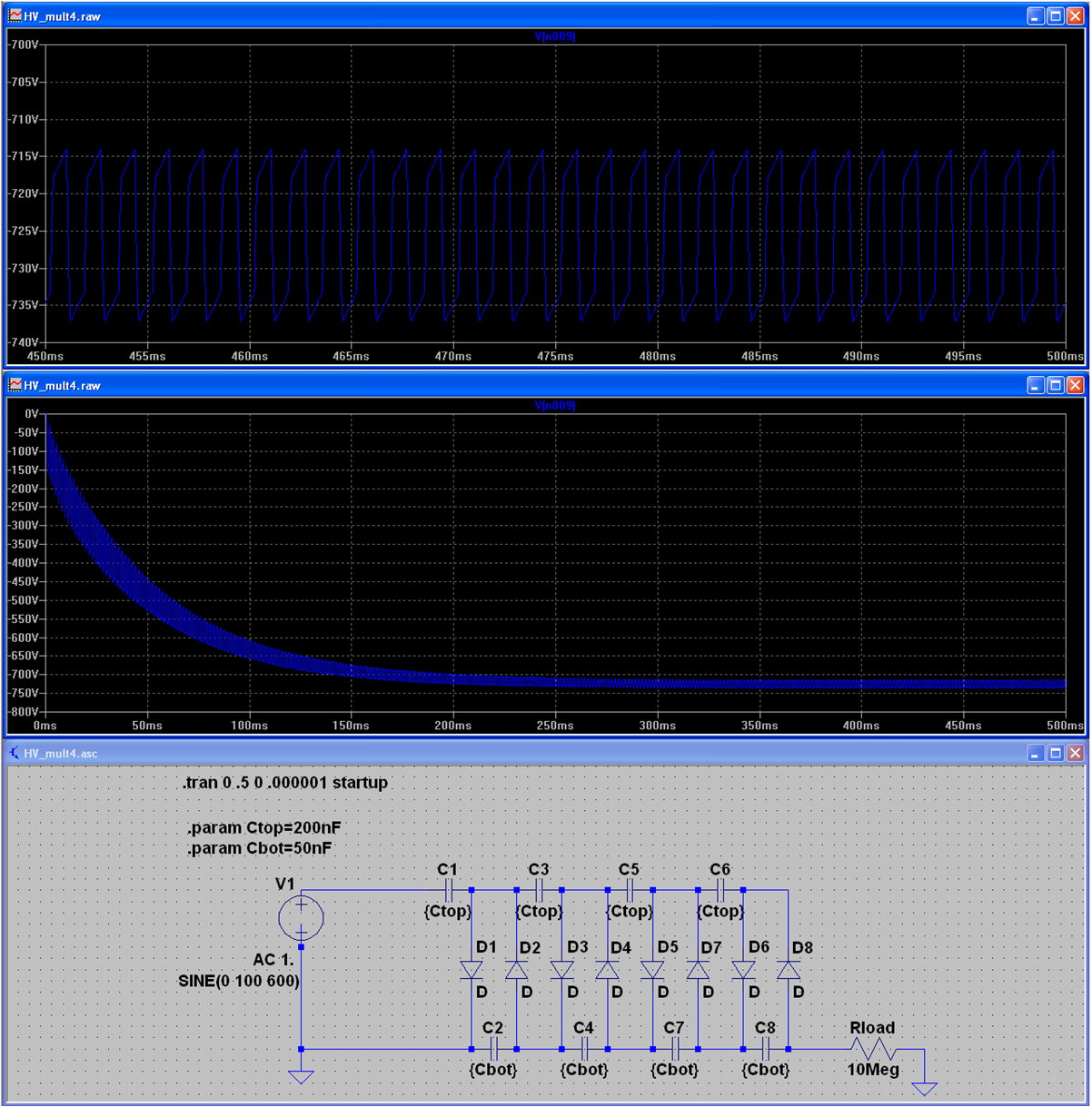

As usual curiosity got the better of me and after a bit of experimenting on the test bench, there actually appears to be a very good reason for only increasing half of the caps in the multiplier. Looking at the example multiplier circuit shown in the attachments, let’s call the upper string of capacitors Ctop, and the bottom string of capacitors Cbot. The long term ripple is determined only by the size of the Cbot caps. The Ctop caps only affect the long term DC voltage magnitude and how quickly it gets there.I've seen HV supplies where the first capacitor in the multiplier chain was increased in size to substantially reduce ripple at minimal cost, but increasing size of half the caps is new to me...not sure what the reasoning is.
Rather than trying to tabulate and plot all my experimental results, I performed a few quick LTSpice runs to better illustrate the trends.
Attachment #1 Summary of Ctop, Cbot, Load, and Voltages for each run along with associated attachment pic.
Attachment #2 - 9 LTSpice screen captures for each run.
(Input voltage for each run was 100Vp = 70.71Vrms)
Some observations:
1) With a very light loading(10 Gohm) the output voltage is essentially Vp x number of capacitors. Voltage drops across diode junctions make it slightly less.
2) Every doubling of Cbot results in halving the ripple magnitude. Looking at the trend curve for ripple voltage at the bottom of Attachment #1 you can see that you may quickly ran into diminishing returns.
3) Increasing Ctop has no effect on ripple, but does increase the Vdc output. However, it would be just as easy to leave Ctop the same size and increase the input voltage to the multiplier by a small amount. I'm guessing this is the route that was chosen for the CLX woofer supplies.
