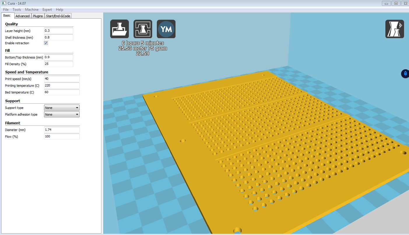

Nice idea, but be prepared for long printing time: I made a model of a 57 panel from memory, cut down to 1/4 in length and got a result of 6 hours. The many holes is the culprit here..
If You have a speedy printer with large building area, and go ahead with printing, I have an idea for the conducting layer: Glue 3 very thin copper strips over the hole areas, on the outside. Place the stator on a flat surface and fill the 0.7 mm deep "bassins" with ferric chloride and etch away copper that covers the holes...
Bwaslo, I don't understand you want to print this, as the stator of the ESL 57 is a flat plastic sheet with round holes all of the same size.
I can give you the outside size, the hole size, the thickness and the hole pattern. The spacers for the diaphragm are glued on plastic strips, I can give you width and thickness of those too.
If You have a speedy printer with large building area, and go ahead with printing,...
6 hours is nothing for a 3D print! That's why they aren't used for manufacturing. More than 24 hours isn't uncommon. After all, it's the printer's time, not mine!
My printers bed is 300mm x 300mm, so, yeah, I was thinking of doing it in sections. Not an exact copy, but similar. I'd also use a wider nozzle, which can dramatically speed up print time compared to the usual 0.4mm nozzle.
My model is one quarter in length, gives 24 hours.....
You need two panels, gives 48 hours......
My experience with 3d printers tells me that a nice 3 mm hole is very hard to
achieve with larger nozzles than 0.2 mm.
But, I have Anet A8:s and A2:s, not what you can call super good printers.
I hope You give it a try, should be very interesting to follow!

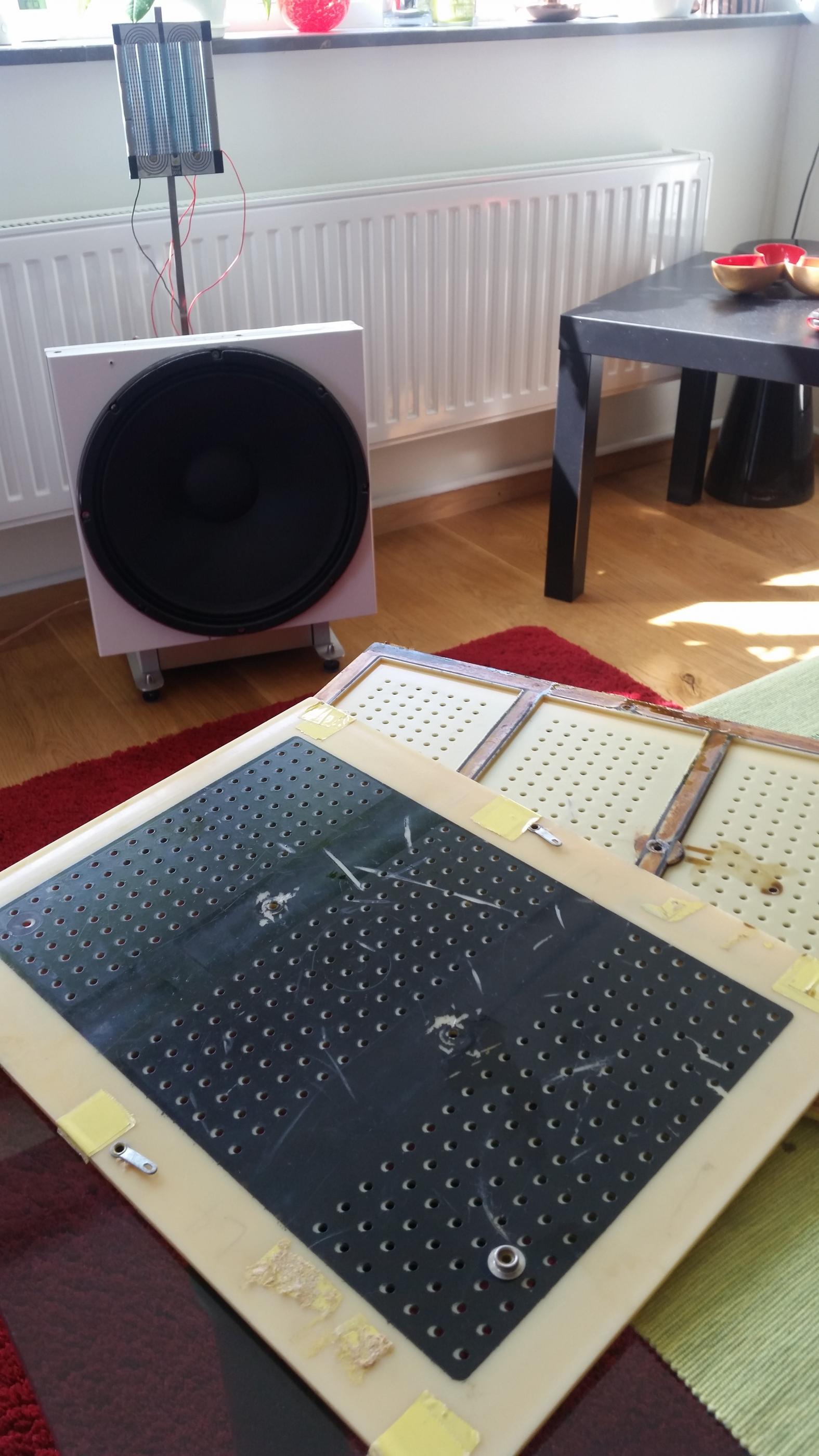

Like these KLH(?) panels? (Found them on a street sale in Copenhagen!)
Nice push-on contacts.
Actually, these would be no problem for a 3D printer, very few holes!
