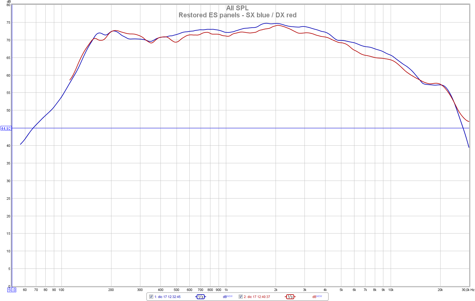

Hello Friends,
herein is the frequency response of my Re-coated Sequel II panels, taken at 30 cm on-axis and at the center of each panel.
The panels are directly driven at the high-voltage transformer, the HPF is removed/bypassed in my Sequel because I am using a multi-ampli active xover schema.
The measured frequency responses show that the linearity is matching the legacy (native) response: the 6dB/oct roll-off from 4 kHz is normal for this panel.
So, after the re-coating using the Licron Chrystal, the frequency response didn't change, while the output level improved of about 10 dB (you cannot see from this graph only,... go back to my previous post and compare the levels).
In conclusion, the washing only I don't suggest to anyone, unless the panels are very dirty due to bad maintenance.
Indeed I kindly suggest to re-coat the panels in order to really get back the almost original performance.
Again, thanks to all for the support had so far
Merry Christmas and Happy New Year!
Andrea
