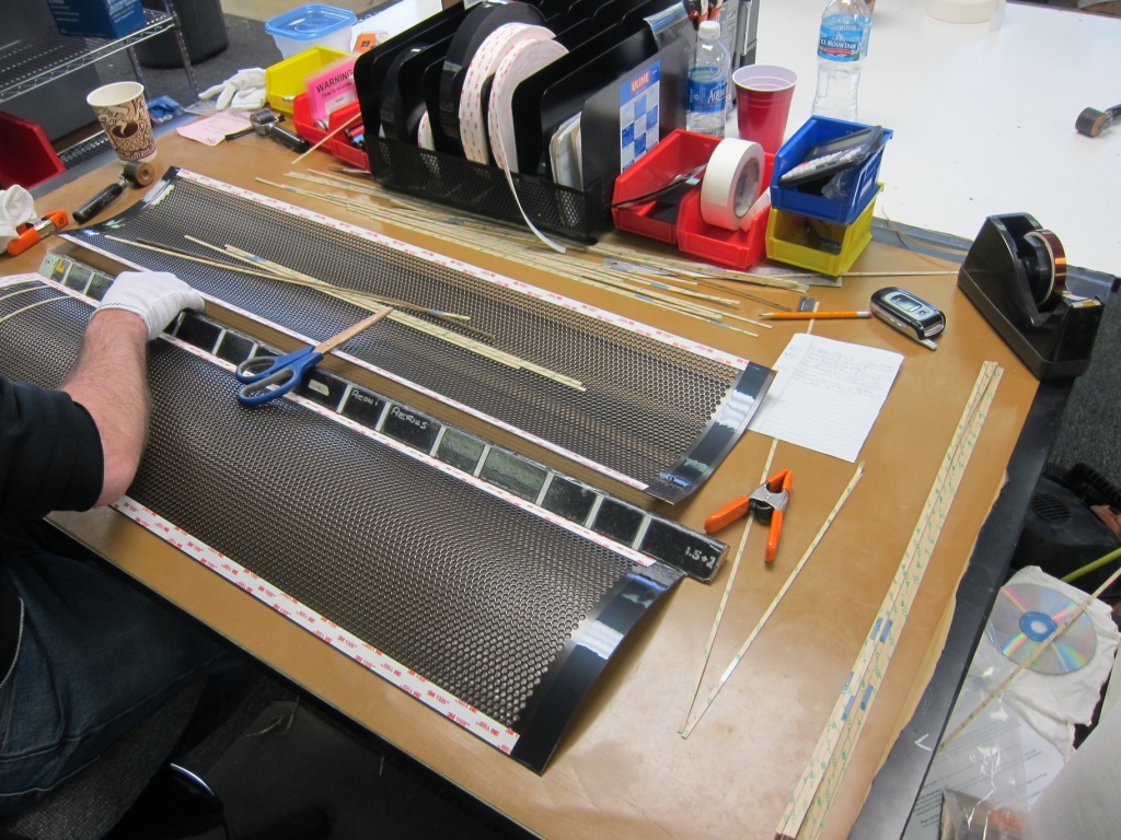

Never had a ML, Like to get a CLS just to see how their made, I always thought of them as being stacked curved panels, never knew they were a full curved panel. Could you show a side edge view of the panel? . I imagine they would have cross supports on rear side of panel to keep the diaphram tite, or maybe they use the stator as the tensioning device. Al
Frist pic is the CLs back with mylar...all the ML panels are rolled 30% .... ML metel it starts flat...Thay roll the metel only then put on the myar..in the pix
....in the pix you can see thay pull the mylar only from the top to bottem... Then thay do the sides by hand..
Then he rools mylar so it stick good all the.way around the back of the one panel half...puts the front half on...good luck
know two... front an back... the mylar an bias feed is only on the back like you see in the other posted pic...
in this pix hes laying out the staters cross bars...see the gred...so he can get the cross bars the same on bouth panels... on the front an back ..then he well put the mylar an bias feed.. on the back only...

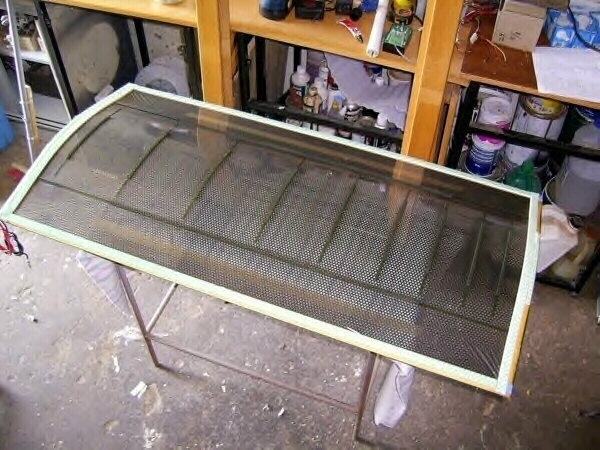

Do I see this correctly , the cross strips go on the lower stator, then the diaphram? Do the cross strips act as a spacer to keep the daiphram from hitting the lower stator? If so the top stator wouldn/t need any, am I correct here? I/m gonna see if I can find a bad set.

Yes the cross strips act as spacers.

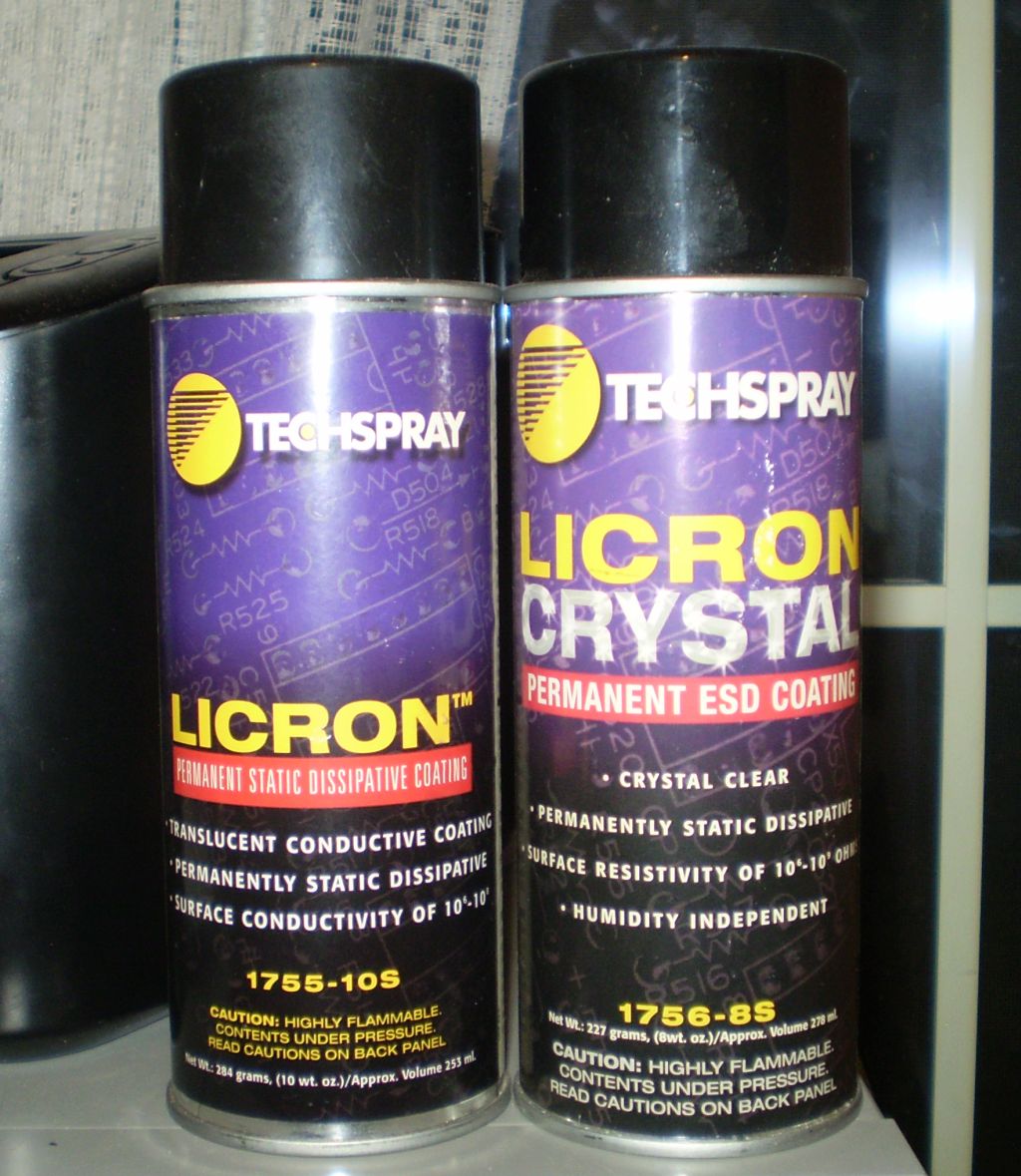

Which Licron did you get as there are two versions "Licron" or "Licron Cyrstal"?
Either will work but the Cyrstal is the one to use as it is much much thinner and it is nearly transparent.
I have A&B both and only in a side by side comparison could I really notice the difference in the sound but they Cyrstal is better.

I have had to replace more than my share of precious mylar diaphagms due to burn holes because of stator coating failure.
My last panel that had burned up still had it's original mylar and licron diaphragm that I made for it 10 years ago.

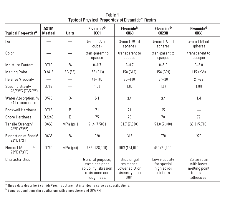

So, let's go back to the original topic .
I was curious about the nylon coating quad used in their quad 57 and refurbishing process to more or less similar specs as the original.
There is an "Electrostatic Speaker Conductive Coating Elvamide 120g" on sale in EBay.
However there are different grades of elvamide with different moisture content.
Table below suggests that 8023R/8066 are preferable(0-5%) and 8061/8063(0-0.7%) are not.
Also the datasheet says that 8061 comes in 3 mm cubes(and is the only type which comes in cubes). Since elvamide on e-bay also comes in cubes my conclusion is that they are selling 8061 and this should not be suitable as a coating.
Any experience?
Lukas.
