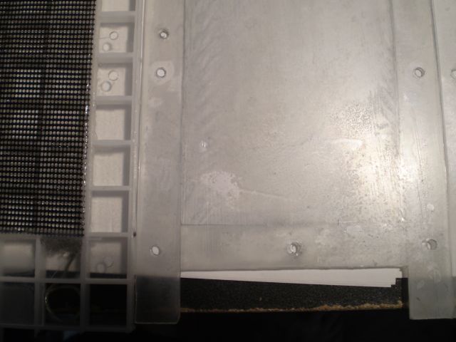

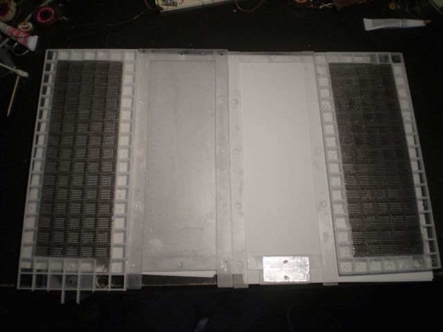

I got done messing with powder coated refurbished panel sprayed with clear acyrlic.
I have to tell ya,it took every bit of voltage my bias supply could output without any arc over and probaly picked up an extra 2db to 3db of efficiantcy.
After I revamp a few things and tidy things up a bit I will get some true measurements to compare too . jer

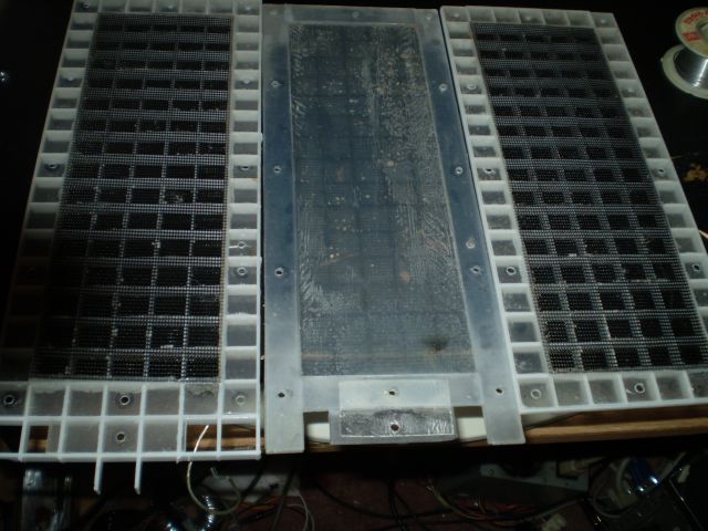

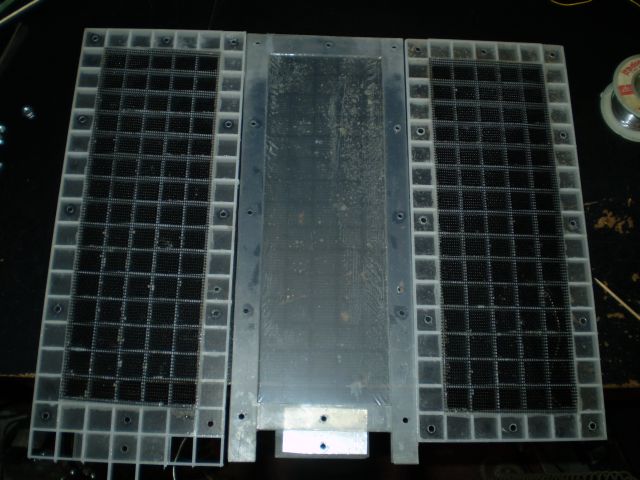

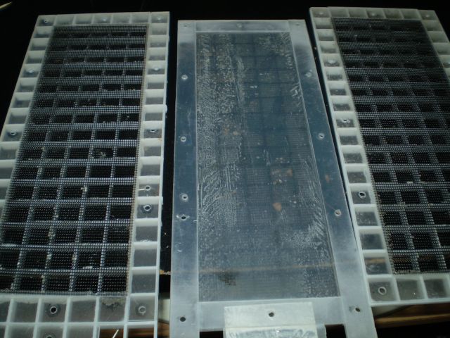

Been working on the second panel today.
It was in much worse shape than the first one.
I had to reglue the screens in a few spots as they were quite uneven and did not handle the bias voltage too good.

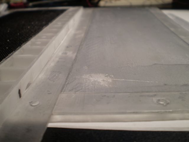

So,I cleaned them up,reglued and gave them several coats coats of clear acrylic (just like the last ones) until I had no arcing with my current bias voltage of about 7.5kv.
The diagphram was kept original (including a few pinhole tears) execpt for an extra coat of licron crystal on top of the original licron formula coating.
This was becuase of the spots of missing coating in some of the areas due to the cleaning process.
Mind you, it took some serious rubbing to make those spots to begin with as it was some sort of sticky brown dried on substance who knows what it was, along with salt, dirt and mud.
The coating held up suprizingly well after seven years as the pics show the abuse.
I will eventualy replace the diagphram after some testing to see if the original coating makes any noticeable difference in the sound due to its extra mass and thickness compared to the other identical one.
Improving on the bias voltage (approximately double) tremendously increased the efficiency.
Possibly matching that (or better)of sony speakers that I have been using, as they certainly can't keep up with two panels as it is.
