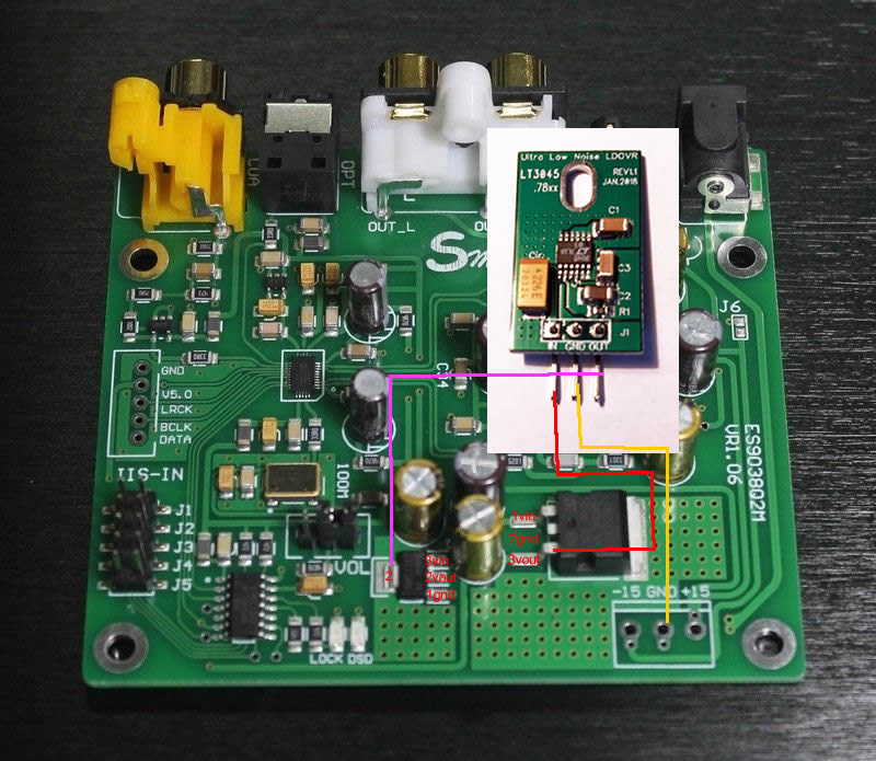

Despite of the fact that to do some mods you sould have some knowledge, I will try to help.
Indeed, AMS1117 have 3 pins - see datasheet. Namely, tab is the same connection as pin 2 (VOut). And at our board VOut trace is connected to tab (not to pin 2). Pinout of AMS1117 is:
1. Ground
2 and Tab - VOut
3. VIn
As I remember, in your small PCB with LT3045 pinout is the same as L7805 (for example, see datasheet too), i.e.
1. VIn
2. Ground
3. VOut
So, you need:
- desolder AMS1117
- place your PCB with LT3045 on original board somewhere near the L7805 (or 7808, it depends on version of original DAC)
- solder pin 1 of that PCB to pin 3 of L7805 in case of ver 1.06 (or L7808 in ver. 1.04)
- solder pin 2 of that PCB somewhere to ground (I think the simplest way is to do it via the existing hole to bottom layer)
- solder pin 3 of that PCB to the trace where tab of AMS1117 has been soldered
That's all. See also my picture in the post #336 for your reference (in that case pin 1 of my patch PCB is VOut, pin 8 is VIn, pins 3,6,7 is ground).
I just received the LT3045 regulator in 3.3v.
Does some of you may check the attached picture and tell me if it is the right way to connect it?
Thank you.
That looks right. Just be careful that nothing on the new regulator PCB touches anything on the Chinese DAC board where something might short out. The LT3045 PCB needs to be mounted in some way so something like that can't happen.
Also, try to be careful removing the old voltage regulator. if you have any leaded 60/40, or even better 63/37, rosin core solder, sometimes adding a little of that to original solder can make it easier to remove with solder wick or with a solder sucker. Solder wick is usually the method of choice for printed circuit boards.
In either case, it clearly seems like your I/V isn't the culprit in the rather mediocre performance but the 9038 board, seeing as Victor is still getting better all-in performance (~-115 dB on the 3rd harmonic at 0 dBfs).

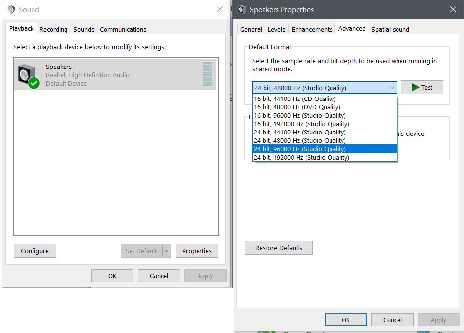

The hardware SRC allows best performance with the slow-roll off minimum-phase reconstruction filter. If anyone wants to see what that sounds like there are some wav file examples here: DBX that have been software upsampled, or not. To me, the 24/96 upsampled CD rip sounds quite a bit better than the 16/44 version, especially with J3 installed on 1.06 version Chinese DAC to select the slow filter.
***EDIT: If listening on a Windows PC, you may want to be sure the shared sound output is set the the sample rate and bit-depth you want to play back, or Windows will perform real-time SRC on your audio stream making it sound worse than it should. I will post a screenshot below showing how Windows sound may be configured.

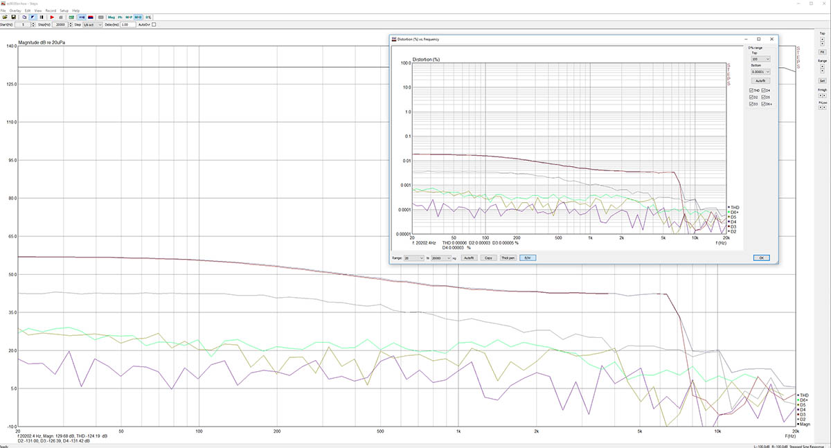

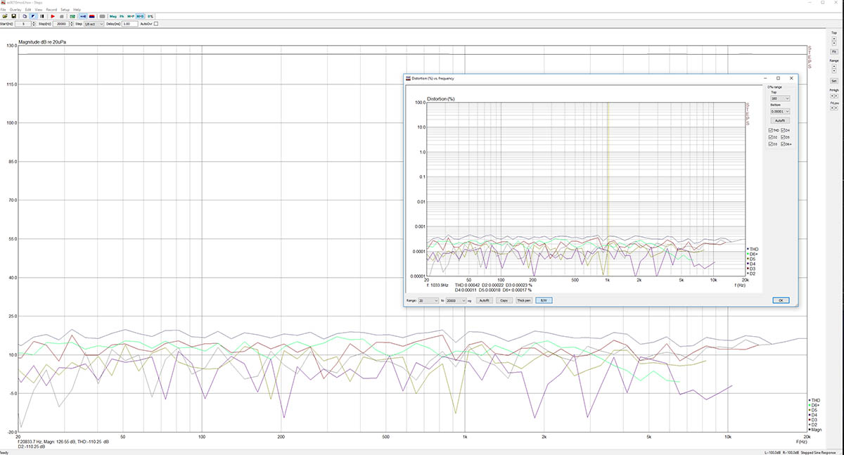

Update & nice to know.
The ES9038 apparently doesn't like to push against a zero Ohm load, but prefers a bit of resistance. I first scanned from 0-500 Ohm with a pot meter, and everything larger than 30 Ohms or so made things worse, but below it, there was considerable improvement possible.
I went down from 10 Ohms to 2.7 (in series with both legs of the DAC output on one channel), and distortion continued to improve:
BY ALMOST 6 dB (above 200 Hz and as compared to a 0 Ohm load).
Then I soldered in 1.2 Ohm resistors to go even further down. However, when I wanted to measure the results, the board froze on me. Both DSD and Lock leds light up at the same time and that will be the end of this experiment.
Curious to find out if the same improvement can be made with the 9018 board in this way. That would really make it spectacular for the price.
