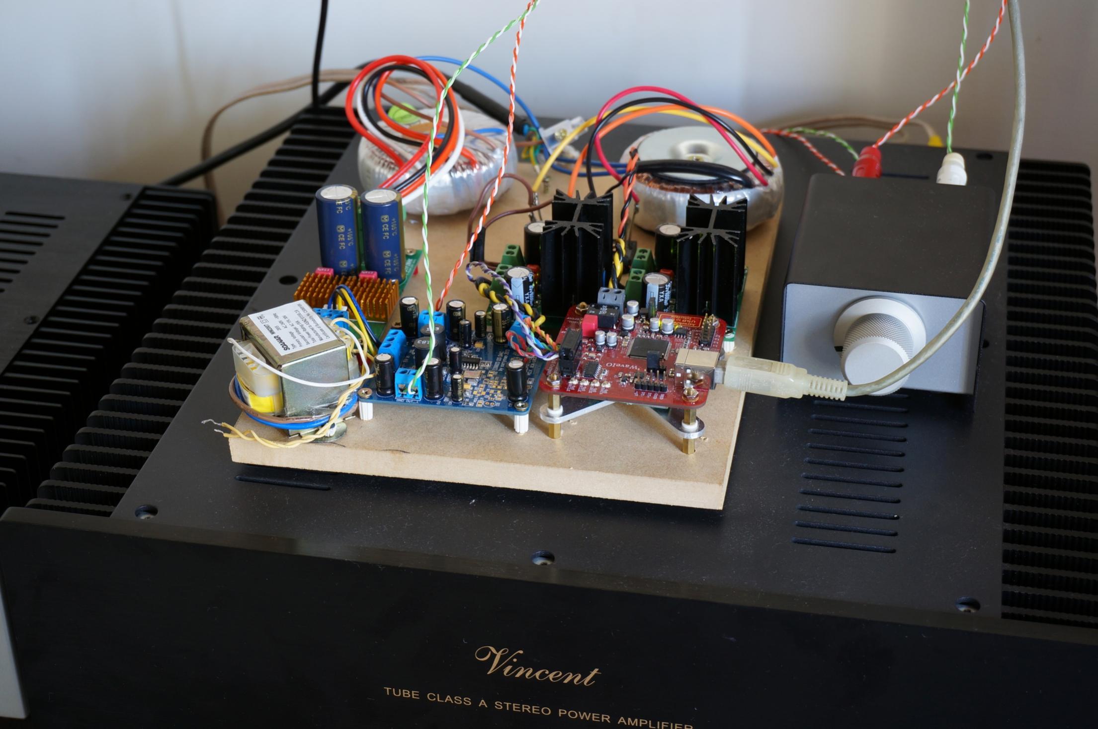

It's all on a tray at the moment but you can see it here
The 5V supplies are 7805 based, large heatsink on the one for the Pi. The +/-15v is a 'servo' PSU from eBay (LM317 LM337 Servo Power Supply Board product | eBay) using an LM317/337 combo and an op-amp.
The transformer is a 30VA R-Core and the Pi has an Edimax wifi card.
I'm still breaking it in but loving the sound, seems to be on a par with (if not surpassing) my clock-locked Cambridge IsoMagic s700 (RME soundcard slaved to the DAC's clock) which I've been unable to better for some years.
I'll be popping it all in a HiFi2000 Galaxy case once I've figured out the size I need and ordered it...
Cheers
Simon

I would like to thank Curryman and Joachim for such a wonderful DAC. Using Lorien`s wave IO as USB interface >I2S to Curryman`s DAC made by miniDSP. In my experience this is the best ES9023 implementation, very transparent. Actually it changed my mind on the Sigma/Delta conversion capabilities (I was multibit believer), well done Curryman!
One thing I would like to enquire is whether 10KOhm attenuator that I'm using is too heavy load for the JH buffer? What value would be ideal (amplifier input has 47KOhm impedance) ? Also I'm still unsure about grounding scheme in the future metal chassis... any links or pointers?

The Buffer will drive 10kOhm without any problems. Down to 2k will also be OK. With higher loads THD may rise a bit but I've even used my 100 Ohm Headphones for a test :cool:
Re the grounding: PE connected directly to chassis is mandatory. I did not connect signal ground to chassis and never had issues
