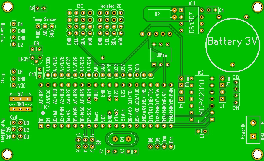

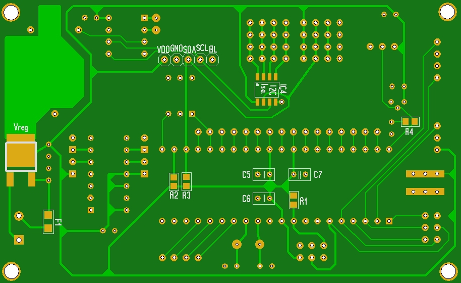

Long radio silence, I know. I've been very busy with all kind of different things, but also a little bit with the controller. Most of the PCB designing have been done, but I need to do some (more) breadboard prototyping in order to know all works like I want it to. I have been struggling a with the remote learning function when working with all the different RC protocols. I'm still not fully satisfied, but I'll get there.
I included a temperature sensor to the PCB, but I don't know if I want to keep it there. Perhaps it's best to have a outbreak with the sensor.
The LT1086 low dropout voltage regulator and a resettable fuse have also been included into the design .
I will post some more details and some pics soon when I find some more time to work on it.

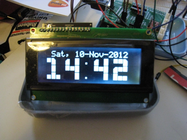

Almost there. I added a DIP switch to allow manual control over stereo/dual mono and volume control on/off. I have to do a few more tests (wish I had some more spare time), but I will order the first PCBs for the prototype this week for sure.
Here are some pics as promised. Also a pic from the RTC function that shows the actual time and date when stand-by mode is entered.
That is great. It looks flawless. Looking forward to seeing how it turns out.
I guess you stuck to using the i2c extender for the display connection after all?

The i2c extender. For now I´ll stick to using the extender from electroFUN, but in my final design I´ll incorporate a small IO extender to the design and use it in a similar way as the extender from E-Fun. The only difference will be the connections to the LCD. I will add a row of connectors that line up with the LCD's connectors. In my opinion this is the best way to connect the LCD to the controller.
