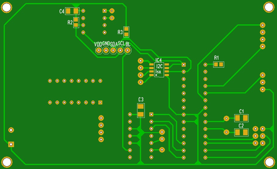

I'm currently designing a controller module for my ES9018 DAC (Buffalo from TPA), but it can be used with any ES9018 DAC when there is I2S access to it.
It will be based around an Atmel Atmega644 with a highly modified Hifiduino version running on it, so there is input selection, volume control and all settings (filters, quantizer, oversampling and more) can be modified.

Hey Corpius, that would be a nice project! :)
Some ideas:
1- Adum I2C isolator which does isolation and level conversion at the same time.
2- Rotary encoder with space for debouncing capacitors
3- Pot for LCD contrast adjustment (you only do this once)
4- I2C FRAM (FRAM is a fast EEPROM accessed through I2C. The built in EEPROM in ARduino is slow and has limited life)
is there any reason you stuck to arduino? wouldnt some more powerful sort of Cortex/ARM/Raspberry device that speaks i2c, USB, wifi etc be more suitable? or is it simply because so many of the required instruction sets/codes are in existence for arduino->ESS
nice project regardless
yeah qusp, it is just a whole lot easier to write the code for arduino and get something that works, reliably.
I am having some hassles getting i2c from default beagle bone linux os at the moment (also got smashed by work and didn't look at it for a few months). I am proceeding with arm based board because I want it to be independent of the computer and just stream from the networked storage. I also want mine to be network controllable eventually. The networking side is the more expensive part to get working with an arduino as the wifi/ethernet sheilds are expensive/bulky and drivers for a fat/fat32 fiilesystem to store graphics etc can take up a lot of the atmel microcontrollers memory.

To make some things clear. I will use the same chip as the Arduino does, but not the Arduino itself. Therefore no shields could be added, at least not in the same way as with the Arduino.
Some ideas:
1. The Adum I2C isolator is indeed a very useful component. I will add this to the list.
2. I can make some connections for a small separate PCB that houses the rotary encoder and debounce capacitors. This way there two possibilities for control, push buttons or rotary encoder. Good idea!
3. This is already incorporated into the design, but forgot to add it to the list.
4. Looks nice, but I'm not convinced that it is needed. How limited is the EEPROM lifetime of the Atmega328?
The Atmega328 is powerful enough for this project. Like hochopeper said, it is much easier to write the code for it and get something that works reliable. I already have an Arduino that is currently the control unit of my DAC, but I think that its design is too limited for what I want. I can add some shields of course, but then it becomes to bulky to fit inside my DAC. For that same reason I have already designed a shield that more or less fits my needs: Buffalo shield. The shield is nice, but is still a bit limited for what I want.
Built-in port expander? such as PCF8574 in case you need more ports for relays, etc. And/or a shift register to drive the LCD with this library: https://bitbucket.org/fmalpartida/new-liquidcrystal/wiki/Home. I feel the I2C option for the LCD is "too slow"
How funny is that. I also forgot to add the PCF8574 to the list as well. It is already incorporated, but thanks!
I planned to use the I2C LCD extra IO in combination with the library you mentioned. I am currently using it with my Arduino as well. It doesn't feel slow to me. According to the webpage you where referring to, the library should be almost 5 times faster than the original LCD library.
I have been busy with the design today. It is not final, but this is what I have for so far. The PCF8574 needs to be positioned to a better location and all connections to it are also still not drawn.

So using i2c for the LCD might be slower, but from what I am experiencing it is fast enough. I can`t notice any difference.
There will be some I2C outbreaks left from the DS1307 - real time clock. I will probably add I2C isolators to those as well. There will also be a row of digital I/O`s and some sensor inputs. These will all be added somwhere next to the MCP42010..
If there is enough interrest I might do so or sell it through my website. First priority is to finish the design and make a prototype.
I could do with some input for the design. I'm thinking of adding some function to put the entire DAC into standby, except for the control unit. When it's in standby it could show the day time, month and year with the backlight turned off. This could be achieved with a little add-on board that houses a logic controlled relais that switches the power to the transformers.
