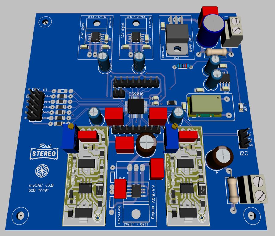

Hi all,
I have made this topic for my upcoming project, ES9016 multichannel DAC. There are not too much multichannel DACs on the market, but I need it to drive my active loudspeaker system correctly.
This chip is reasonably priced and has a simple layout (only 48pin) but still have good enough parameters to build an outstanding DAC I think....
A picture attached shows the actually stand of my pcb. I am in the idea collecting and implementig phase... I you have any advice, experience, please share it! Thanks...

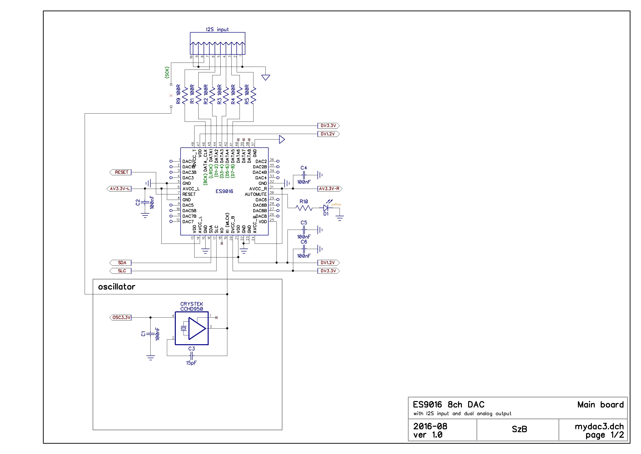

Here some schematics to see my power supply concept...
I desing 2 panels with 10x10cm. The top panel is the DAC pcb, the bottom panel will be the output filter pcb with I/V converters an filters, 8ch balanced and unbalanced outputs.
(There will be an option to use of an other filter pcb if only 2 channels are needed in parallel stereo mode, and perhaps with headphone amplifier integrated.)
My design is free, it means I have NO marketing considerations, make it only as a hobby. I share all my CAD-files if somebody needs it!

The input interface will be MiniDSP USBStreamer or nanoSHARC (DSP), if the 8ch plugin will be available.
Clocking option is a Crystek oscillator (e.g. CCHD-950, 100M) or it is possible to use the MiniDSP master clock (for testing it will be ok, but can be upgraded later too).
Control interface will be the Arduino nano (or similar). It is cheap and simple. I have to study up in this theme...

If its an open project, other experts might pitch in with guidance.
2 layer seems limited for such a project. A 4-layer PCB gives flexibility needed for best single integrity practices.
Have you tried KiCad? Another open source full featured PCB design tool used by many members.
9038 currently appears to be the DAC with best specs, but is expensive.
Have you considered latest AKM devices? Comparable performance at cheaper rates.

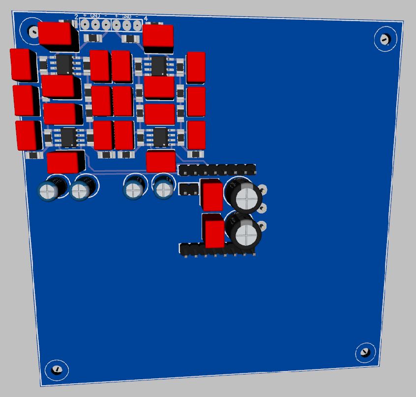

Concept for the output stage, 2 channels populated only with OPA1632 IC-s and balanced output.

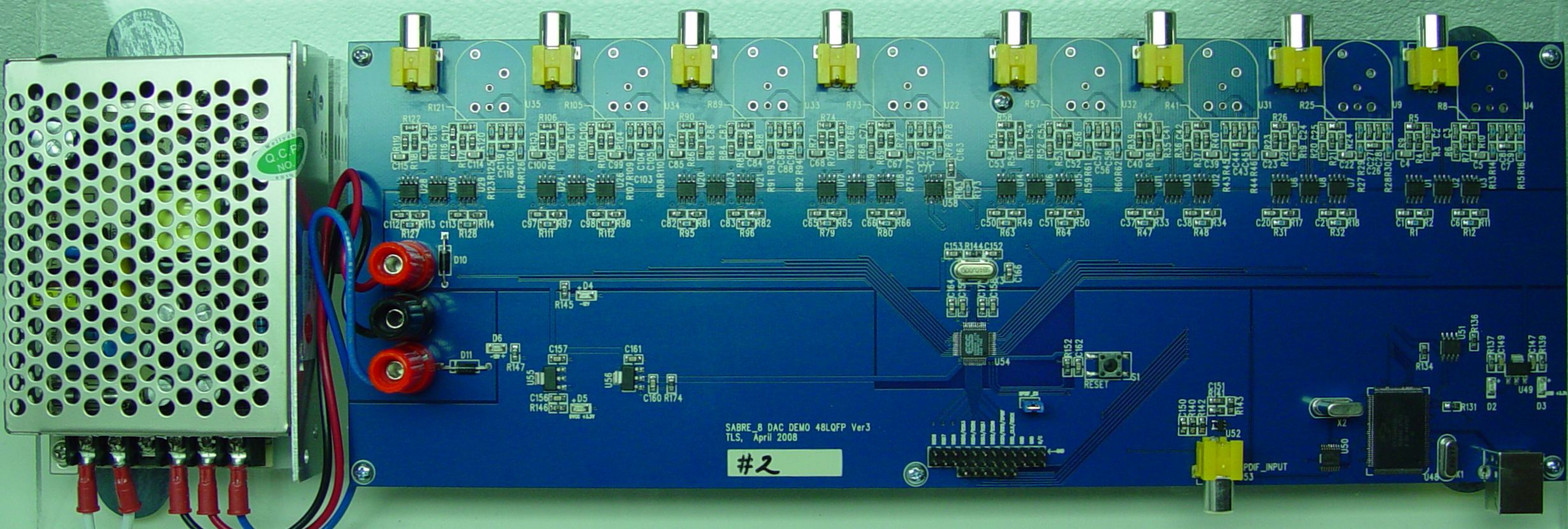

Nice. IV stereo circuit located on four quadrants for a total of 8 channels seems like a nice layout.
I saw such a layout with a multichannel es9028 design.
I have no experience with 4 layers, and it makes the production expensiver too. So I stay by 2. It is in fact limited but possible to do...
I do not know KiCAD, but I took a look at that now, and I must say: not for my taste. It is very unhandy (for me at least)! On the other hand, I have all my datebase and libraries in DipTrace. This program is very easy to use and has all the function what I need. So I will stay by this.
The problem you'll have with two layers is managing efficient power and clock routing while still keeping input and output cleanly routed. With 2 layers you will hopping between them quite a bit, and the ground planes on both sides will be quite broken.
For simple DACs with one or two supply pins two layers is quite doable, but when the supply pins start moving to the all four ends of the chip you really need to think about a 4 layer board with at least one outer plane as an unbroken shield, specially on the digital side.
In any case, the things to watch are very good supply decoupling and low inductance in the power supply. Most issues with digital DIY boards are because of sub-optimal power routing (for example, the DIYinHK boards which are totally hopeless in this respect). This leads to very poor conversion performance.

I can't see the PCB design but it seems you have focused much more attention on the analog part, with shorter signal traces and the double decker I/V. I would focus on the digital part as that is where the bulk of the issues crop up. For current output DACs the output stage is less critical than the converter supply performance, which will not be good the way you have it now.
