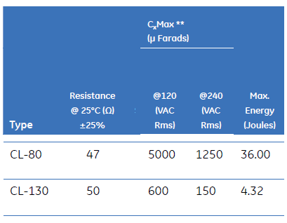

Easier (better?) to look at the max energy that can be stored in the ICL and use the formula for deriving the energy stored in a capacitor to work out the maximum capacitance for the voltage at which the caps are charged.
Energy stored in a capacitor (J) = 1/2CV^2 (where C is expressed in Farads)
Page 2 of the GE datasheet for Inrush Current Limiters (link) talks about the relationship between {energy stored in the filter capacitor} and {the datasheet rating for max_capacitance @ voltage}
To double-check that you understand the way GE are rating their ICL thermistors, see whether you can calculate the max_capacitance @120VAC rms for the CL-80, knowing only that the CL-80 is rated for 36.0 Joules, max. Does your calculated capacitance agree with the datasheet value? Repeat for the CL-80 max_capacitance @240VAC rms, given that CL-80 is rated 36.0 Joules max. Does your value match the datasheet's value?
Repeat for the CL-130, rated 4.32 Joules max. What's max_cap @ 120VAC rms? What's max_cap @ 240VAC rms? Do you match the datasheet?
Once you're able to replicate GE's calculations, you can now compute max_capacitance @ XYZ volts AC rms, using only the max Joule rating and your understanding of GE's calculation procedure. For any XYZ voltage you choose. Even the transformer secondary voltage.

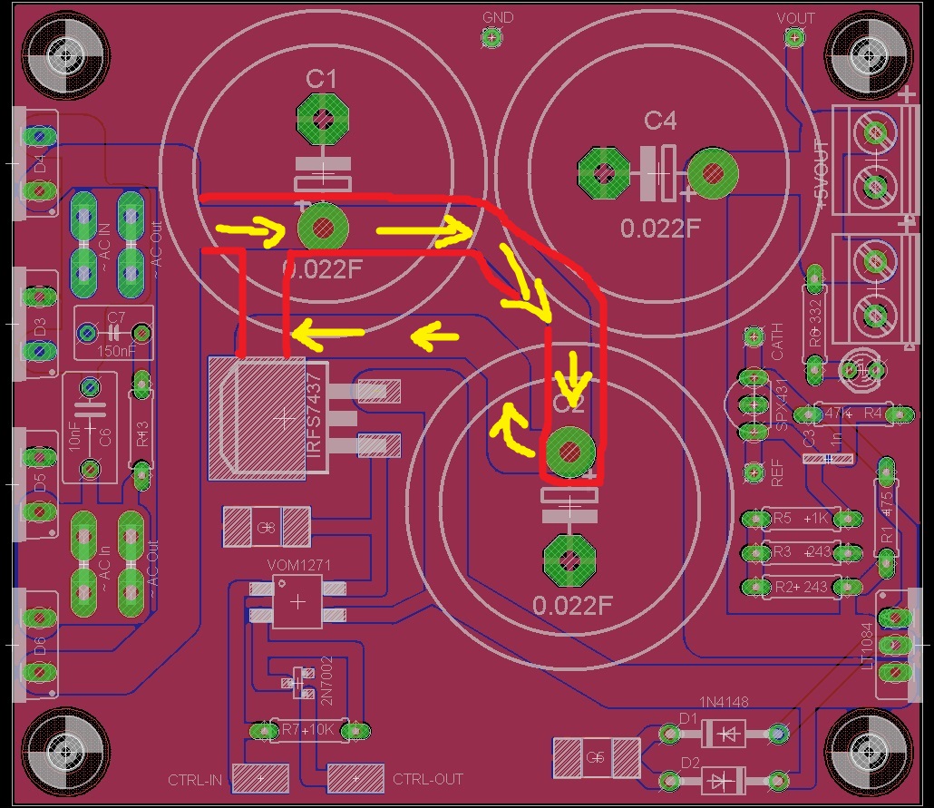

Assume the PCB track resistance is 4 milliohms per inch. Create two schematics showing the two layout options INCLUDING the PCB track resistance.
Do you prefer one schematic over the other, aesthetically?
Run them in LTSPICE. Does one schematic's performance please you more than the other, even by half a percent? If so, why not use the layout that's 0.5% better -- the cost is zero so the (benefit/cost) ratio is infinity.
ok but my question is whether, other than trace length/resistance, are the two circuits functionally the same? I know this is incredibly basic but conceptually I still follow schematics from source to output and worry when the board doesn't follow the "flow" of the schematic. I presume this is a hump I just need to get over but I'm unsure.
Hmm. My cause for nervousness. But.... another example which would seem very analogous: the DIYAudio Universal PSU board. http://files.diyaudio.com/forums/gallery/data/500/medium/PSU18.jpg Schematic is C1->C2-> resistor bank -> C3->C4. Yet C2 is on a spur from C1. The trace doesn't run from C1 to C2 and from C2 to the resistor bank. It's quite similar to my markings in orange. If one thinks in nodal network terms the two are the same (the elements C1, C2 sit on the correct side of the transistor - how they are connected, ignoring trace resistance, is irrelevant) but if your mindset is 'flow' (from C1->C2-> transistor) then they're not. Hence my question, even if it is a stupid one.
One way to experimentally "ignore trace resistance" (or more generally, trace impedance) is to use .PARAMs in LTSPICE. The "LIST" option allows you to run three or five or twenty simulations with different values of the params, and plot all simulation results overlaid on the same output graph. You can step the trace resistance/impedance from high to medium to low to near-zero, and see the effects (if any) upon circuit behavior.
PCB copper trace resistance "calculators" abound on the internet; all you do is input the thickness of your copper layer (in oz/ft2), the width of your trace, and the PCB temperature. Then, presto, they spit out the trace resistance per unit length. It might surprise you to see that one inch of PCB trace has a greater resistance than SGK's MOSFET switch -- but it does. Really.
Copper trace impedance "calculators" are also online, but less numerous. They cover microstrip layouts, stripline layouts, and coplanar waveguide layouts {Wikipedia discusses each of these}, and spit out inductance-per-unit-length, capacitance-per-unit-length, characteristic impedance, propagation velocity, and so forth. If you want to simulate impedance instead of resistance, these can help.
I myself would use the methodology outlined in post #115 to decide between the two layout styles. I might even vary the trace resistance above, and below, the real-world number, just to see whether the difference between the two layouts becomes shockingly huge if we make PCBs traces out of high resistance tungsten (or out of zero resistance superconductors). Maybe LayoutX is vastly superior to LayoutY in one of these what-if scenarios, despite X&Y being nearly-indistinguishable in the copper trace scenario. It's likely I would choose X rather than Y for this very reason. But hey that's just me.
