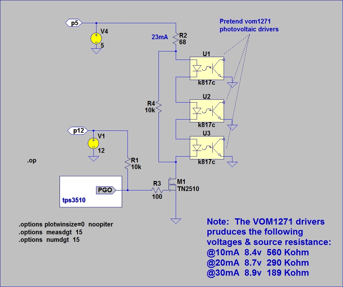

I was just reading the TPS3510 datasheet and came to the same conclusion.
Cheers ,
Rens
Paul/Rens
Thanks for this.
Perhaps I am mistaken but I don't think PGO can be pulled up from the 12V supply. The max recommended voltage in the datasheet for PGO is 7V and the ATX spec calls for a 5V (TTL compatible) signal to the motherboard (from PGO). The TPS3510 can sink up to 10mA maximum through PGO when held low.
The TN2510 has a low Vgs(th) of 2V which would seem to be good. I need to track down a Spice model for the TN2510. If V1 is 5V and R1 500 ohms (R3 removed) Vgs is 5V, as Andrew has noted little current is needed to charge the gate, your use of R2 and R4 means Vds is still 5V... It seems all ok, no? Is my logic/analysis correct?

Since there is only one "ground" for the entire circuit, and the photovoltaic couplers are not being used for galvanic isolation of two independent subsystems with different "grounds" ...
It seems to me you could save a lot of money on parts by building a straightforward, DC coupled signal booster. Just a logic inverter with level shifting. Use the 5V digital signal "PGO" on TPS3510 pin#8, to create a 12V digital signal "12V_PGO_inverse" with a very low output impedance / very strong output drive.
Then you use "12V_PGO_inverse" to drive the gates of three Pchannel MOSFET pass transistors. You're only passing 5.0 amperes of current; for that, you can fit the very low-cost SMD device IRF9317. Its dissipation will be IxIxR = 5x5x0.007 = 175 milliwatts, well within the device ratings even when the ambient air is 70 degrees C. And it's in the SO-8 gullwing package which is quite easily hand-soldered; there's no ground-slug beneath the package body that requires oven-reflow soldering.
You don't need to pay for expensive photovoltaic drivers, you don't need to pay for expensive 1 milliohm FETs, and you don't need to drive high capacitance from a scrawny TPS3510 5V digital output pin.
In this arrangement, the weakest link will be the 3.3V pass transistor, since it has the least Vgs. If that frightens you, and it shouldn't (see Figure 1 of the IRF9317 datasheet), just connect two (or more) pass transistors in parallel. This reduces Rds_on by a factor of N, which reduces the voltage drop across the composite switch by the same factor of N.
Or, if you absolutely insist upon using big, expensive, thru-hole Nchannel pass transistors ("high side switches"), you could buy high side switch driver ICs for a lot less money than photovoltaic isolators. The Micrel MIC5014, with on-chip charge pump, is one possibility. Price is 50% less than VOM1271 photovoltaic isolator AND it was purpose-built by expert designers, to drive a big whomping MOSFET.

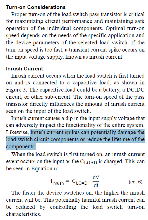

I had about an hour this evening to do a bit more reading and came across this article Using MOSFETs in Load Switch Applications. Fig 3 would seem informative with EN replaced by PGO. What might be a suitable small-signal NMOS transistor for Q1 and what would be the disadvantages of this versus your proposal of a DC coupled signal booster?
I note also the article's comments regarding the impact of Rds(on) on output voltage and its load dependency, and the noted disadvantage of P-channel MOSFETs in this regard. Is it worth worrying about this?

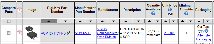

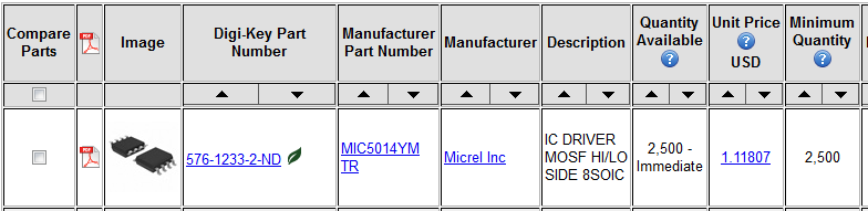

On the other hand, I don't know where Mark Johnson has his prices from, perhaps better than my on-line lazy choice.
Mouser shows the Micrel 5014 as just a little more expensive than the VOM1271 rather than cheaper. And "expensive photovoltaic drivers" ? Mouser price is less than $4 each. So photovoltaic is hardly a bad solution, even if you need three.
Probably more a case of choose what you find convenient.

I'm not chomping at the bit to use photovoltaic Mosfet drivers if they don't offer compelling benefits. I had thought it advisable (and I was thinking isolation was the driver of their use in the amp PSU even though I doubted this due to the common ground), but it seems in this case they're a waste of space. If they can be dropped then it seems things would appear to get simpler fast. As Andrew has said a few times, I don't need much current.
I could probably use a circuit like Fig 3 in the article I linked to: PGO goes high presenting 5V to the gate of a low-current/small signal NMOS transistor which turns on, the gates of 3 P-channel load switches (1 per voltage rail) go to ground and the switches turn on. Or, could I not use the small signal NMOS transistor as a high-side switch to present 12V to each of the gates of 3 N-channel load switches when PGO goes high and turns it on, thereby turning on the load switches. I will try to model each this weekend.
On the PMOS versus NMOS decision, my hesitation here - quite probably ill-founded - is that even though this is a low-current application versus a power amp, a variable load induces volatility in Vout. If the only cost of NMOS is equialent to a pint of beer and the slightly extra space of TO-220 (NMOS) versus SO-8 (PMOS), why not opt for the NMOS setup given the 12V rail is available? Unless, of course I am missing something re the high-side setup...

Possible solution with PMOS transistor switches placed after the input caps but before the regulators of each supply rail (other than V5SB)? FPO going low becomes the trigger. FPO can sink up to 20mA (and rated to 15V). When FPO goes high the pass transistors turn off.
In-rush for at least the supply output caps would have to be managed. Presumably the regulators will do their best to correct for the transistor resistance. Rdson is particularly an issue for the 3V3 rail as Vgs is lower. The IRF9310 would seem to have slightly better specs in this regard than the IRF9317 but the problem remains. Of course the rail voltages ahead of the regulators will be higher than shown here and hence Vgs better.
