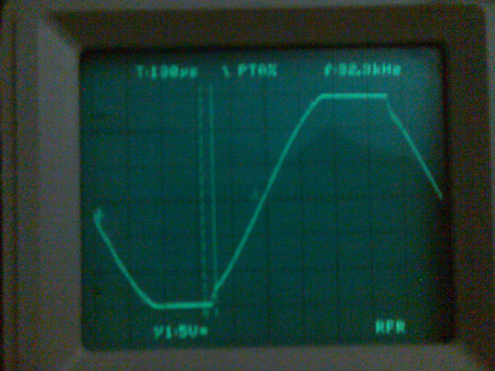

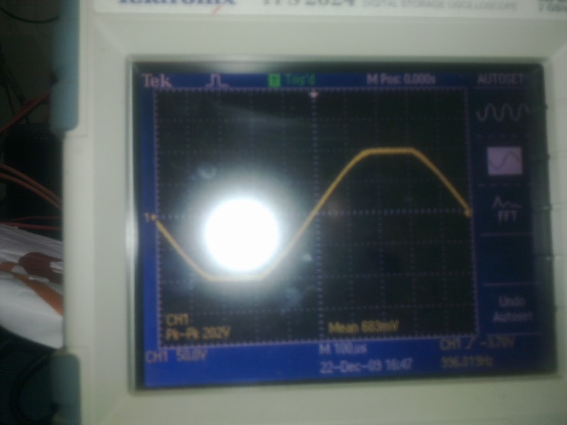

A poorly implemented Class-D by those "Engineers" who think designing a switching amplifier is same as linear amp.
The result is obviously as crappy as one could expect.
Whereas,
When things are neatly engineered, the results[My 5KW CLass-D] are somewhat Cool
Whereas,
Whereas,

Evita, its not "Preclipped" at input or anywhere else , i use another technique to get STICK FREE CLIPPING
The output signal shown by Workhorse is pre-clipped, it's a valid method to obtain clean clipping, but it does not reveal actual amplifier behaviour.

would you be able to achieve the same results in clocked design with 25-30 dB of loop gain at 10kHz?
Yes, but in my clocked modulator the magnitude of loop gain is somewhat different at 10khz.

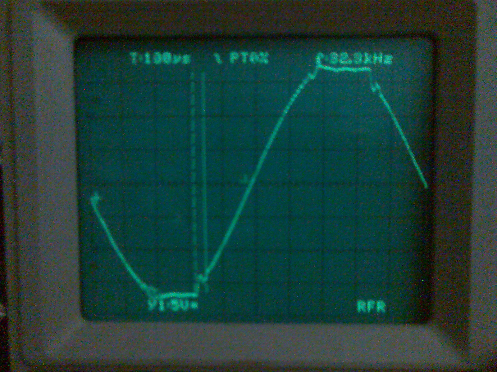

The usual method is clipping error amplifier (integrator) output to 5% and 95% duty cycle, as seen from the input of the comparator. In fact, sticking is prevented more or less in the same way in self oscillating circuits.
These images show 1khz clipping on a class-D full-range prototype employing my self-oscillating concept. Scale is 50V/div (10:1 probe). First picture is taken with no load at all and limiter disabled. Second picture is taken with 2 ohm load and limiter disabled too (150V peak into 2 ohms result in 11 kilowatts peak power ).
Note how the control loop damps output filter ringing almost immediately when the unloaded amplifier recovers from clipping, in other words, loop transient response is good. The artifacts on the waveform are all above 20khz. Sticking only lasts 20 microseconds. It could be further improved, but circuit complexity would increase quickly, and once the limiter is enabled only very brief clipping is allowed, so it's not worth the effort.
BTW: No RC zobel is used at the output.

Thats what you thought i might be doing, but it wasn't, the trick is in the feedback loop itself which gives me STICK FREE CLIPPING
Note how the control loop damps output filter ringing almost immediately when the unloaded amplifier recovers from clipping. The artifacts on the waveform are well above 20khz.
Once limiter is enabled, only very brief clipping is allowed.
With your sooo much effort , Sticking is still Visible there in your waveforms
look at new version of UCDs their clipping also appear cleaner than your waveforms.

My "sooo much effort" for preventing sticking at clipping only turned into two transistors and four resistors in this prototype. There is not much room in the PCB

Before someone will be ashamed, it is needed to know first, how deep is your loop gain at various frequencies, and whether you use an integrator at all... It is very easy to get "stick free clipping" with small loop gain, I would say (or without any feedback at all )
But if you really use some high order modulator with such advanced clipping behaviour, then indeed it is a good job...
