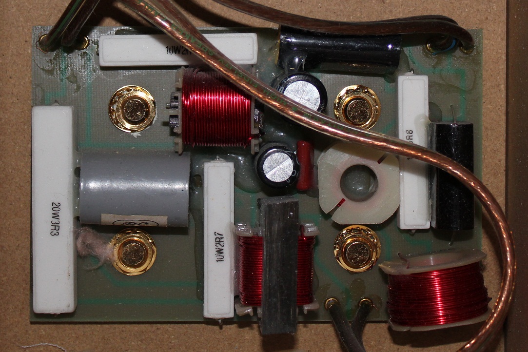

Thanks Miles, that confirms it's what I said earlier: those caps are part of a Zobel network.
yep, if you actually think it through, it's a bandpass filter, focused on a very specific frequency range, and with the 15,7.8 ohm resistors in parallel with each other, effectivly making it 5.1 ohms accross the speaker at those freq's -- makes your amp happy
the 2 inverted 1200uF's threw me off
mundorf supreme resistors (20W)
I notice you have 10W resistors. Did you change them to 20 as well?
Did you find exact values for your coils? Is close enough, good enough?
From what I understand cross branches are not as important. In my lower and upper woofer thats where everything is with the exception of two coils. I understand the two 1200uf caps are not that imporatant to swap out.
Does anyone know if the other three cross branches are worth upgrading or are they not as important as the two 1200uf caps?
Any help would be great
midrange inductor
finished the midrange inductor (.85mH), also the bass inductor is there (2.0mH)
also a pic of the original removed inductor
and, I had to unravel it to get to ~ .85 mH

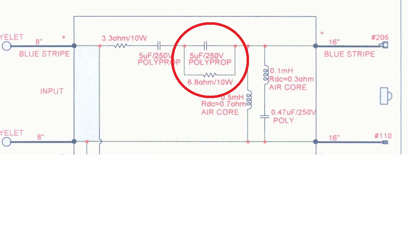

Energy Veritas Schematics:
V2.4
V2.4i HF
V2.4i LF
Hello, thank you very much for posting the schematics!
I have 2.4, these have 3 woofers. I am curious, if all 3 woofers are different drivers.
I can see all 3 woofers are crossed on different frequency, but are the drivers all same?
Schematic simply says Middle Woofer, Upper Woofer, Lower Woofer. No model numbers for some reason. Normally schematics use the drivers model number, but not Veritas.
I emailed Energy, no reply.
Does anybody know what are the woofers used in 2.4? I really need model numbers! Searching ggl fir last 2 hrs got me nowhere.
Maybe you guys can help!

Hi, all the woofers are the same, although the crossover is asymmetrical. The woofers were made by Energy and are no longer available, however new old stock drivers do come up for sale on eBay from time to time. I found a Seller in France last year who had 5 or 6 spare drivers for sale. Also Energy replacement parts were very expensive. Note that the Veritas 2.4 uses different drivers than the 2.4i. Here's some info from an old Canadian price list of Energy replacement parts that I found online:
Energy Veritas 2.4:
Woofer model number: 4DR//51871
Price (Canadian): $251.16
Energy Veritas 2.4i:
Woofer model number: 4DR//51913
Price (Canadian): $300.84
I hope that helps!
