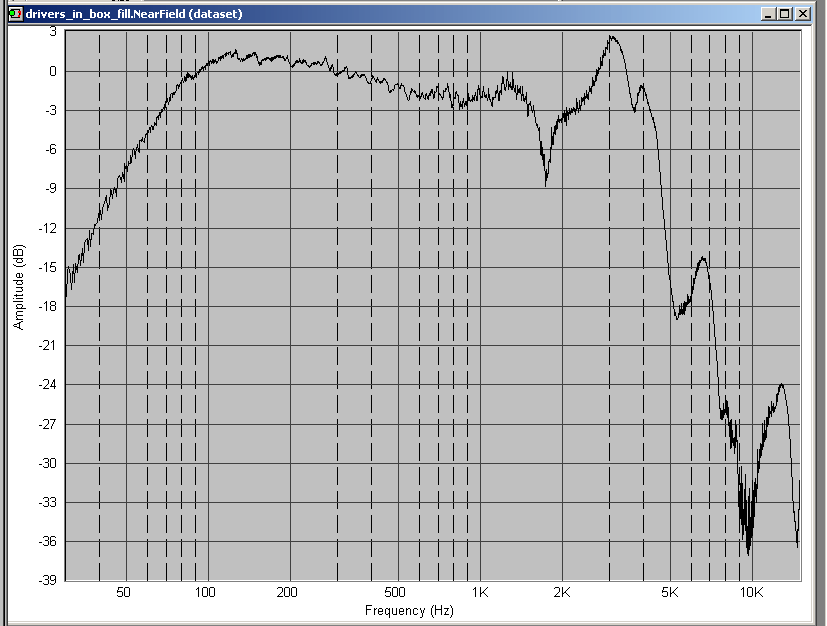

Well I fired up speaker-workshop, man did I do a lot of measurements.... Unfortunately I don't have measurements done at the same time for with filling, and with the pyrotek damping. They are in separate speaker-workshop files so I can't put them on the same graph (not that it would necessarily be a valid comparison anyway.
It looks like the filling did damp the reflections quite well, but as I said before I didn't care for the resulting sound. Anyway for completeness here is the graph of the box with filling. The most interesting thing to me is the complete change of behaviour at 2K... I'm going to have to do some more tests now! I did note also that I had done some tests with the soundsorber on the top and bottom which also had an effect around the 2K mark...
I also changed mic's a few times so whether this result is directly comparable to the first graph I posted is questionable.
I will do some more tests over the coming weeks and post the results. I'll be careful to make certain all drive levels are the same and mic positioning is as close to the same as possible

edit: the second graph is the one that I am mentioning the complete change at 2K... note both these graphs I had noted as being with filling..... go figure...

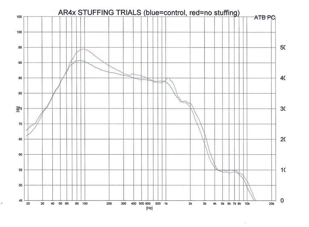

100% wrong. Thanks for spreading disinformation. Increased volume and lowered fs is a side effect and not the point of stuffing. You should have left the foam in place.
We're both right. In a closed box, system stuffing does both functions (e.g. damp standing waves and increase the effective box volume by increasing the compliance). Thirdly, the system Q can be controlled by the amount of stuffing. In a given closed box system, system Q's in the range of <0.5 to >>1.0 are possible with varying amounts of stuffing. The 'tightness' or 'looseness' of the bass sound is a function of system Q. Tightness is associated with lower Q. Looseness or more 'boom box' sound can be had with Q's well over 1 - All with the same volume box and driver. Attached is a NF response test of an Acoustic Research model 4x acoustic suspension speaker done as part of a larger stuffing study I conducted. The blue line is with the original rock wool stuffing. The red line is with the stuffing removed. The benefit of the stuffing is clearly evident in the flatter hump at system resonance (lowered Q as well) with is lowered appaox. 10 hz and, also the attenuation of the just over 1 khz hump in the response. This speaker certainly wouldn't be considered 'critically damped', I suspect, by design to yeild a warm, overall tone many AR enthusiasts love.
Granted, stuffing mitigates stanting waves, particularly at the upper range of a woofers response curve. However, most woofer's response are normally attenuated in the upper range with series inductors designed to mesh the response of the woofer's smooth pass band with either a tweeter or midrange element. OTOH, if you are designing a speaker with a woofer having no series wired coil, then certainly it would be judicious to address the higher frequency standing waves that could indeed be audibly noticeable.
BTW, the 4x used in the study did have a series coil with the woofer in the crossover.

Id have thought that +- 6db around the 750 Hz mark (as shown in post #31) would be well and truly audible... Admittedly I only measured it bare and then again with various materials damping it. I did not sit down and extensively listen to see if I could hear the difference between bare and damped. Also that measurement is nearfiled, but even so it clearly shows a large difference between damoed and undamped. I was not able to get decent measurements at 1M due to too many reflections so I can't offer any evidence as to what the difference would be at a more normal distance.
The one time I did notice a difference (audibly) was with the stuffing, but this was over three years ago, so my memory might be failing me, and it is quite probable that I over stuffed in order to get the stuffing to be as effective as the foam. I do seem to recall adding more and more until I got measurements with the peaks damped significantly.
edit: the cabinet depth is 211mm which is approx 1/2 wavelenght at 810Hz... Note that looking at the graph again the peak is close to 800Hz.
Tony.
