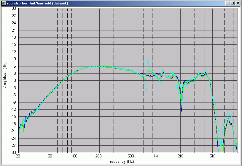

I'll attach here a picture of the test results of a number of tests I did on various damping materials. This was originally posted in this thread
Note that the measurements are nearfield, but regardless you can see a dramatic difference between the result with no damping to the box with just a single sheet of the material I linked to earlier in the thread.
Here is the explanation from the other thread as to what the measurements are:
Note that soundsorber barrier is the previous name of the material I linked to. Also this was only with one piece of damping material on the rear wall of the cabinet. all other walls were bare.
I also did tests on the acoustic tiles mentioned by RCW and from memory they were the worst of all of the things I tried. I'll see if I have any results for plain old polyester fill.
attached are my initial tests on bare, eggcrate and "soundsorber barrier" the soundsorber is the dark blue trace the bare cabinet is the light blue, and the eggcrate foam is the yellow trace. In this test the packing foam was slightly worse than the egg-crate foam, though it is a different cabinet to the one when I tested before.... as you can see the soundsorber is much more effective than the egg crate foam!

Hi, Tony, what do those different colors stand for?
