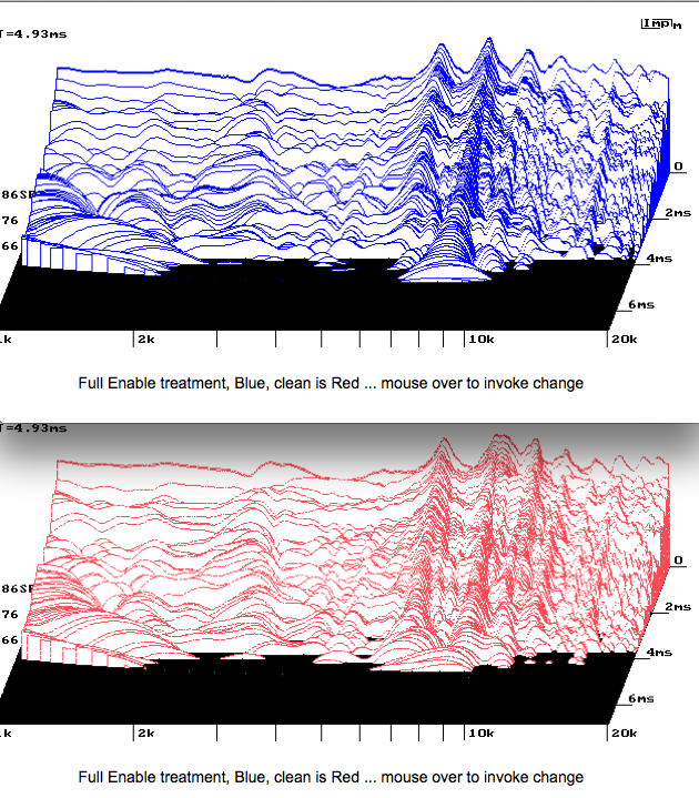

Definitive? As John K stated............".Compare A to D and B to C. Pretty obvious that the treated case really smears the response. This is particularly evident if you overlay B with C. I don't know how anyone would call that an improvement. It may sound different. Some may say it sounds better. Some may say it sounds worse. But while neither is close to perfect, in the A to D and B to C comparisons it is apparent that untreated appears more actuate with less time smear. I choose those comparisons because at low frequency A and D, and B and C appear more similar and I would expect such treatment to have little effect at low frequency."

A bit of background is due.
Enable Tests
is a project of John K. It is one of four tests he made using different methods of modifying the same aluminum driver. Unfortunately for all of us John cleared out his files and we lost three of the test graphs. Those three were, suspiciously for you cabal seekers, not EnABL at all. None the less they were extremely interesting and as with all of John's work, very well done. The remaining plots were converted into the blink comparison you see. John K applied the pattern ('s?) himself and since he is a rigorous sort of person I am sure they were well done. This is the same driver by the way, for both tests.

Bud,A bit of background is due.
Enable Tests

So it would appear in almost five years and 1338 posts there is only one before and after comparison of the same speaker, the one done by John K., the results of which show a near identical FR and impulse response, posted below.
And you oppose his view.
Thanks for pointing out his comparison.
Art
