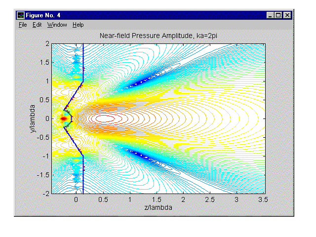

If you look at this figure from Art Ludwig's web site
it shows the near field pressure from a cone driver at a frequency with wave length equalt to the cone radius. It appears to be very complex but it is calculated using linear theory. Here is the far field radiation pattern
It is clear in the near field plot that the pressure develops into this pattern as the waves move off the cone. It is a linear result though.

Thanks for the near-field pressure illustration from Art Ludwig's Website. Very interesting.
I cannot help but note that where Bud has empirically found the best position for his raised EnABL pattern to be applied is where the pressure gradations are green.
I have not seen a visualisation like this before and thus I cannot know the significance of any coincidence at this stage.
Going back to my earlier posting, I would love to see the pressure gradients when the radiating wavelength equals an odd number of half wavelengths wrt aperture/cone diameter.

Actually, they don't.... if you look carefully. And this is for one frequency only. I believe any perceived coincidence is just that.

For what it is worth, the added red spots here are where the rows would be placed on the cone, from Art Ludwig's site. The set in the middle area of the cone, from empirical applications, appears to need to be placed at about the 2/5's distance from dome joint to cone edge. These are soongsc's pattern set additions, arising from his testing.
It is quite interesting to me to see what is going on at that point.
