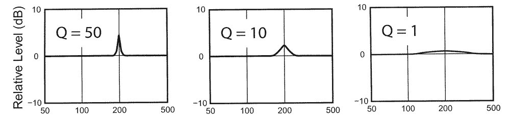

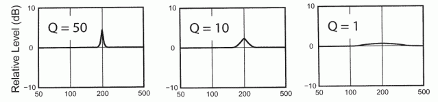

What does increase in Q mean here?
The Q here is the ratio of a resonances height to its width. Higher/narrower is higher Q,
Attached is a chart from Toole of 3 resonances at an equal detection threshold.
In each of the waterfalls are 3 significant ridges. In the EnABLed one these are narrower, and at least as tall, so higher resonance, and less audiable.
dave
