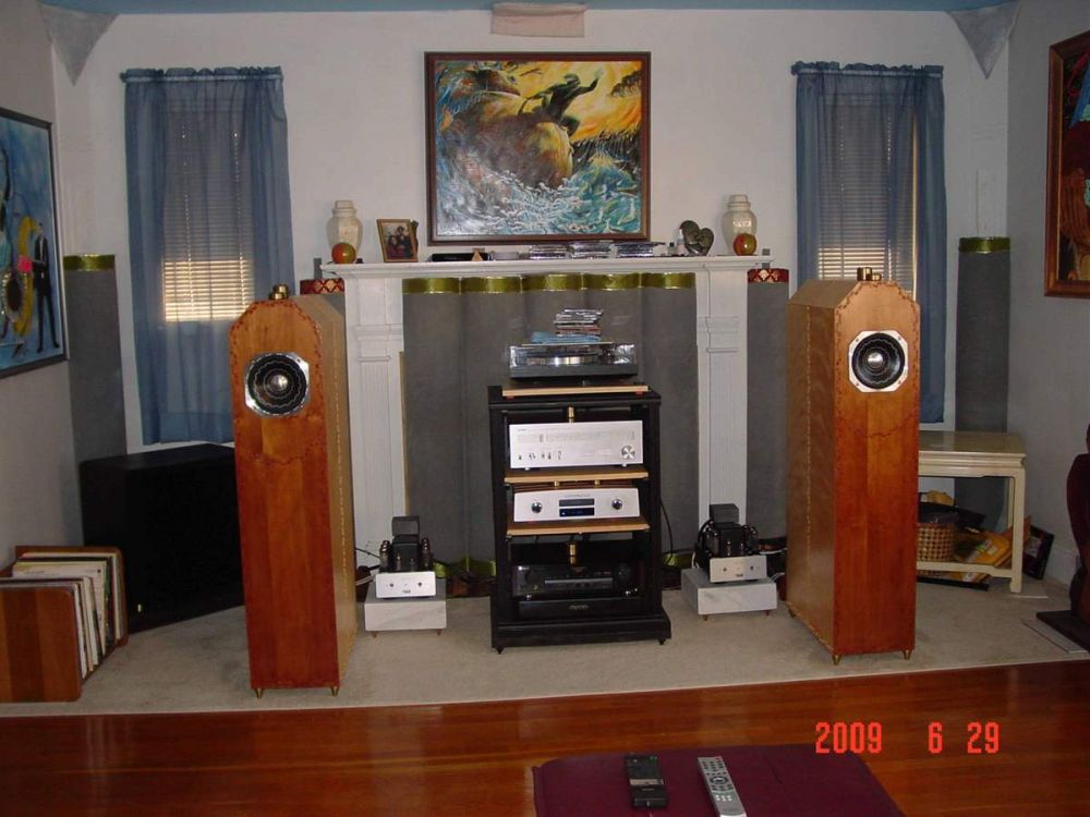

Here is a pic of Gilbert Young's finished listening room. Note that he has used room treatment in addition to EnABL room wall treatment and that the speaker cabinets are fully treated. He says that the music is wall to wall, floor to ceiling, perfectly proportioned and as close to live as he knows about, by visiting live venues.
Hi Rez pic is located at my picasa site here. Just look for the rest of Gilbert's pics, this one is at the end.
http://picasaweb.google.com/hpurvine

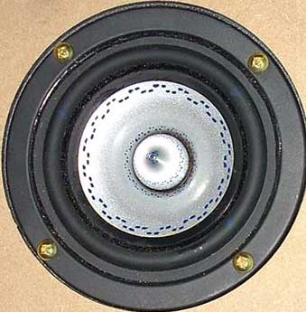

nukaidee said:enabl my tb871s
Poke me if i forget to post a higher rez picture... (these are my office speakers, just prepping to put them in a proper plywood box)
dave
whoa! you have one done! cool. so I guess it works? is yours paint? it looks more like a marker? Im actually debating that my paint is too thin and wont provide enough of a bump.. if you have a higher res one that would be even more awesome. im going blind counting the dots in your picture to make sure i have the same..
I have 2 pair done... the spots are standard pollyscale (blue in this case, csx grey on the others)... standard pattern ring at the surround, and at the dust cap. A ring pair as close as possible to the top of the at rest voice coil on the phase plug, a set just where it really starts to "fold" over and the 12 spot set at the top (+PVA nipple). 2 coats of 50% gloss on the cone, 1 on the phase plug (careful you don't getting any in the voice coil gap)
I just used my FE207 whizzer template IIRC.
dave
dave
nukaidee said:do i need / should i put a coat of microgloss on before i do the dots?
also your pva nipple is just a dot of glue on the tip of the phase plug?
what do you mean fold.
No
Yes
Where the shape of the phase plug really starts to curce
dave
alright. i will look one more time for that acrylic paint, if i can't find it i am just going to use a different type of acrylic flat paint. the paint i was planning to use is much to thin i decided. it just soaks right into the paper and doesn't sit on top. or is the paint supposed to soak into the paper? I have my template printed out to fill the cone, and cut out the center for the phase plug already. i think because of the large surround piece the cone seems much smaller than a 3"
