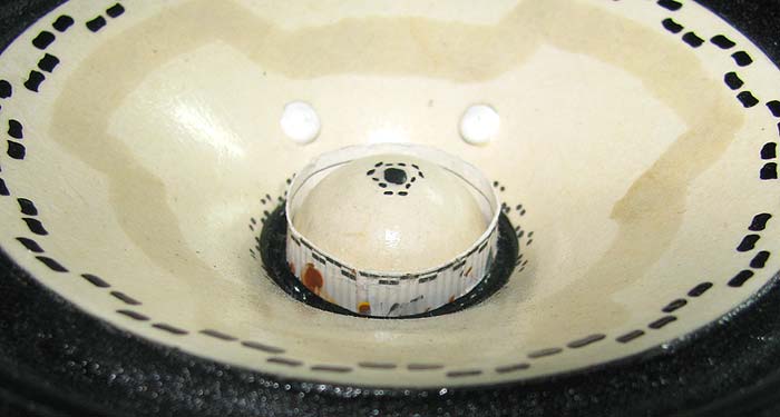

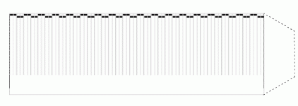

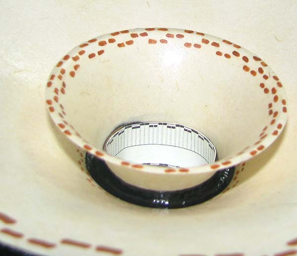

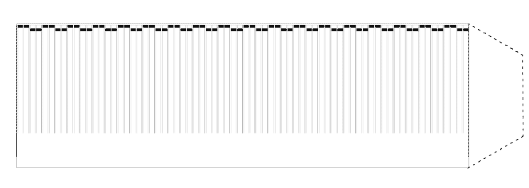

Bud's posting of the Jordan template reminds me to post the linear template -- this is one i developed for doing phase plugs but is also useful for doing the block rows at the dustcap juncture (and the bass of the whizzer in a phase plugged driver)
The template (a vector pdf is in the CSS FR125 templates)
dave
