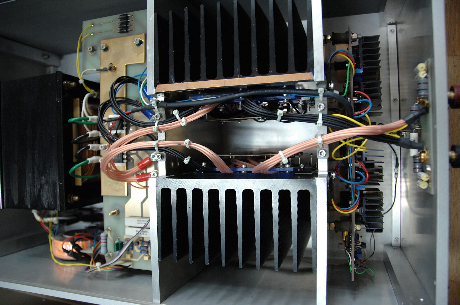

It seems that TB uses "long" cables to connect the emitters to the output binding post.

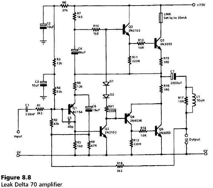

The below graph are excepted from John. L. Hood and D. Self's books.
leak delta 70 has omitted the emitter resistor from Q6. This will have an effect on the performance of the stage, probably for the worse.

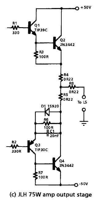

The J:H 75W has omitted both emitter resistors. This can reduce distortion at the expense of increased risk to thermal stability. this could be very good with the correct size of heatsink.
The un-named sch has omitted the emitter resistor from Q4. Same as the Leak, will affect performance.
Now consider the driver pair.
The Leak has an emitter resistor and Q5 on Q3, but Q4 has neither. The loading on the two emitters is very different. This will affect performance, again probably for the worse.
The JLH has Q1 with R3 and Q2 on the emitter. Q3 has D1+R5+C1 on the emitter these extra components are an attempt to load both drivers with the same impedance.
D1 is the Baxandall diode. C1 is the JLH capacitor. R5 is from Shaw if I remember correctly. Three stages of improvement to the quasi comp stage to bring performance upto and some would say exceed a complementary output stage for performance.
The un-named has both drivers with R1/R2 and D1 to mimic the transistor Q4. It is to the Baxandall style. Probably pretty good for driver loading.
Read up Shaw, Baxandall and JLH modifications to quasi complementary output stages.
Considering ONLY the driver+output as a stage, I would expect the Leak performance to be very different from the JLH. It may even be audible, or very audible.

the Shaw+Baxandall+JLH modifications are probably at the best of all the quasi output stages when set up correctly. That means the right diode, the right capacitor, the right resistor and the right currents.

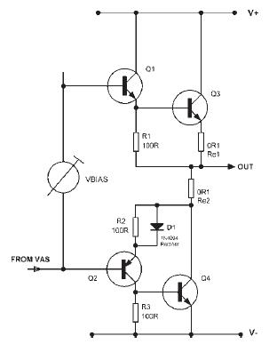

The unnamed graph is excepted from Chapter6 of D. Self's Audio Power Amplifier Design Handbook 5th edition. Some designs have the R1 in series with Re1, others do not. Any idea what is the difference and which one is better?

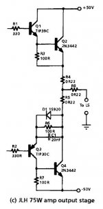

Andy,Thank you for your reply.
