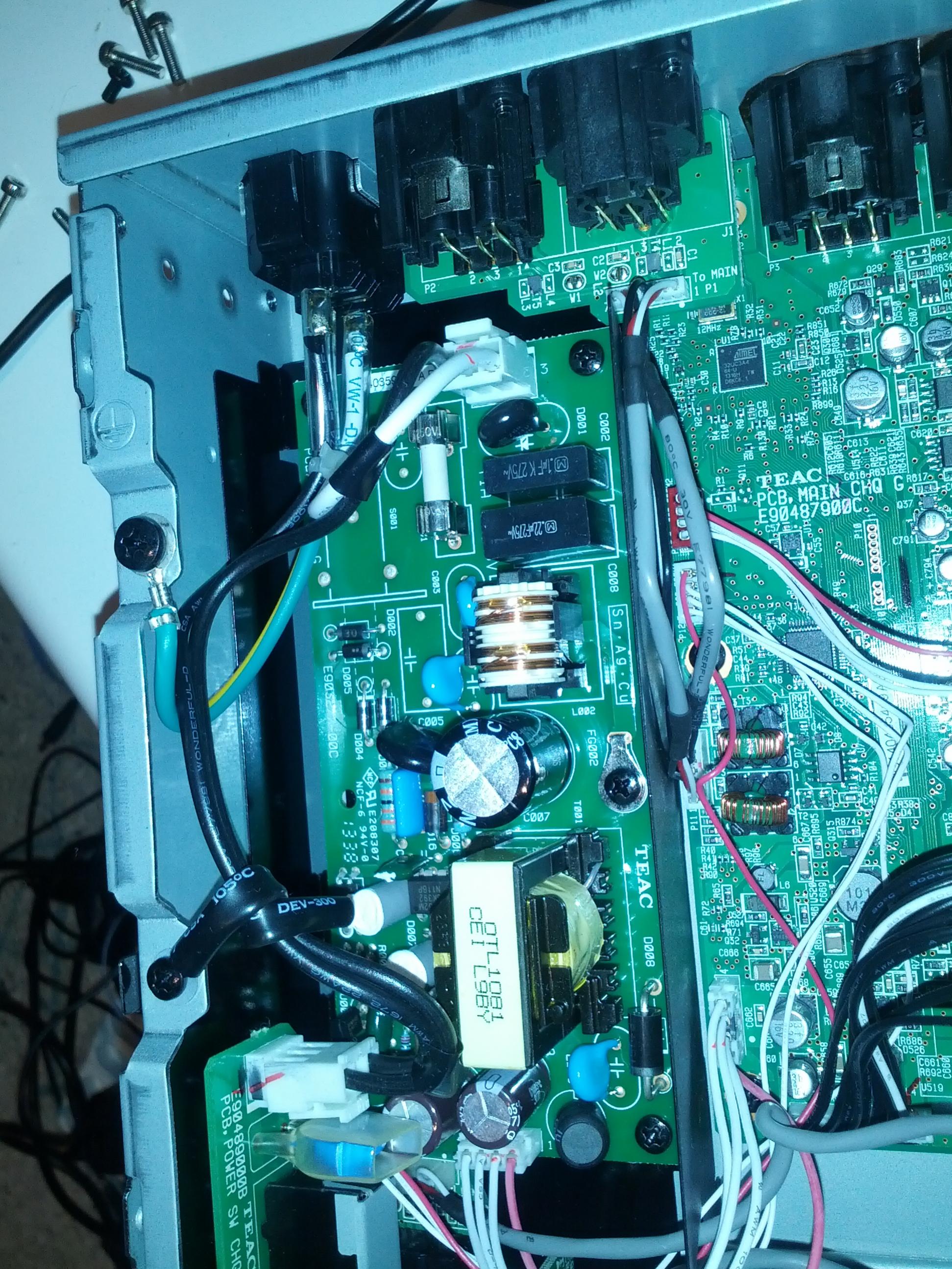

And this is one case in which a guy has been able to spot the problem.
A smps that used outside the box is perfectly fine but when placed inside the box causes some noise.
Maybe it is also some cable too close to emitting parts on the smps that acts like and antenna and discharge the noise in the pcb ?
When i will have the am radio i will try to place its antenna close to each components and listen for the buzz.

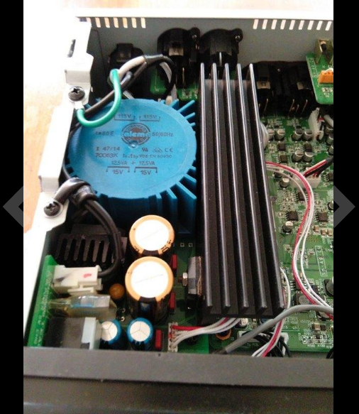

I found a guy who has replaced the internal smps with a new linear one.
My ideal solution would be a internal regulations stage and an external mains voltage transformer.

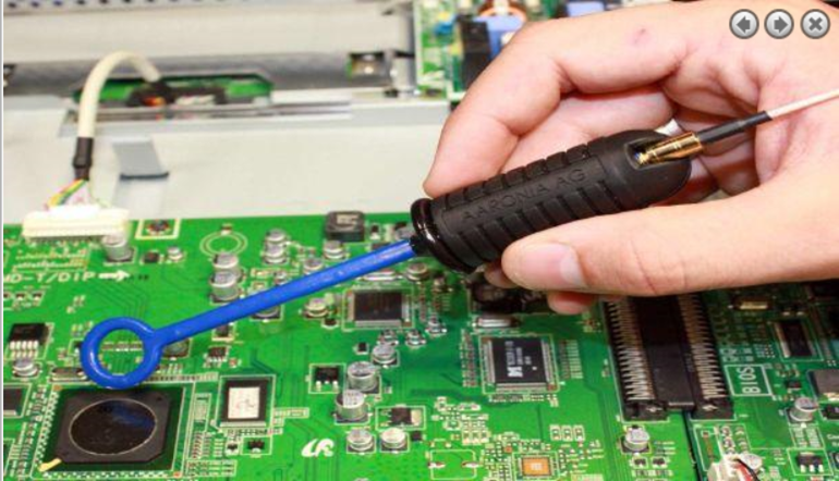

However i have seen indeed some EMI Probe Sniffer
RENTAL: EMI Probe Sniffer Set; DC to 6 GHz for hire Measurement Rentals
very very expensive and also a scope is required.
That probe is for the magnetic field, and such things are actually fairly easy to make from a bit of semi rigid coax and a small screening box, but you really need a spectrum analyser to interpret the results, and like all tools they are only as good as the person using them.
You seem to be under the impression that if you can just find the right tool the measurements and their interpretation is a simple thing, NOT SO.
Also you seem to be obsessing about noise 100dB down and out of the audio band, I have to ask why you care about that noise (Any mic that has a response up there will be hearing the acoustic whistle from all kinds of phone chargers and other small switchmodes anyway, it is difficult to get away from the things).
Regards, Dan.
