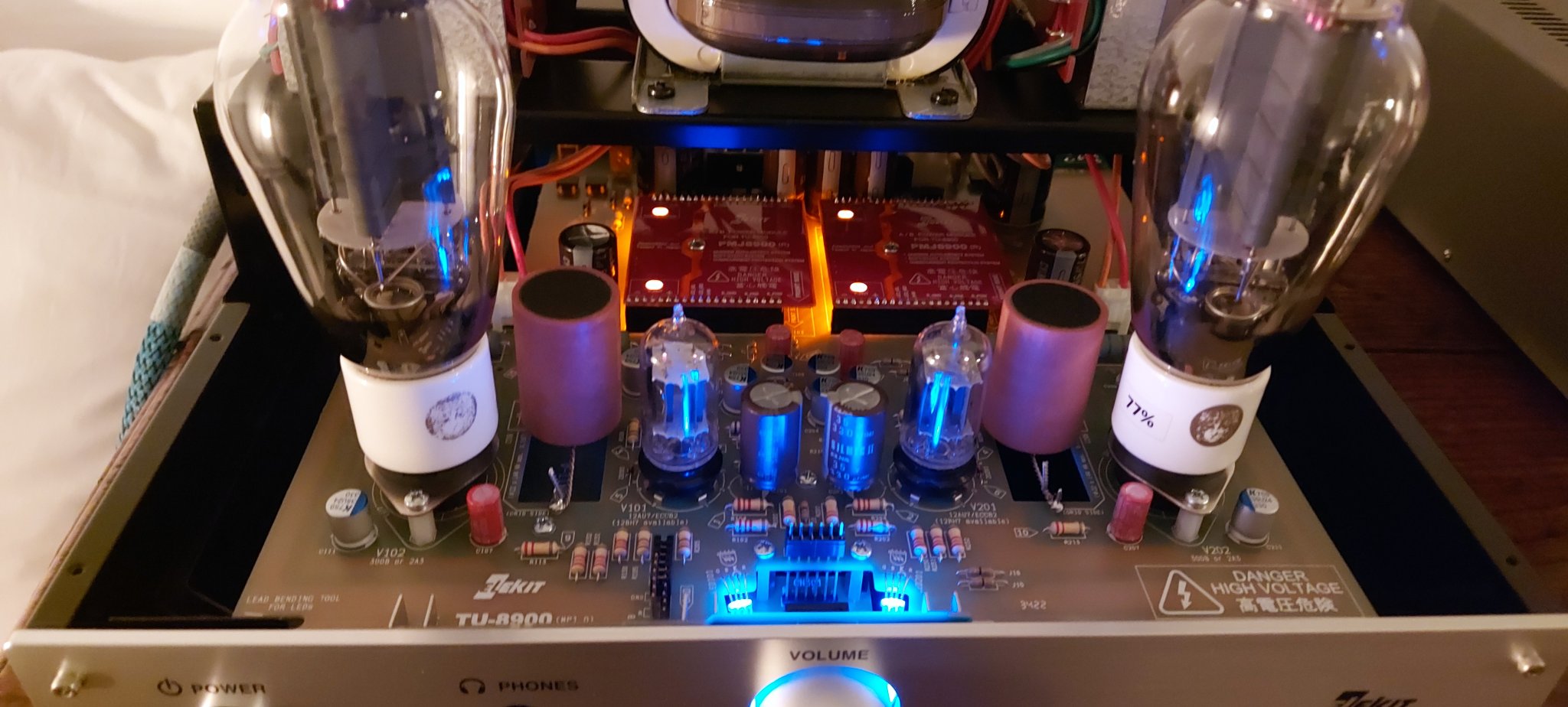

I think that you will enjoy this. Previous to building the TU-8900, I built an ANK (Audio Note Kit) KIT 1 15th Anniversary Edition 300B Amplifier with expensive upgraded filter caps and a quad-core output transformer. In addition, the ANK amp is using $2,000 TungSol 300B tubes. The TU-8900 kit was assembled as I received it from you, with several upgrades to the stock kit. I wanted to compare the assembled Elekit TU-8900 to my assembled ANK Kit 1 and hear the difference between 300B tubes and 2A3 tubes, and to hear which amp sounded better. If you look at the attached photos, you will see that the amps are connected with a speaker switch, so that I could easily A/B amplifiers. I have to admit that I expected the ANK to win.
The comparison:
Elekit Wins!! I will be selling the ANK.
I am really surprised at the outcome, and realizing that I have been listening to a less than audiophile experience for years with my ANK.
G
^ All well and good only he's telling us the difference between Elekit 2A3 vs ANK 300B, and obviously he couldn't do his A/B switching rig without a quad sets of matched 300B's, still I would have liked had he also compared Elekit TU8900 with 300B to the ANK 300B
