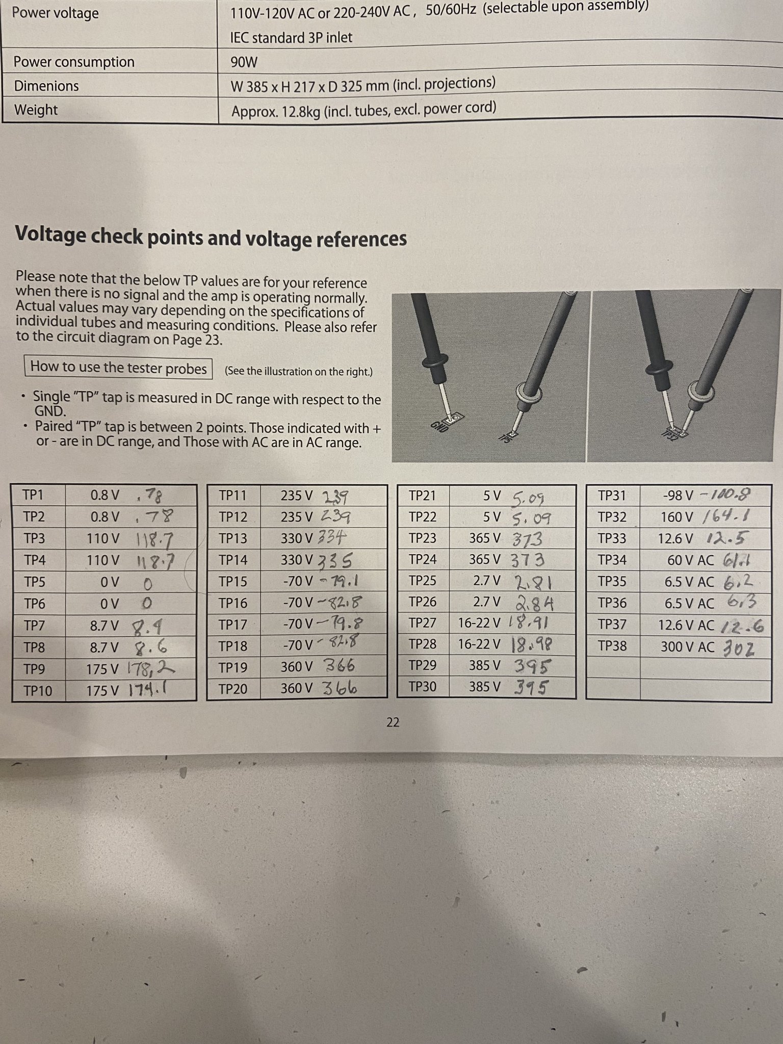

Victor do you see any problem with these values. I don’t know acceptable tolerances with this amp. Anyone else chime in?

TU-8600-S volume. I playing into Klipsch Heresy IV speakers. They are supposed 98db. Playing yo-yo ma volume at noon is less than concert level. How safe is it to play past 12.
I used my TU-8600S at 60% then 90% for a year with no issues but unsure if it was going to overdrive anything and possibly shorten tube life? and now use it at 50%. I use a High output level v previous Low Output level on my Lumin P1 to make up for the lower volume setting on the Elekit.
I have asked this question on a few different sites but have yet to get a definitive answer, so I am playing it safe.
My voltages are not far from nominal. I was using Sovtek 12ax7lps and two Mullard CV4003 for input. I have since changed the 12ax7 to a RCA7025 that is strong and grids balanced. No real change in gain. I picked up a telfunken 12ax7 and amperex bugle boy. I don’t expect much gain difference. I expect it is my source gain and as well using TJ mesh plates and lastly I believe the Klipsch speakers are not as efficient as they claim. As you said my concern is over driving tubes. I am changing out my cartridge from a Blue point 2 to a Grado Platinum and using a Rega fono MM. I want build a great phono amp for my next project. I also would like to invest in better 300b but can’t afford WE. Might have to settle on a WE look alike.
