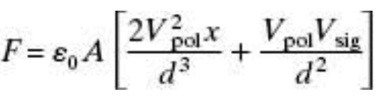

In the chapter of Borwick's book for Electrostatic (by Baxandall). In sections 3.2.2 and 3.2.3. He derived the force on the membrane (for Constant Charge), Eq. 3.12., does this Force formula already include/accounted for the mechanical damping in your post #237 above?
Force and damping are 2 different things. The Force is as Baxandall & bolstert's eqns. This pushes on the load which includes the air, diaphragm, damping etc.

The 2nd term in the Force formula has the transduction coefficient ∝ built into it. Damping isn’t part of the force equation; rather it results from the electrical and mechanical domains communicating with each other thru the transducer motor. An applied voltage results in force on the diaphragm which in turn results in the diaphragm attaining a velocity which produces a motional current. If there is some resistance included in the electrical circuit, the voltage drop across the resistance due to this current counteracts some of the applied voltage resulting in reduction of the force and velocity (ie damping).
Understood. The Equations attached are the 'applied' force on the diaphragm, which usually goes to the left side of the equation of Newt' 2nd Law, the right side is the .... = ma+(-k)x+[electrical damping as a function of the Velocity(Imot)]+(acoustical damping as a function of Velocity). Sorry, I've completely forgotten this. Of course, like you've mentioned, it's much clearer and more elegant to use electrical circuit analogy to have to understand the functioning of this interplay. Thank you again Bolserst.

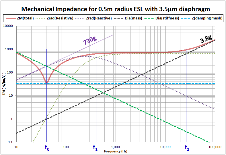

Here is an example of relative contributions to the mechanical load the driving force “sees” for a 0.5m radius ESL with 3.5μm diaphragm.
Mechanical impedance is Force/Velocity, analogous to electrical impedance which is Volts/Current.
You can see the total mass of the diaphragm is 3.8g and the mass component of the radiation impedance at low frequencies is 730g.
Over the vast majority of the audio frequency range, the radiation impedance is by far the dominate mechanical impedance or load.
Three frequency breakpoints(f0, f1, f2) have been identified on the plot:
  • Below f0 the diaphragm stiffness dominates
  • At f0 impedance is defined by damping mesh resistance chosen for desire Q at resonance
  • Between f0 and f1, the mass component of radiation impedance dominates
  • Between f1 and f2, the resistive component of radiation impedance dominates
  • Above f2, the mass of the diaphragm dominates
Regarding linearity:
- Diaphragm mass is constant (ie linear)
- Radiation impedance results from compression and movement of the air - linear at the SPLs involved
- Diaphragm stiffness - linearity can be an issue if not properly tensioned
- Damping mesh - linearity can be an issue if damping material of unknown acoustic properties is used

This is an excellent summary, with some real life values. I've always been curious if Fs, which is f0, is close to or equal to f1, which is ka~1
In general, no. Extremely high tension would have to be used for fo to approach f1. If an ESL was designed in that manner, no damping mesh would be needed since the radiation resistance is large enough near ka=1 to provide damping for the fundamental diaphragm resonance.

Would it correct to say that Planar Magnetic have this similar Zm, except the mass-controlled starts at lower f, ie, f2 is lower?

Are you using "linearity" to describe the traces or the linearity of that factor when the membrane is playing music?
As you posted, across a broad range of frequencies, the motor is playing against pretty linear factors in getting the motion of diaphragm into the air. Especially as you say, the radiation resistance is not a bad match for the weight of the membrane. Which is the magic of ESLs. Which also gives ESLs a definitive edge over all membrane drivers that have "heavy" traces glued to the membrane.

To be clear:
fo is the resonant frequency of the membrane, with the resonance due to the combination of the air mass and membrane tension (mass + spring) - usually in less than 100 Hz, but depends on membrane tension and panel dimensions.
f1 is the frequency where the resistive part of the radiation impedance exceeds that due to the air mass - determined by panel dimensions only. Usually greater than 100 Hz (215 Hz on my panels).
f2 is the frequency where the impedance due to the the mass of the membrane exceeds the radiation resistance. This frequency can be estimated as 96 kHz divided by membrane thickness (including coating) in microns - for 3 um membrane with a 2um coating, the cutoff is about 20 kHz.
So the vast majority of ESL operation happens between f1 and f2 (say, 200 Hz to 20 kHz) where the system impedance is dominated by radiation resistance, and the membrane is heavily damped.

bolserst, this is the best accurate description of ESL operating modes I've ever seen. And thanks golfnut for your explanations for us unwashed masses. I grovel at your respective feet in awe :eek:
