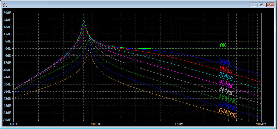

... what is the details cause of this ESL motional emf?

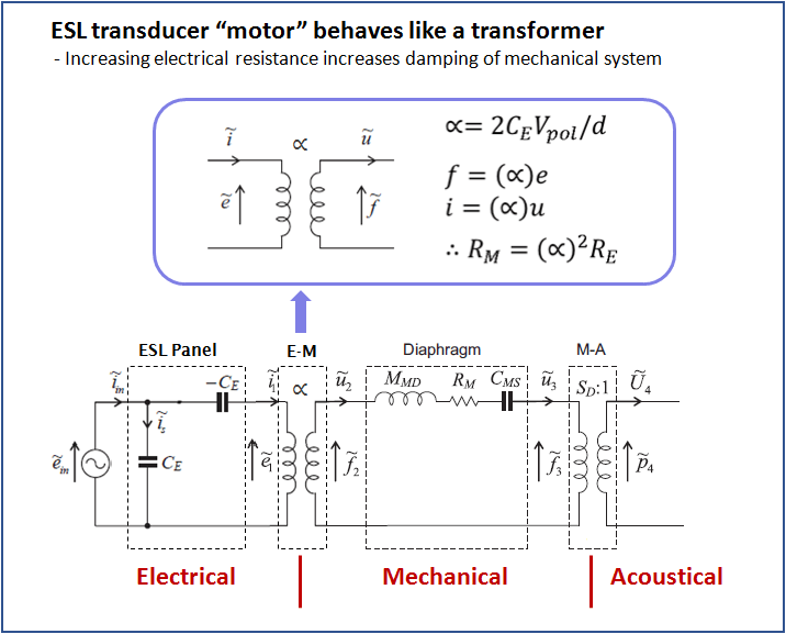

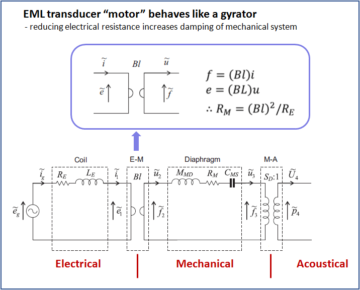

ESLs don't produce motional EMF like EMLs. Rather, they produce a motional current proportional to the diaphragm velocity. The simple way to think about it for constant charge ESLs, is that the total charge stored in the two diaphragm-to-stator capacitors is constant. The ratio of the charge stored in these capacitors is inversely proportional to distance between the diaphragm and corresponding stator. So as the diaphragm is moved back and forth, charge is shuttled from one stator to the other thru the transformer secondary or other conductive path. The rate of change of charge is current. The rate of change of position is velocity. So the motional current is proportional to the diaphragm velocity.
Comparing transduction coefficients, BL = 10 is pretty typical for an EML, and ∝ = 0.002 for an ESL.
The other difference is that the EML motor behaves like a gyrator and an ESL motor like a transformer.

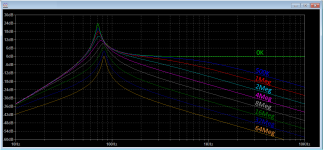

One consequence of this difference is that adding resistance in the electrical domain has opposite effects in the mechanical domain. For EMLs, minimizing electrical resistance provides the most damping of the mechanical system. For ESLs, resistance must be added to the electric circuit to damp the mechanical system. As mentioned previously, it isn’t very effective. As an example, here is a trend for an 400pF ESL panel with increasing resistance added in the electric circuit.
Even with 1Meg of resistance very little increase in damping is seen, and the power response is rolling off at high frequencies due to the first order LP filter formed between the series resistance and the panel capacitance. Note that as you continue to increase resistance the Q actually starts to go back up and the resonance increases to the unpolarized resonance frequency. This is because the resistance is >> impedance of the panel capacitance so you are in effect driving the panel with a current source. The negative compliance -Ce is then cancelled out by the panel capacitance Ce as explained in the Baxandall ESL chapter. It is all rather academic since so much sensitivity is lost with high series resistance that it isn’t practical anyways. If interested, experimental results for this behavior were posted here:
View attachment 1030465 View attachment 1030466
https://www.diyaudio.com/community/threads/current-vs-voltage-drive-esl.175918/post-2366501
Wow... that's a lot of audio power being reduced by having electrical resistance at the ESL panel, and the damping is not improved by that much.
