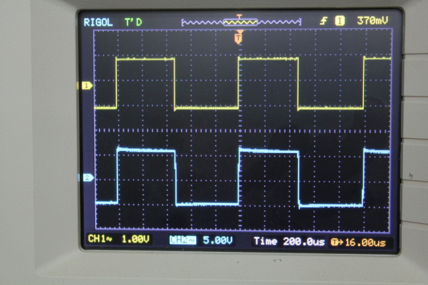

Hello Ian,
I have finished my Baby Huey and use it every day since one month As you can see on the photo I use a small switching power supply for the heaters.
I wanted to built it in a steel Hammond chassis but I break the drill-saw (don't know the exact name in English) and I have to find a better metal worker than me.
I made some photos of square wave signal but I have no audio analyser and I cannot measure distortion or other data!
Now I will try to make a power supply module based on Norman Koren design to use with a quad EL84 version of the Baby Huey with an auto bias to avoid too much trimming... Here is my preliminary schematic and PCB, but it is not sure that I will build all on one board, may be I will make a board for auto bias only and another for the power supply?
If you have any suggestion, I will appreciate your feedback.

Looking Good.
I had a quick look at schematics and did'nt see any obvious errors.
For those of you looking at the schematics - The Norman Koren bias servo method is to run one tube, normal, fixed bias as a Master. It's cathode voltage (across the cathode current sense resistor) is filtered by 33K and 10uF which is then used as a reference for 3 slave servos, one for each of the other output tubes.
