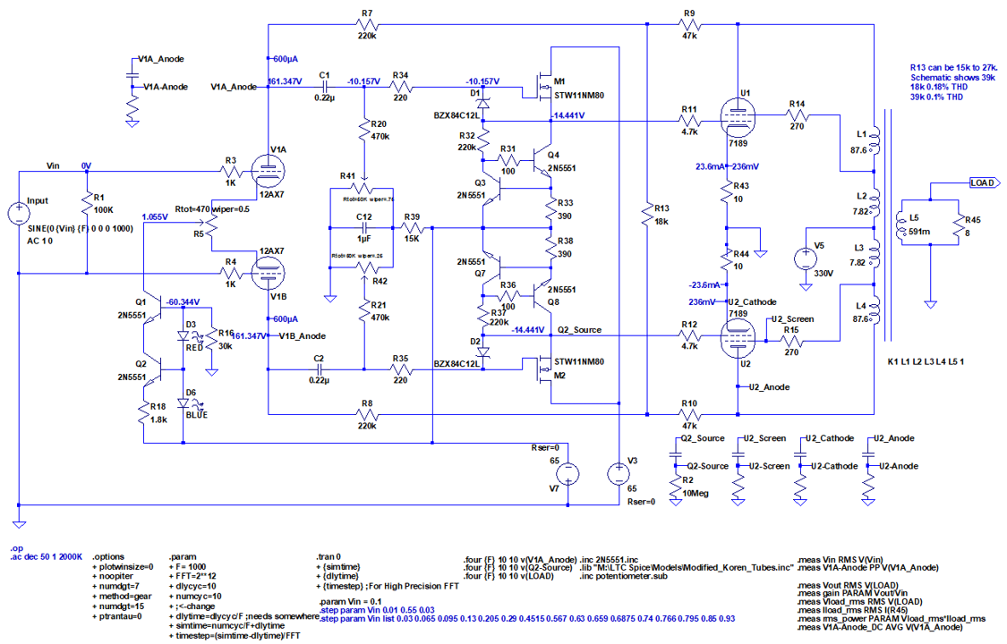

By simply substituing the 12AX7 with a 12AT7, the results at 13 Wrms are:
That's a pretty handy result, especially in the face of no further optimisation. I'm expecting that the CCS should be rigged for more like 3ma per side and that the 220k should be reduced, but I'm no expert.
I wonder how much of that reduced distortion is just down to the output stage (and transformer) not being driven quite so hard. ie if both examples were driven so that the output is 15W, would the 12AX7 distortion come down.
BTW. It looks like your global feedback is through 220k, which is a lot larger than the reference circuit. Is this the circuit you simulated?
[Edit] Never mind, I see that the the leg to ground is increased too.
I should just try to replicate your sim setup and stop asking questions :)
I would scale the whole 220k+47k based on the ratio of 12ax7 and 12at7's rp, in order to keep the rp vs Rl ratio constant.
I can simulate it, just a matter of reducing the signal at the input of my version. Just note that my version has 23% UL andnot 43% like suggested here.
just keep the ratio the same, or eliminate it and: increase R16 to reduce EL84's distortion and rp, increase the resistance on the cathode of each side of the PI to increase local feedback for the PI.
I appreciate your questions, many others can partecipate and share their experience.
Here it is my version of the BH EL84 with 330 V B+ and the following results (simulated) at 22 Wrms:

What is the correct value for R39 for EL84 ? The Dec 2018 BOM shows 33K for EL84 and 15K for EL34. Some later BOM's only show 15K.
There is no correct value, it depends on the voltage at which you supply the board with bias.
If it matters, the transformer that will be used for the bias is an AN-0130, 10VA 30V, with both 30V secondaries in series for 60V.
So you'll have around +-40 Vdc. I'ts fine for EL84.
A question for those with greater knowledge. If I were to use the BH PSU board, the bias and driver voltages differ from the EL84 schematic. The psu board sets bias at -100V and the driver voltage at +15V. Is this OK for the EL84 version of the design or are those voltages specific to the EL34 and it would be better to use the onboard option to set the bias at -65V and the driver at +65V ?
Suggested values are three times the bias voltage on the negative side. I've set them at +-35 Vdc.
Thanks zintolo. Is that with the 33K or 15K?
That's the raw bias voltage.
R39 forms a voltage divider with the two bias pots in parallel, so 25k.
Consider to have 1,5 times the needed biasing voltage as the lowest possible voltage for pot, so 18V approxiamtely, that is 45% of the raw bias voltage, so the needed resistance in series with 25k would need to be 27k. That's the value for R39. 33k would fit too, 39k is a bit tight.
