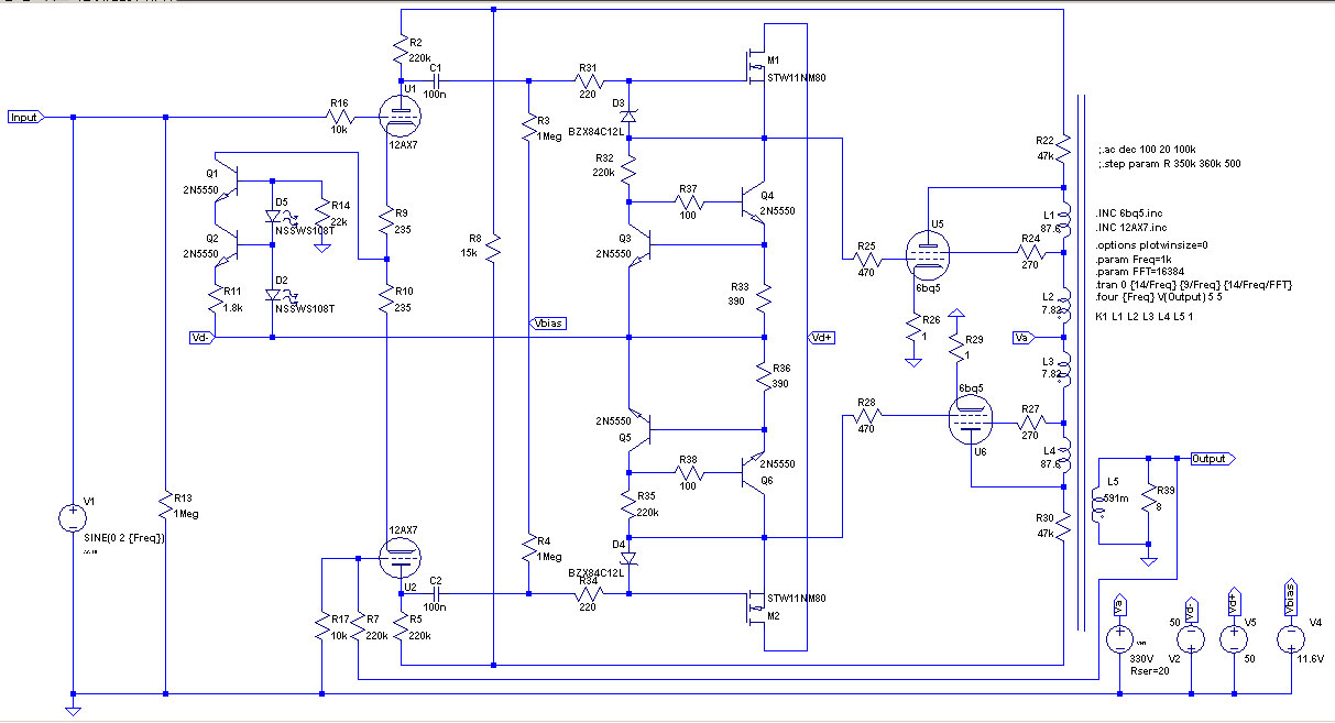

I won't be able to perform them during following evenings, just be patient but I'll work on them.Zintolo, thanks for the offer of simulation. If you have simulation results on reducing or removing the global feedback, I'm interested in that too. I'd trade THD for transient accuracy.
At what output you've got 7,5%THD? I will share it, but I've used just 23% UL in my amp(s).Would you be able to post your simulation please? I've attached mine but I don't believe the 7.5% THD figure.
You may find interesting two variations I've done:
Slowly building three Baby Huey EL84 - with notes
with a hybrid-cascode bottom-tubed PI version capable of 15 Wrms at 0,23% THD with a pair of EL84
improvements on 12AX7 12AT7 EL34 schematic?
with a hybrid-cascode top-tubed PI version and nested feedback capable of 52 Wrms at 0.56% THD with a pair of EL34
I'm not in a hurry. I plan I getting use to the sound of the current (new) setup. In a week or so I'll swap back to the 12AX7s and see how I feel about them then. It might turn out that I like those better after all.
That said, I will still be very interested to hear what your simulations show. And thanks again.

When you get to it, I will look forward to your simulation results with a 12AT7 front tube in the “standard BH” circuit. I expect the operating condition will need to be adjusted significantly; for example the current through the 12AT7 triodes will likely need to be increased well beyond the ~1 ma for the 12AX7.
Gingertube wrote that his personal favorite Baby Huey implementation was the 6SL7/6V6. So, I expect the 12AT7 gain (mu=60 for 12AT7, vs 70 for 6SL7) will be sufficient for EL84 output tubes.

Here it is my version of the BH EL84 with 330 V B+ and the following results (simulated) at 22 Wrms:
Code:
Harmonic Frequency Fourier Normalized Phase Normalized
Number [Hz] Component Component [degree] Phase [deg]
1 1.000e+03 1.891e+01 1.000e+00 -0.42° 0.00°
2 2.000e+03 7.237e-03 3.827e-04 -86.55° -86.13°
3 3.000e+03 3.810e-01 2.015e-02 -0.91° -0.49°
4 4.000e+03 1.907e-03 1.008e-04 81.60° 82.02°
5 5.000e+03 1.790e-01 9.465e-03 -172.99° -172.57°
6 6.000e+03 1.233e-04 6.521e-06 -37.22° -36.80°
7 7.000e+03 7.179e-02 3.796e-03 -7.62° -7.20°
8 8.000e+03 3.655e-04 1.933e-05 65.19° 65.62°
9 9.000e+03 1.967e-02 1.040e-03 -14.47° -14.05°
Total Harmonic Distortion: 2.260755%(2.271256%)
By simply substituing the 12AX7 with a 12AT7, the results at 13 Wrms are:
Code:
1 1.000e+03 1.455e+01 1.000e+00 -0.26° 0.00°
2 2.000e+03 9.702e-03 6.669e-04 -86.40° -86.14°
3 3.000e+03 3.055e-02 2.100e-03 -36.86° -36.60°
4 4.000e+03 5.565e-04 3.825e-05 64.48° 64.74°
5 5.000e+03 2.035e-02 1.399e-03 -49.30° -49.05°
6 6.000e+03 4.552e-04 3.129e-05 72.21° 72.47°
7 7.000e+03 4.376e-02 3.008e-03 -15.31° -15.06°
8 8.000e+03 3.308e-04 2.274e-05 71.68° 71.94°
9 9.000e+03 3.604e-02 2.478e-03 -14.64° -14.38°
Total Harmonic Distortion: 0.469068%(0.559864%)
Remove the gnfb, set R16 to 37k and you'll get these results at 16 Wrms:
Code:
1 1.000e+03 1.611e+01 1.000e+00 -0.32° 0.00°
2 2.000e+03 1.422e-02 8.825e-04 -88.00° -87.69°
3 3.000e+03 3.073e-01 1.907e-02 -3.92° -3.61°
4 4.000e+03 4.221e-04 2.620e-05 -53.17° -52.85°
5 5.000e+03 2.951e-02 1.832e-03 -138.45° -138.14°
6 6.000e+03 5.616e-04 3.486e-05 76.99° 77.30°
7 7.000e+03 4.405e-02 2.734e-03 -20.45° -20.13°
8 8.000e+03 2.844e-04 1.765e-05 69.13° 69.44°
9 9.000e+03 3.993e-02 2.478e-03 -18.38° -18.06°
Total Harmonic Distortion: 1.953334%(1.984467%)
