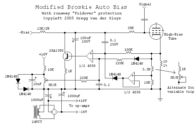

Actually I did experiment with some of the autobias circuits on the Tubecad web site a few years ago. Some were quite complex, that adjust the grid bias in response to changes in cathode current. They are pretty complicated and prone to oscillation and sudden death. Some of the simple circuits are basically CCS's in series with the cathode. These work, but you still dissipate the same power in the cathode circuit as a big resistor. The big resistor does work, but dissipates about 10 watts per tube.
For now I have put the regulator triodes aside, since I have thousands of tubes to play with. I have a large box full of 6AS7G, so I will experiment with these again at a later date.
Broskie did not patent anything. Regular perusers of his site will know this (look at the bottom of the page here ) 😉
Yes, it is uneccessarily complex, that's why I fixed it, along with the "bias runaway" problem:
