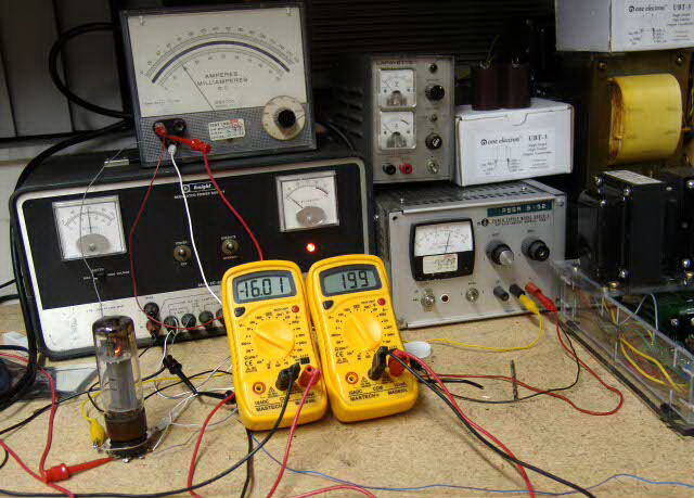

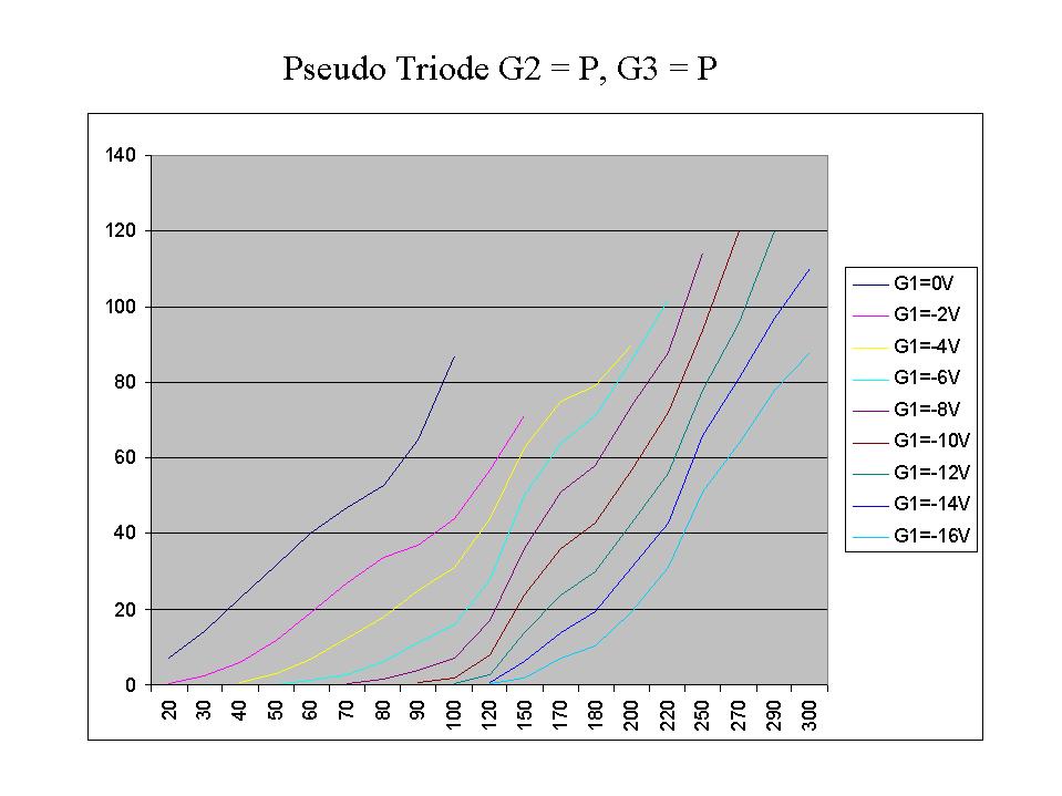

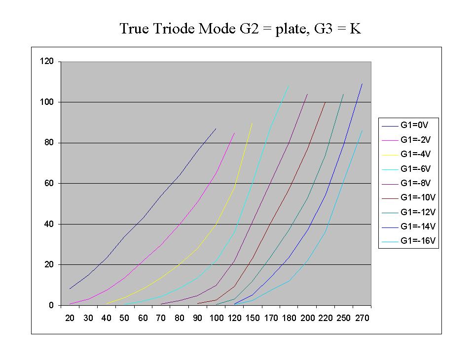

Here are the curves
Ok, I looked around and I have no EL-34's in the warehouse, so I "borrowed" one from one of my amps. It is a genuine Mullard (Scott branded) made in 1960. Because of the value of this tube I had to refrain from my usual "crank it till it glows' methodology.
I plotted both sets of curves with G2 tied to the plate through a 150 ohm resistor. The first set of curves has G3 tied to the cathode through a 150 ohm resistor. The second set of curves has G3 tied to the plate through a 150 ohm resistor. In both cases the "plate" current includes the G2 current, and in the second case it also includes the G3 current.
The results surprised me. I can only assume that the non-linearities that were encountered in the second plot are caused by secondary emission effects. This thread raised some (often emotional) debate over which should be the preferred connection. These plots should settle this issue. When I have some time I will repeat this test using an 807, which is a beam tube with a seperate G3 pin.

Hi Tubelab,
thank you very much for those interesting graphs! I would not have expected such a big difference, though. And I doubt a bit that it really is due to secondary emission effects because then any real triode would show those kinks in their plate curves, too, no?
Also, it would be most interesting to see what happens when g3 simply would be left disconnected.
