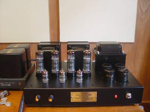

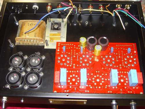

hey, I love the look of the amp, can you please post the schematic? because I think I am going to make an El34 PP design with PCBs, but I have no clue how to start making my own PCBs, not the manufacturing, I know loads about making the literal board, I just have no real clue how to start designing the board!
I think your amp looks amazing, and how much power do you get out of it?

I am so sorry ,it was not my product¡£I just want to give some ideas to DIYers . its out about 30w in each channel.
tubes amps were required linking the ground wires at one point.so it not easy to make the pcbs. i advise u to draw the Circuit diagram on protel first(or u can get the classical diagram surf the internet ),then protel will make up it into pcb automatically. then u can adjust it by your will.
Most of us around here don't have and can't afford a legitimate copy of Protel - last time I checked a full/legal copy was about $6K. As a former Protel user and a current MentorGraphics DesignView user I can say none of these pro applications are particularly easy to use and have a steep learning curve.
I can recommend ExpressPCB, however you will have to create the tube symbols for your schematics (they explain how) and the octal and miniature tube sockets required. Once the schematic is complete you generate a netlist, link it to your pcb layout and go from there. If you post your artwork I can critique it, PM me and I can provide some fairly lousy socket symbols for the pcb layout side of things.
Incidentally auto-routing analog circuitry is considered a no-no, although most tube circuits are so simple that it probably isn't that hard to get it right if you know the basic rules.
