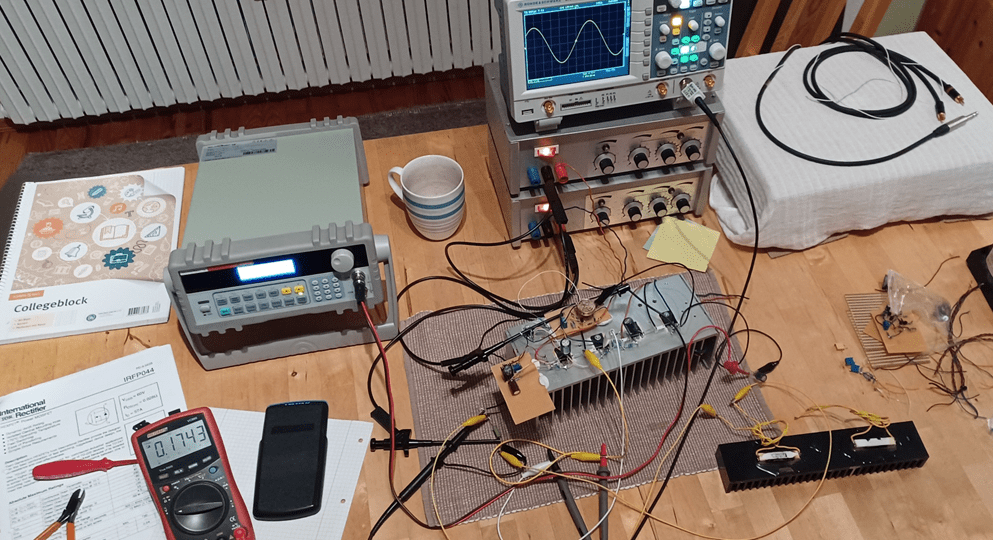

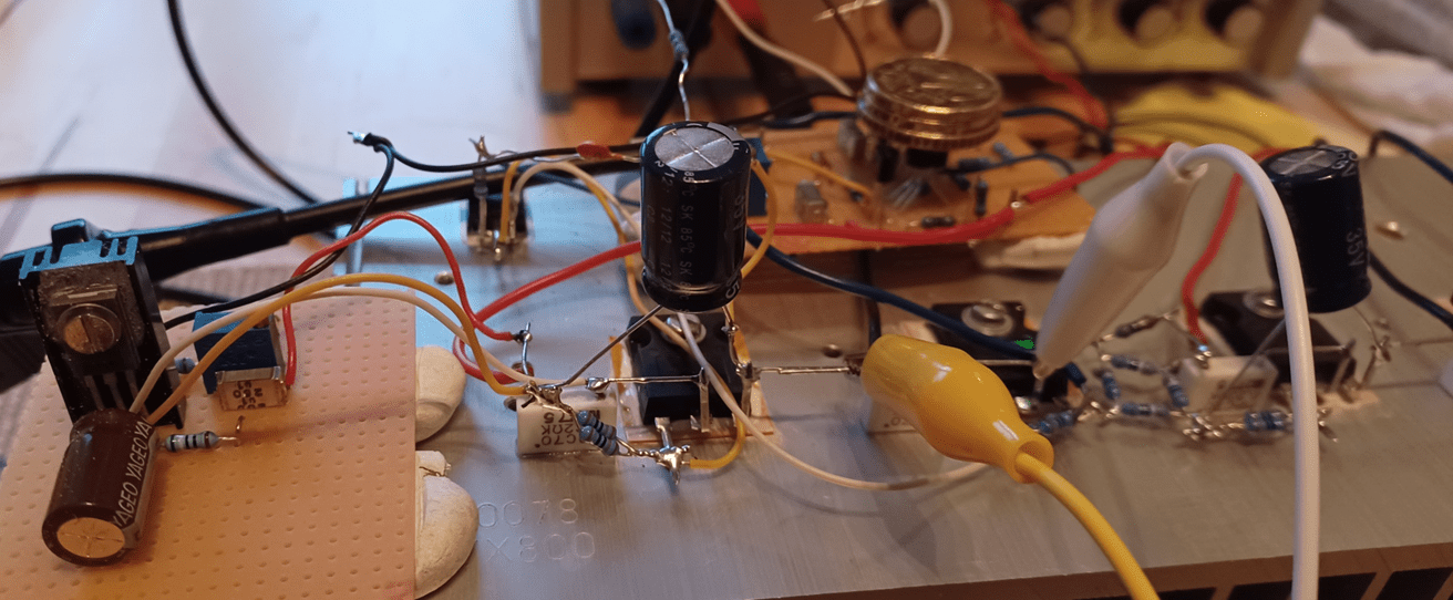

After approx. 3 hours, the test circuit has slowly found its thermal rest, it drifts into the desired 0.8A quiescent current during this time and remains there.
Everything in the open loop. Capacitive couplings lead to a nice 50Hz mains oscillation - so the amplifier works on both inputs.
But the output offset cannot be eliminated, it is 2.6Vdc. VGS_1 is about 100mVdc greater than VGS_2, VR7 is set exactly to 6.580Vdc with the trimmer.
Apparently it (seems to be) is advisable to select Q1 & Q2 100%. Automatic regulation does not improve this situation.
I am slowly leaning towards Cumbb's statement that a differential amplifier is superfluous, so a singleton is more suitable, but how should it balance Q1 & Q2?
Waiting several hours for the thermal runaway does not seem to me to be a good idea.
Oh, what a hardship ...

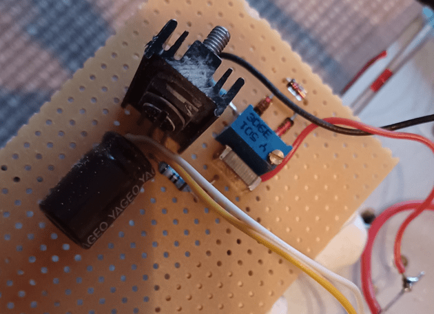

The quiescent current control with BD140, as mentioned in the article JLH1996, works - I have just tried it, but the DC offset is now even greater.

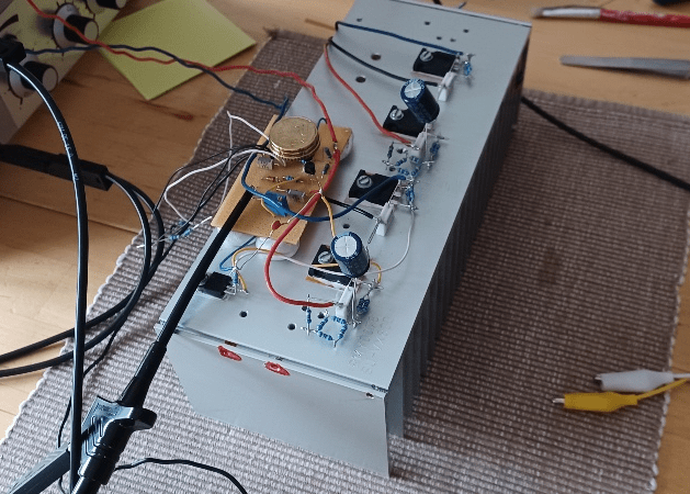

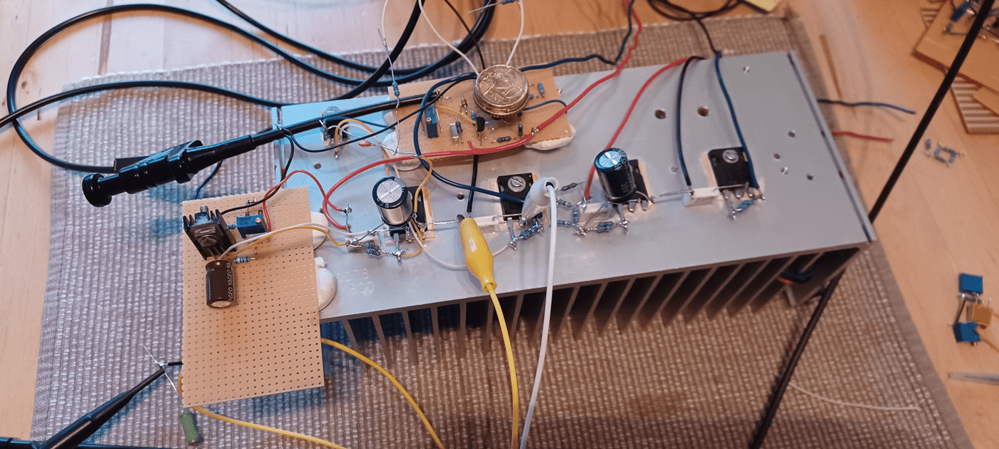

A little tweaking of the reference points and closing the loop (maximum negative feedback), now the entire amplifier works statically.
The
This is already quite positive and comes pretty close to the first idea of the Eisenport project. Apparently my thread is now mutating into a kind of soap opera - how are the ratings?
The
- control loops now seem to work correctly, even under the extreme thermal stress, 40W power loss generates a lot of heat
- offset is now only +11mV while the quiescent current of the control loop actually remains under control, +/-30mAdc around the set 0.8Adc target
- oscilloscope shows a straight horizontal line, no oscillation tendency below a gain of +1.

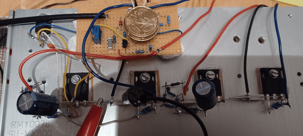

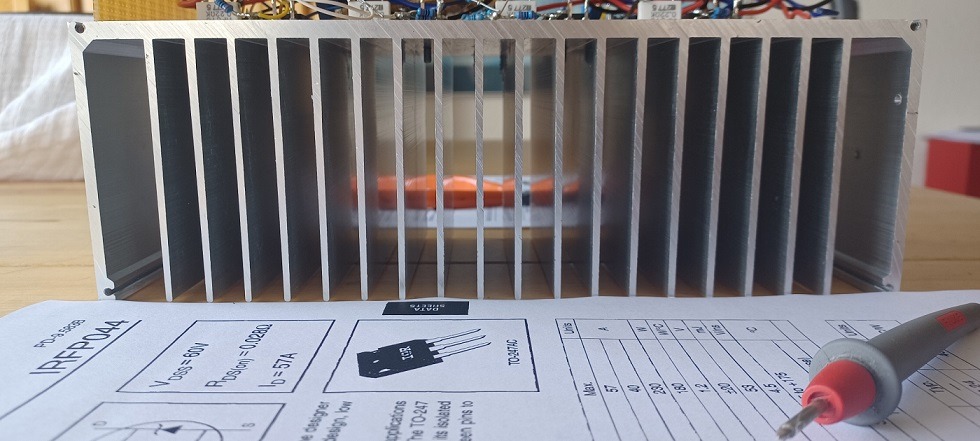

Now
The temperature,
I measure 38°C at the ribs and 48°C as a hotspot directly on the Q1 housing. With the surface area of my beloved test heat sink, I immediately have to think of the current MF-A1, with its tiny convection surface (the lid) and almost 80W power loss, thermal death is still programmed. Whether MF has finally installed a functional signal limiter (two green LEDs would be enough), or still lets the power amplifier drive RAIL to RAIL (until the second breakthrough) ...
does anyone know?

The late night news
Static:
absolutely stable, the new control loop works perfectly, no more fluctuations in the quiescent current - absolutely rock solid now!
Dynamically:
at idle and under load, everything is perfect. The bandwidth under 6 W(rms) modulation is still 900kHz without any frequency response compensation!

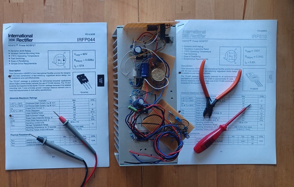

This is now the provisional end (of season one) of the daily soap opera Eisenport's first act. The set has been tidied up and the little amp has to go back to the prop room.
Normally, the production company now needs two to three years to give birth to a concrete, complete product. But "Haudegen is not on the run", and he may yet meet Dr. Kimble on his journey?!

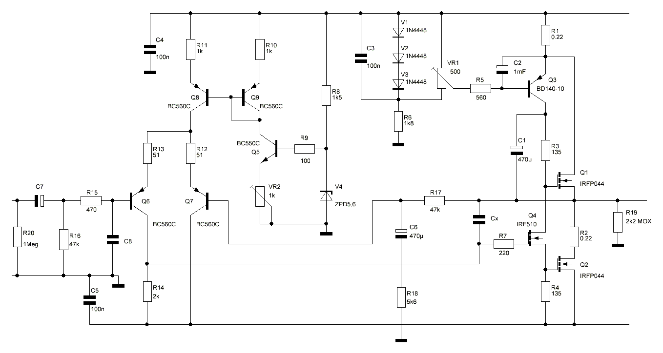

Here is the preliminary final and fully functional circuit that I have been working with over the last few days, building (and evaluating) it step by step.
Of course,
a few obligatory capacitors and a sensible band limitation on the input side are still missing - the balanced input is also not shown, but I leave all that to the reader's imagination.

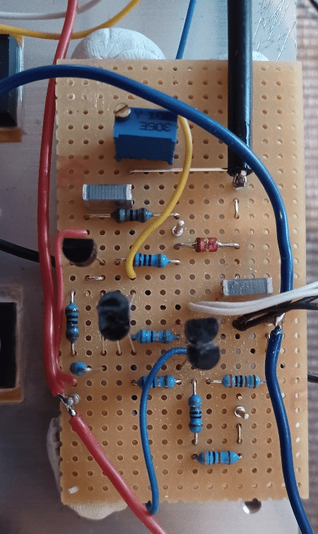

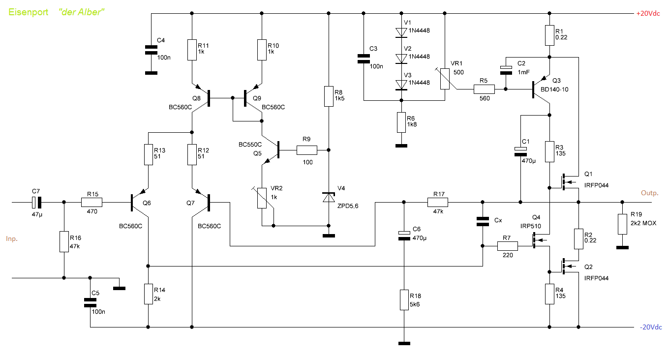

@cumbb
The first stage is now fully regulated, the offset is just under +11mVdc. Everything else resulted in the open loop case.
The amplifier is extremely fast,
so a band limiter and possibly a soft clipping limiter similar to the NAD devices are advisable.
Thanks again for reminding me about the trimmer in the emitter circuit, I had completely forgotten about this classic solution (how embarrassing).

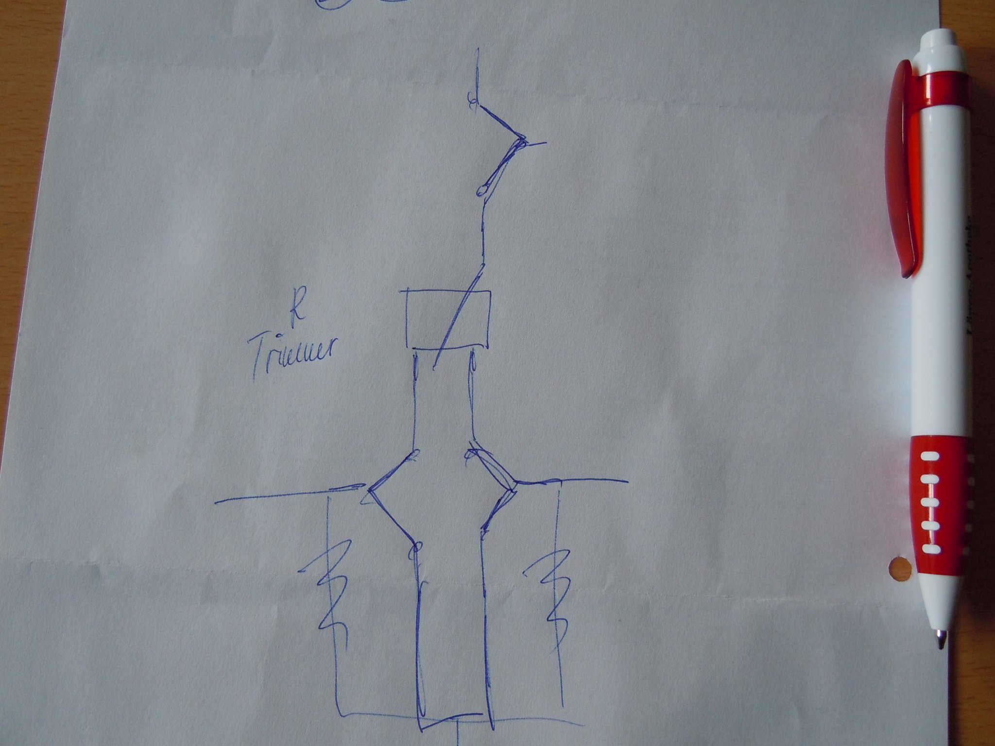

Nice circuit.
Sounds better than every complex PP, regardless of the price;-)
The BD441/442 are currently among the best-sounding TO-126s, more fluid and real than most others.
If there are TO-220s that can withstand the power, try them. I remember the IRF520N, for example. It sounded a class better than its competitors, and classes better than TO-247s.

The longer I look at the circuit structure, the more potential I recognize. In other words, yes, I fear that too .Nice circuit.
Sounds better than every complex PP, regardless of the price ;-)
We could still use R2 and R4 to establish an electronic fuse and current limiter. A switch-on delay, i.e. an output relay, would also not be a useless luxury.
