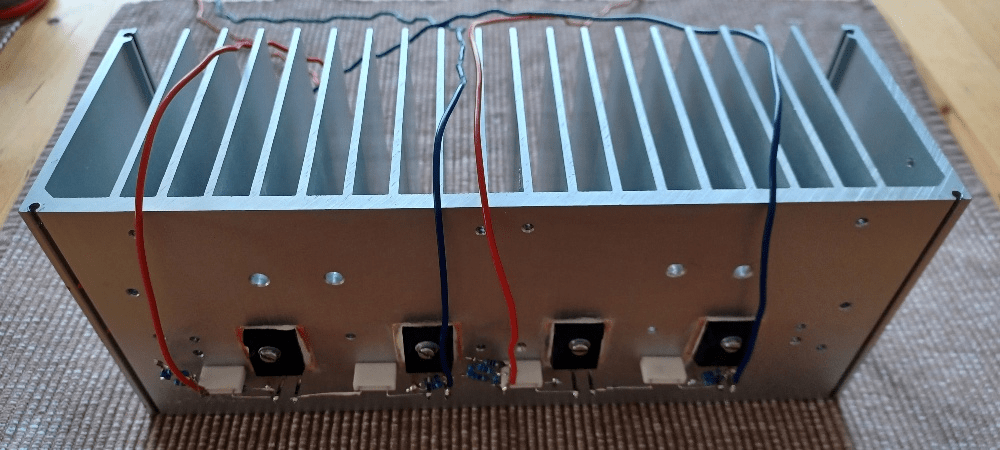

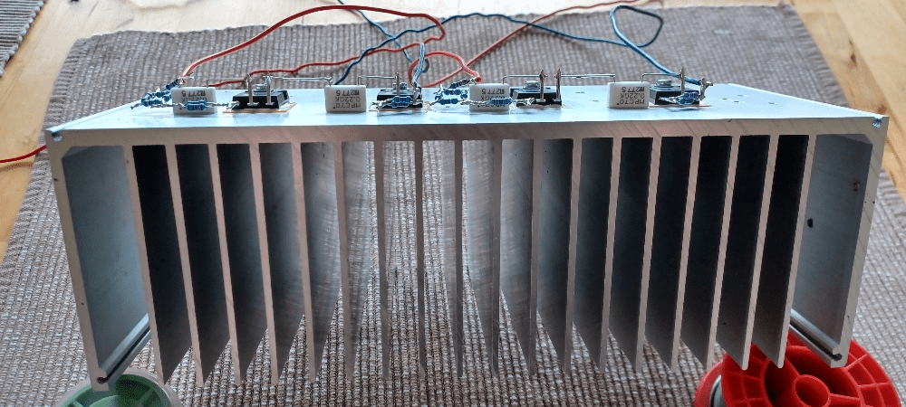

I'm attaching a picture of my usual test setups, I'll get started right away with this heatsink.

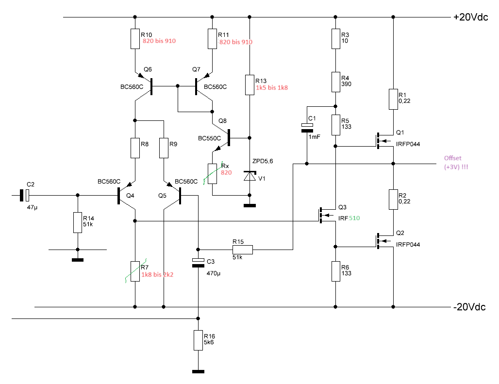

Something perhaps irrelevant to the final concept but struck me: what is the motivation for the LTP current source in amp 1? Or stated another way, is there a benefit to this arrangement vs a more conventional single transistor output current source? Given the shorting of LTP emitters, I see current source RO cut in half, but I have not analyzed in detail.
Ok, I neglected the halving of RE when you change from two to one transistors so the output impedances are the same at LF... But capacitances are doubled so by 20k the output impedance is halved with two transistors.
@dkfan9,
the simplest partial answer to your question is to reduce the power loss. But since the individual emitter resistor is now correspondingly larger, the individual source or sink is also closer to the ideal than with a low-impedance, very small resistor in the emitter circuit.
In the real experiment I did without this, and the current mirror is kept quite classic and very simple, but the small transistors now get very hot in their plastic housing and their power dissipation is already approaching the operating limits.
So everything revolves around the power dissipation of the components and the quality of the local control loop.

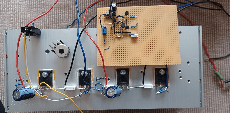

An interim result:
The last, concrete idea does not work statically within the limits predicted by the simulation. Quiescent currents up to just under 0.4A can be set well and stably with Rx, but then at some point things start to go wrong.
However, the single-stage variant with a voltage divider from the output to the input of the Q3 already works quite well, division 7k & 3k. A local current-voltage negative feedback is able to set the desired operating point within wide limits. The thermal drift is even acceptable with the current size of the heat sink.
UGS_044 currently <3.5V
UGS_510 currently <3.1V
Quiescent current approx. 0.8A
However, the output offset is <3V, there is still so much to do before such a construct really works.

Now some questions arise, do we need a gate series resistor in each case? Gate stopper. And if so, in what order of magnitude? Protection diodes, does the design require Z diodes? Above all, how do we ensure a DC-free output?
The power dissipation per channel is already just under 40W, i.e. the heat sink dimensions shown in the picture are just sufficient for one branch. To avoid a thermal disaster.
It may make sense to use smaller power transistors (TO-220) and reduce the power dissipation. The sound will still be cleaner, more contoured and clearer. It is due to the disregard of "current" in the construction of transistors.
By the way: The mechanical damping of the cooling fins will also be audible. It is also possible to influence the tonal tuning here.

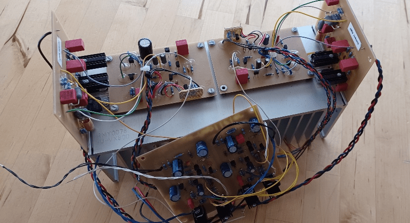

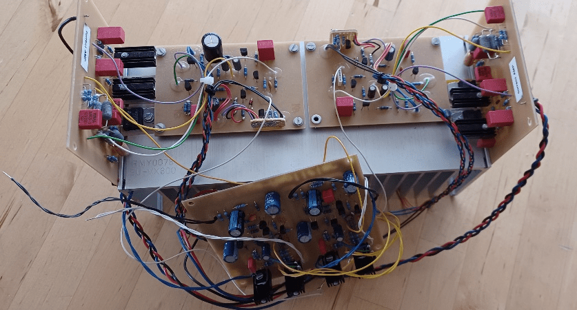

In the meantime, of course, I continue to work diligently on the small development, actually on the object.
Regardless of the second stage -
which is perfectly functional on its own, see also the PLH litter (but with at least three trimming potentiometers - that alone speaks for itself and the specimen scattering), with appropriate cooling. The Q3 in particular must remain cool in relation to its surroundings under all circumstances. It needs its own heat sink.
To ensure a DC-free output (and two-stage-amp /testing), I always couple the first stage with the second stage, with and without feedback.
Q6 gets really hot, which is not surprising given its power dissipation of >0.3W; it should be thermally coupled with Q5. In other words, physically lash it together. To be honest, 23mA is also a bit too much of a good thing. Either double R7 and halve the current, or split it up - so that Q6 remains cold under all circumstances.
But having the offset set automatically is not a good idea, because at some point the ensemble will tip over - guaranteed.
According to the motto "giving up is not an option", reflection is required.
First of all, the current mirror must work better and the power losses, i.e. the temperatures, must fall. Q6 and Q8 must be thermally coupled with each other and R7 can be (theoretically) up to 10kOhm as the R-Gate of Q3, it does not necessarily have to be low impedance. 2 times 3mA should fit much better and this inevitably results from RF||RN approx. 2kOhm, from the test of the output stage as a single stage alone.
