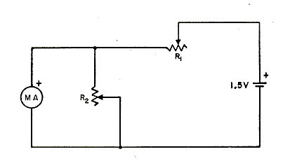

I got the new meter today and its perfect! Dated 1959 on the back! Before removing the old meter however I was able to adjust it, calibrate it and it is actually working quite well. I decided to put it on ebay. Though it is in only fair condition I think someone who needs one will be stoked to have it. It does work and the graphic I have reproduced is beautiful. I have described it pretty thoroughly. Check it out.
