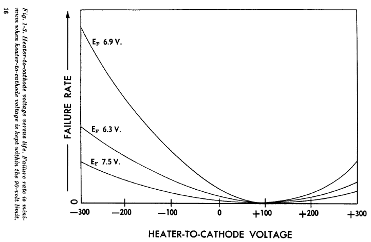

Sure.
1) Research and experiments conducted in the 50's led to this conclusion. Please read Robert B. Tomer's "Getting The Most Out Of Vacuum Tubes", a very interesting book.
2) See "Valve Amplifiers" by Morgan Jones, third edition, page 362.
QUOTE]
It's risky to interpret the plot shown without citing the actual reference. Tomer makes no reference in his book as to where the graph came from and under what conditions the results were obtained, or what valve or valves were tested. Actually Tomer makes no exact references at all that I recall in the body of the book!
Old Tomer knew his tubes...
A certain A.G.F. Dingwall also published its research on heaters in "Electron Tube Design" by RCA. It can be found online here: Full text of "Electron Tube Design"
Let's think about what happens between the filament and the cathode, when the latter is at a higher potential.
This is especially obvious for topologies where a cathode sits high above zero: cathode follower, SRPP, totem pole, cascode, Aikido.
Hot bodies emit electrons. The filament is red hot, as is its aluminium oxide insulation. They are enclosed by the cathode sleeve. The cathode being electrically positive, electrons are attracted to the cathode: this is the LEAKAGE CURRENT.
This leakage current is modulated by the filament PSU noise: 50Hz for AC, or 100Hz + a lot of higher harmonics for unregulated DC (just put a scope on it, you'll see). This is why you can actually hear differences between heater PSUs, I think.
After some time, a chemical migration takes place between the cathode and the filament. The insulation becomes polluted by metallic ions, and the leakage current increases: the tube becomes noisy!
When the filament is elevated at a higher potentian than the cathode, all this doesn't happen.

The direction of the leakage is important: if it goes from the cathode to filament, it's not a problem. The filament doesn't care, and neither do we!
Electrons are known to be attracted to positive potentials... so we can choose which way the leakage current flows!

I finished reading the paper. It analyzes insulation material performance and the factors that influence leakage current.
I repeat: I never said there is no leakage current. Of course there is!
I said the direction of the flow is important in audio, and with an elevated heater, we can keep the current flowing in only one direction. We can keep the noise out of the cathode. Is this clear or not?
The paper talks about a phenomenon I mentioned before: metal ion migration, which occurs with LARGE DC bias, as in cathode followers, SRPP, Aikido, etc.
Metal ions are positive, they go to the negative electrode; in time, they form paths which increase leakage.
Again, the direction is important: if the cathode is negative, the metal ions from the heater will go into the nickel cathode sleeve - that is not a problem!
If the ion migration is into the aluminim oxide insulation, well, it won't insulate very good any more, will it!
This paper was written in 1936. Tome's book was published in 1960, at the end of the tube golden era, after many more years of research.
My conclusion is: a small positive bias on the heater (25-50v, no more) is beneficial for both noise and logevity.
