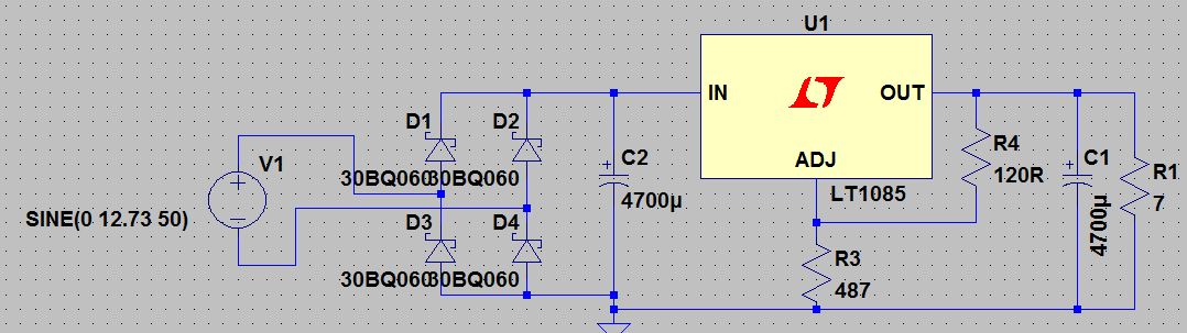

I am comparing the effects of having a regulated DC filament supply for my DIY preamp, loosely based on C22.
There are 5 tubes in this pre-amp. Three for audio and two for power supply.
As I have 9Vac and 6Vac outputs from my transformer, I used the 9Vac supply for 3 ECC83s for audio and the 6Vac for two tubes in power supply. The schematic is attached.
The 7ohm is to represent a load of 0.9A for three filaments connected in parallel. I am using 6.3V filament supply and each filament current should be 300mA.

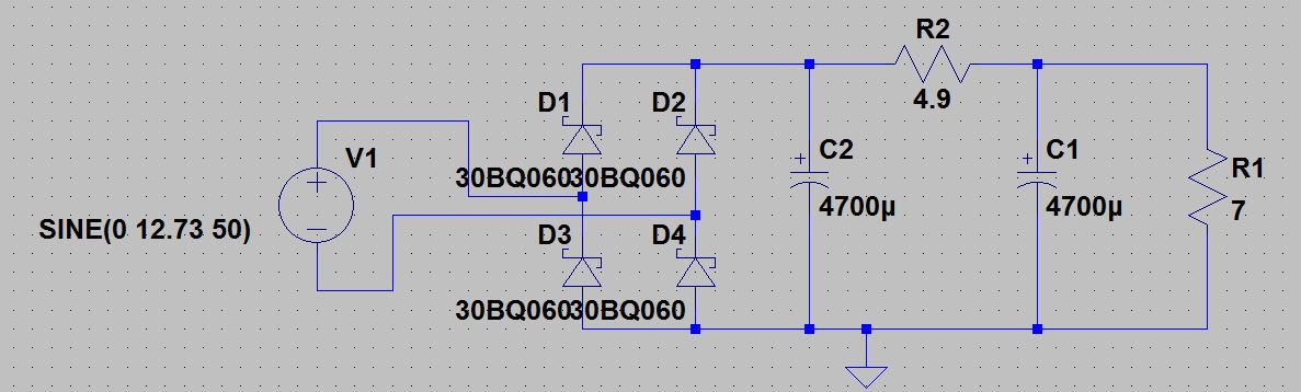

I like the effect from converting the filament supply from AC to DC. So thought I could improve by having the supply regulated for the 3 Audio ECC83. The schematic is also attached. I am using a ST LM317 instead of the LT1085.

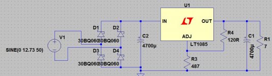

The results of regulation using the ST LM317, to my surprise, is terrible! No life in the music any all. Very unmusical! Flat and mechanical sound.
Does any one have experience with DC filament supply to share?
If I can change the voltage regulator to LT1085, would it be better?
Or is there any topology of DC filament regulation that would yield good sound?
Please help.

I think you are hearing things. I just can't see how a heater can impact sound quality based on type of regulation, provided you have the correct voltage applied to the tubes.
Heaters bring the tube up to operational temperature, that is it. Using DC to drive the heaters only serves to cut potential hum.
For that matter, regulation will not buy you much with a constant load, which the heaters represent, except smaller capacitors and better efficiency of the power supply.
If you really feel that the sound quality has changed, I would check the voltage to the heaters to make sure it is with specifications.
Stupid question : Have you measured true DC voltage with the simple CRC circuit and with the LM317 ? Maybe LM317 is not feeding a 6,3V supply to heaters
Yes, I have measured the voltage from the regulator.
I first played with 6.3Vdc
Then 6Vdc for a for a while.
They have the same characteristics. However, with 6Vdc, the sound is a bit dull compared to 6.3Vdc.

It sounds like there is something very wrong with the actual DC output. A flat 6.3 volt DC filament supply to a 12AX7 will always give better results in terms of hum etc. then a AC supply. But even the difference between AC and DC shouldn't be that audible with these kind of indirectly heated tubes.
First thing I notice is the LM317 schematic. For max performance, both the LM317's in- and ouput should be bypassed with a small value foil cap (MKP, MKS, whatever) for shunting high frequency content. Datasheet states 100n@input and 1u@output.
- Have you measured the output voltage loaded or unloaded?
- Did you check the output with an oscilloscoop to check if it's flat?
- Did your new supply maybe cause noise in ground or a groundloop?
- Is the transformer up to the task?
First thing I notice is the LM317 schematic. Both the LM317's in- and ouput should be bypassed with a small value foil cap (MKP, MKS, whatever) for shunting high frequency content. Datasheet states 100n@input and 1u@output.
I will try with bypassing.
and check voltage on the scope.
The 9Vac transformer is rated for 2A. I am drawing 0.9A. It worked with unregulated..
I think it should be up to the task.
Anyway
The 0.1uF cap at the input - "*Needed if device is more than 6 inches from filter capacitors."
The 1uF at the output - "†Optional—improves transient response."
I will try.....
Please help.
This has been discussed a lot in other threads. Probably not such a popular topic now, early AudioAsylum has lots of posts and before that the Joe List (if you can find any traces of it online now) It was regarded by many as common knowledge that voltage regulation sounded poor and current regulation was better - on DHT's as well as IDHTs. Some insist that AC is the only way to fly. The fact is that everybody has different ears and if you hear a difference you shouldn't give in to an engineer's prompt that there's nothing there to hear.
I ran Voltage regulated IDHT's something like ten years ago and thought they sucked as well, but the while the overall world of sound is vast and multifaceted, we are usually seeking improvements in a specific way. I might come back to Vregs in a different context some day and think they are a boon to all human kind.
I've seen a good number of audio ee's over the years who gave somebody a hard time for thinking they could hear a difference from a given circuit component only to come back a year or two later advocating the same component for the same reason. Some are honest about it and some very often don't seem to remember that they thought differently once upon a time. I'd say trust your ears , but keep open to noticing your own biases.
If the DC/AC heater exploration is new to you you should probably cast your net a little wider at first anyway. I would probably try the LT108_ as current regulator. For more info there is probably still reference to Tom Ronan's Ronan reg online somewhere - essentially an LT108_ as Vreg followed by another as Current reg. You can just use the LT108_ current regulator by itself if you like. You might try a separate reg for each tube. There should be lot's of references and a few people promoting their own designs online. Rod Coleman's is good for DHT's, maybe he has something for IDHT's . I dunno. Experiment !
