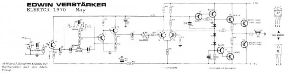

Edwin 20 watt (Elektor 1970 - May)

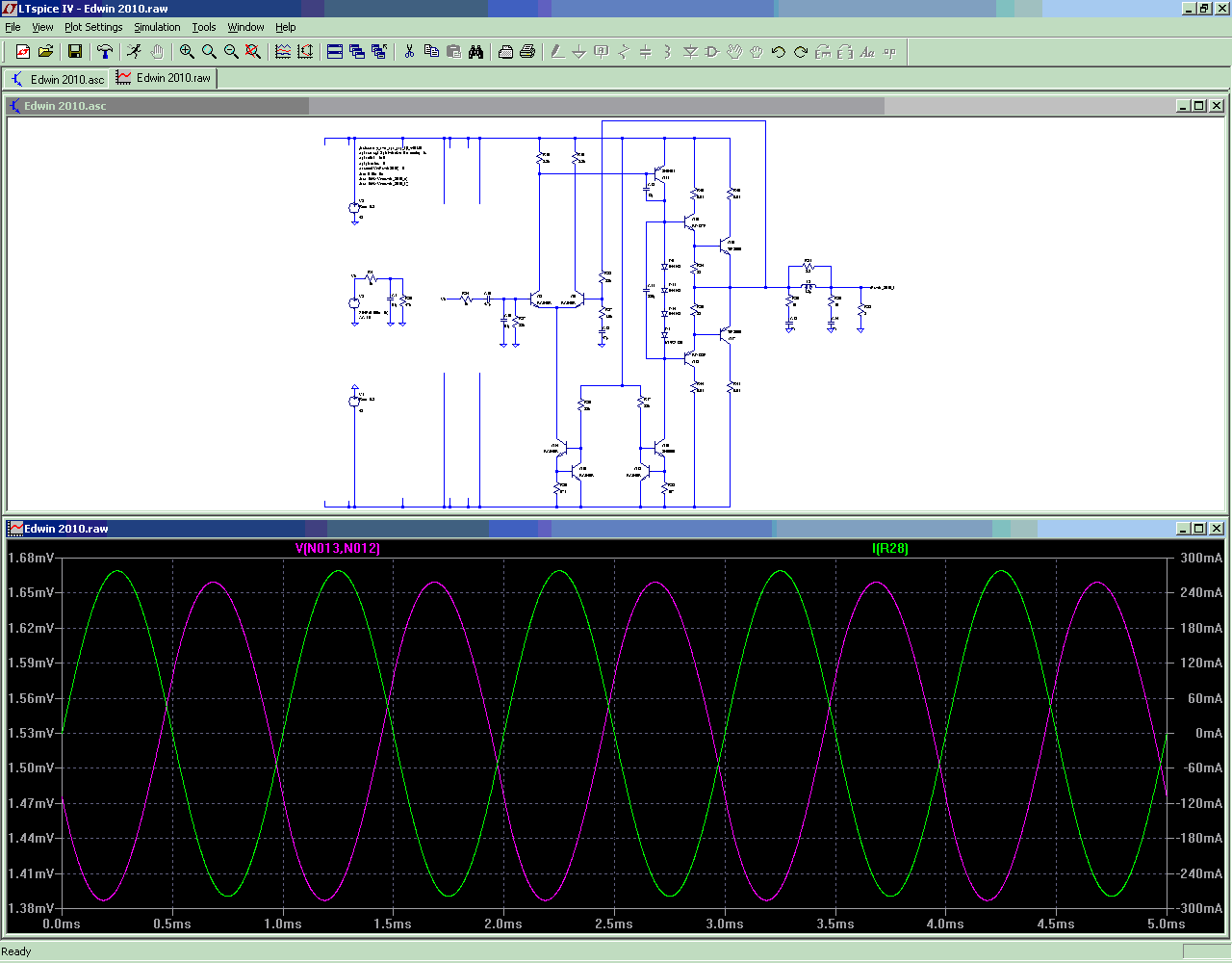

Hello, it is not a flaw, it is a feature ! By the way, I am now including the test you've done (voltage on the diff amp), as routine health check. Thanks ! I agree with you that if music is supposed to be delivered by such an amplifier, the tiny variations around the zero may be ignored, masked, erased while the amp is so heavily busy, eliminating the crossover distorsion. Kind of window opening and closing at each crossing. One may learn something, listening to such "flawed" amp ... Don't you think ?
Even tiny amounts of this kind of distortion is definitely unpleasant.
Note that the amplitude of the residue is 1/20th of its actual value at the output.
Adding a fourth diode in the string (MURS120) brings the Iq to ~25mA, and the residue looks like this:
What remains is a pure signal, resulting from the finite OL gain of the amplifier

i think this was the equa amp.......(i am not shure)
(could be published in elektor dezember 1972)
Yes that's it. I etched and built mine on the PCB design Elektor published around 1975 or 1976. I sprayed the PCB black. But, my skills were not too good in those days and the thing hummed like hell.
About 2 or 3 years later I built an ETI amp and replaced the TIP output devices with MJ802 and MJ14 (? can not remember). I had that amp right up until about 2003 - I got the wiring right in that one - it was really quiet.
Thanks for posting BTW - appreciate it.

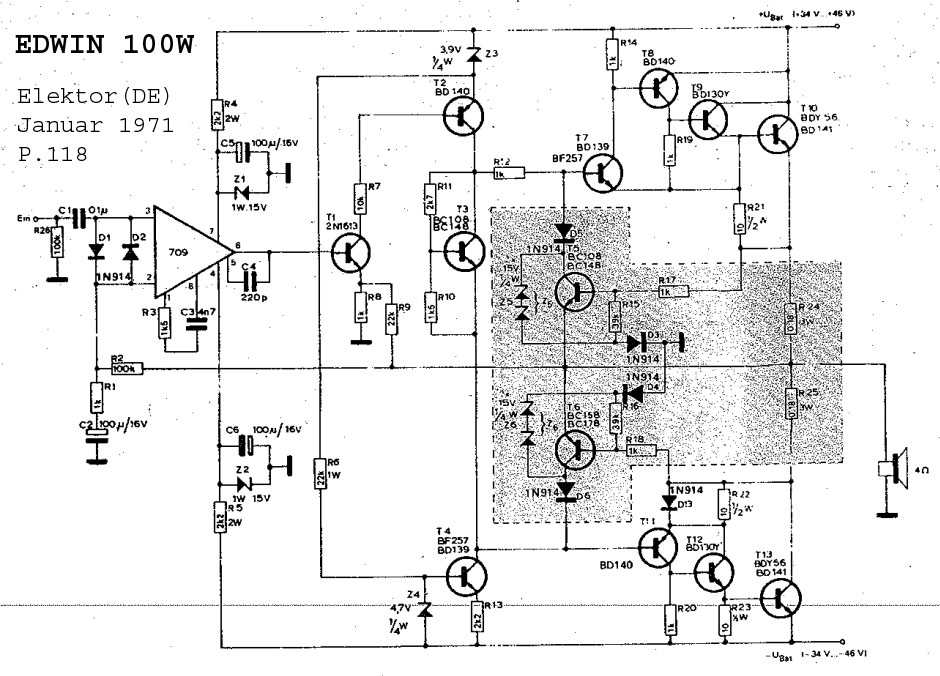

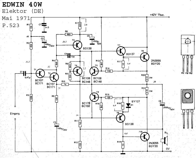

hello,
attached you will find genuine info about the early Edwin implementations in Elektor DE (german edition) :
- 20 Watt in May 1970, with the addendum published in Sept Oct 1970
- 100 Watt in January 1971
- 40 Watt in Mai 1971
My preference goes to the 20 Watt and the 100 Watt versions. If you own one, please keep it ! The 40 watt schematic lacks spirit. Personal opinion.
